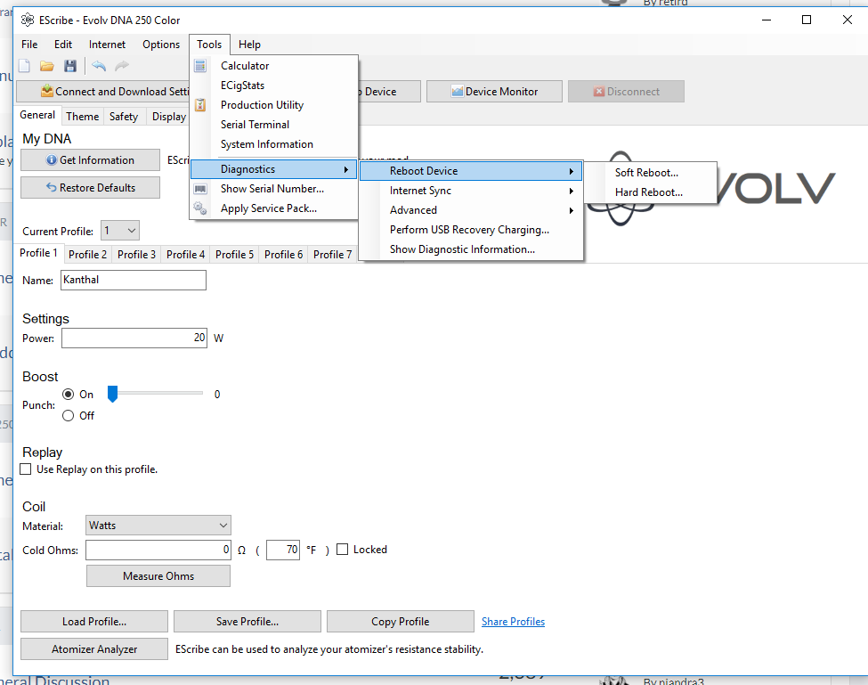

retird Posted May 25, 2018 Report Posted May 25, 2018 Will the device connect to EScribe? If so, and you want to do a soft or hard reboot of the device go to Tools/Diagnostic/Reboot Device/Select Soft or Hard....
