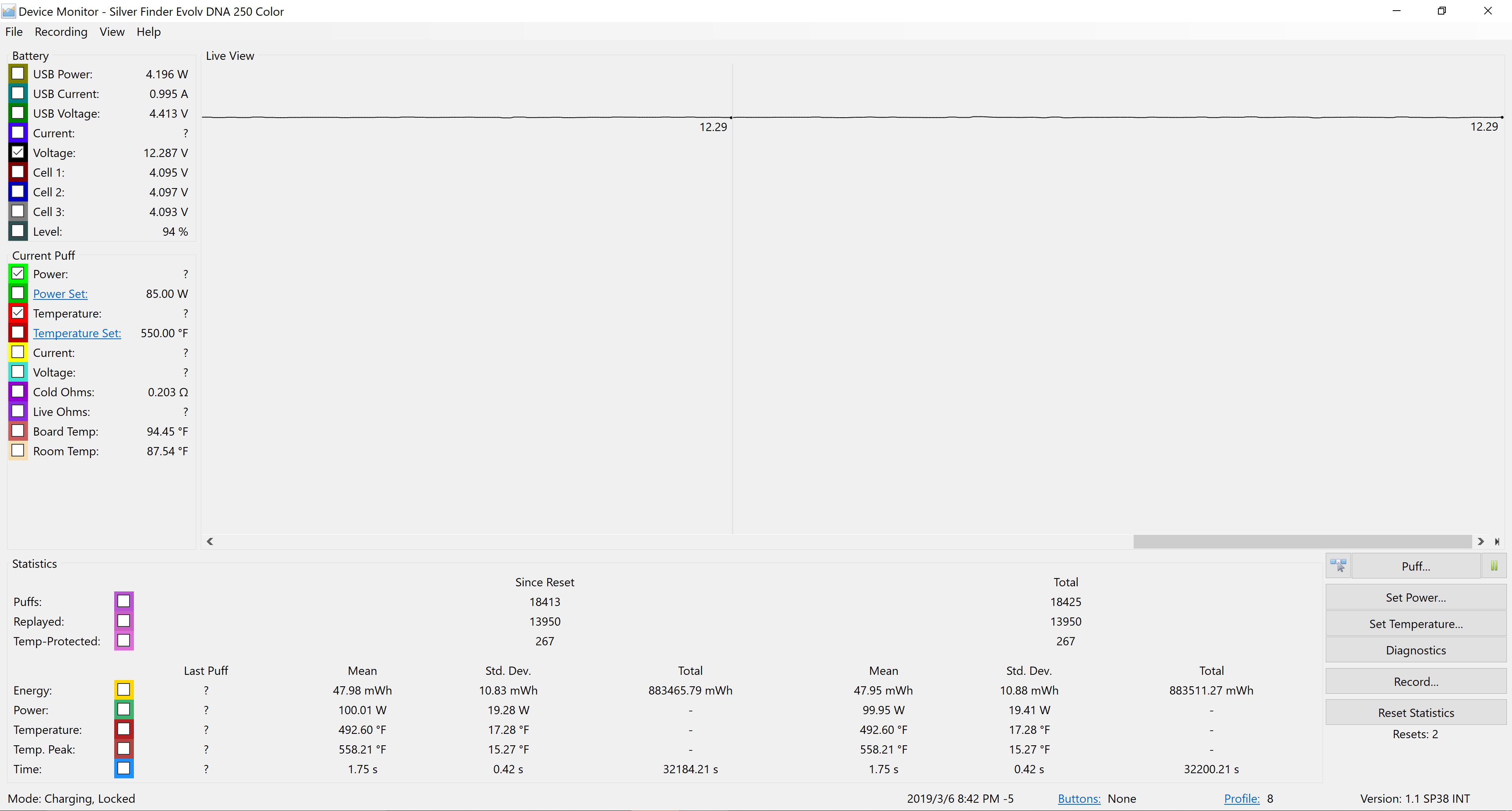

retird Posted March 6, 2019 Report Posted March 6, 2019 Can you guys post a screenshot of Device Monitor with batteries just being installed.... ...

Augmentin Posted March 6, 2019 Report Posted March 6, 2019 3 hours ago, retird said: Can you guys post a screenshot of Device Monitor with batteries just being installed.... ... Hi here is info on batteries, the problem as I written above, happens only with batteries that are fully or almost fully charged. Thanks for any help.
Ghoulsfrank Posted March 6, 2019 Report Posted March 6, 2019 I'm gonna post my screenshot tonight with full batteries. As @Augmentin just said, I have tried to replicate the issue with batteries that are almost dead and it turn on perfectly. Weird
Augmentin Posted March 6, 2019 Report Posted March 6, 2019 Ghoulsfrank ... I now putt full batteries in and with cover open, pressing fire button and putting one battery in and out , and it started within 3rd to 6th try. So I guess this will work for me, cause' I don't want to send mod back to China Thanks everybody, if something new comes up about this problem ( service pack or something ) please write to me.
Ghoulsfrank Posted March 7, 2019 Report Posted March 7, 2019 There we go. At 4.09 volts for each battery, i removed my battery then put them back and i wasn't able to turn on the device. Plug it in my PC to take the screenshot and it turn on as soon as i plugged it in
