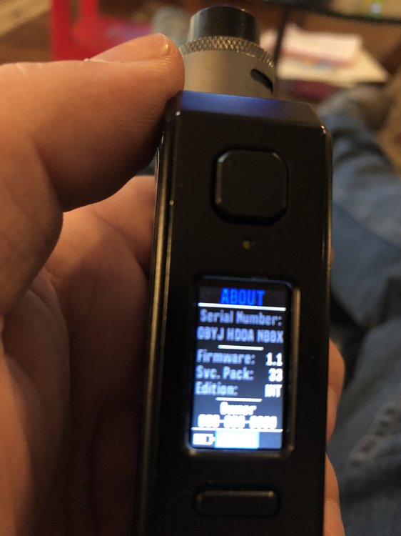

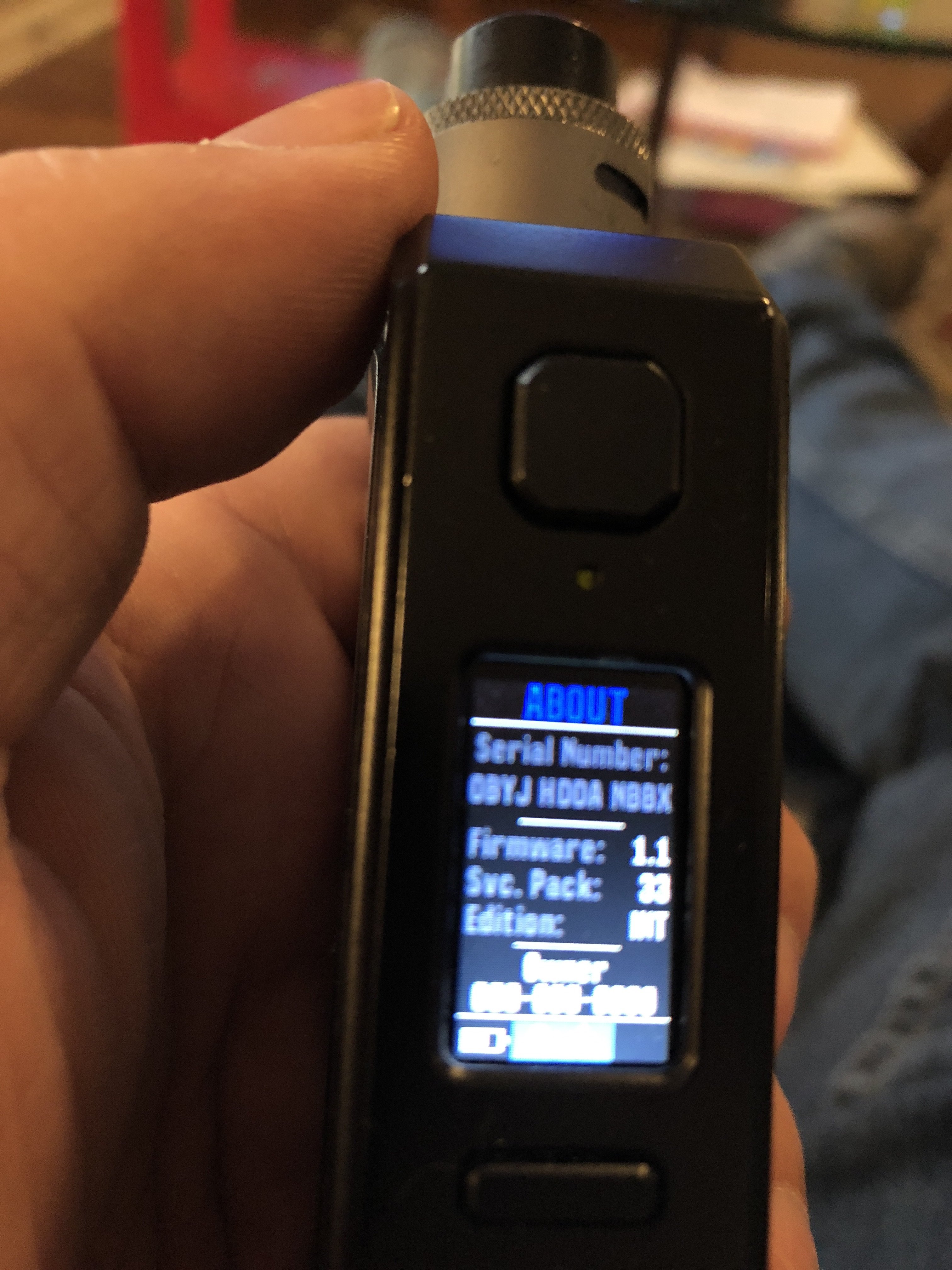

niandra3 Posted May 19, 2018 Report Posted May 19, 2018 1 hour ago, Malaysia said: i also got the same...reply field box is blank....any solution of that matter...could anyone ca n help me how to fixed this problem...thank you in advanced Try my theme if you want: https://forum.evolvapor.com/files/file/488-clean-black-and-blue-75c250c-wreplay/ It's got a really simple and easy way to use replay. But it also has a replay menu so you can go in and see if it's even enabled. You HAVE to enable Replay in the profile you are using. You also have to use the INTERNATIONAL version of EScribe and the right firmware. All those details are in the description of my theme above.

niandra3 Posted May 22, 2018 Report Posted May 22, 2018 (edited) You guys are right, sorry. Definitely kanthal does not work with Replay. But yeah mixing kanthal with other TC metals does work (just like normal TC). And apparently you don't have to tell the mod what the material is... no more TCR or anything.! (I always use "wattage" as material for Replay mode) I found the exact quote (useful info): https://youtu.be/Jac9au_1uY8?t=28m37s But again for REPLAY on a 75C, you need latest International Edition of EScribe (currently v2.0 SP15.1) and latest firmware on your mod (I use 1.1 SP33.2). Then you enable Replay in the profile. Then you go to that profile on your mod, take a puff, and the save button should appear. That being said, after trying it for a while I don't really see the appeal. It's just a slightly different implementation of temp control. Edited May 22, 2018 by niandra3 1

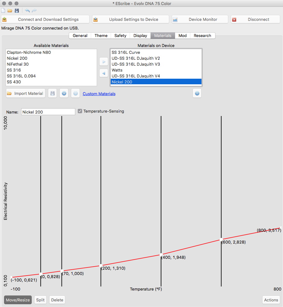

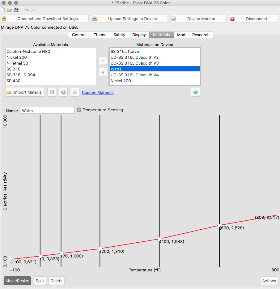

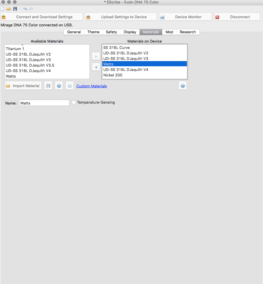

Korwin Posted May 23, 2018 Report Posted May 23, 2018 I tried the wattage material for Replay profile, it looks like Replay works but at higher power does not work TC, i got dryhits ... if i confirm Temp-sensitiv material u Wattage material table, it turns on curve for Nickel200, so for SS wires probably unusable... 1
GHammer Posted May 23, 2018 Report Posted May 23, 2018 3 hours ago, Korwin said: I tried the wattage material for Replay profile, it looks like Replay works but at higher power does not work TC, i got dryhits ... if i confirm Temp-sensitiv material u Wattage material table, it turns on curve for Nickel200, so for SS wires probably unusable... I think you have other problems with your tank/coils/wicking. No idea what you mean by confirm TC material in wattage material table. I use SS430 daily and can assure you that Replay works well with it.

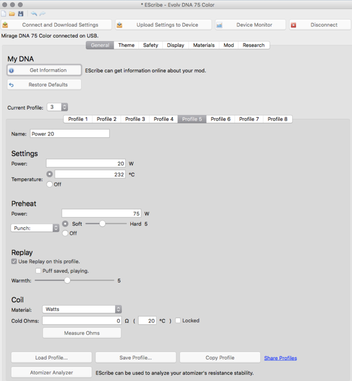

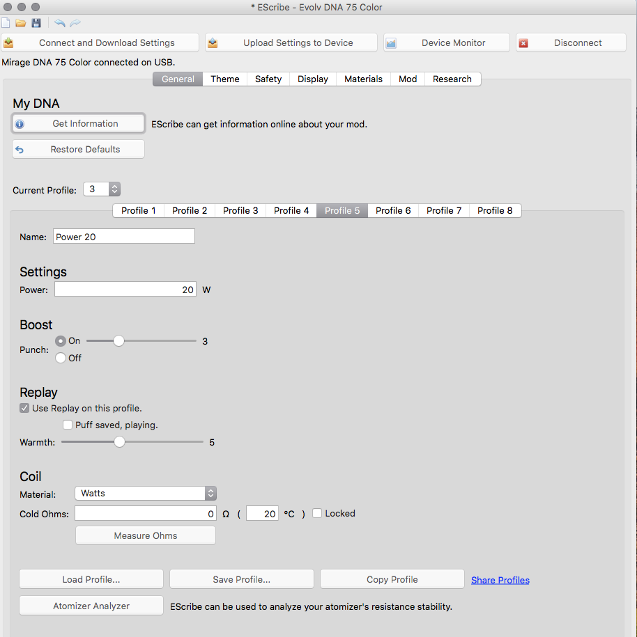

Korwin Posted May 23, 2018 Report Posted May 23, 2018 Try to compare these pictures - depending on selected Temp-sensing check box You can see different possibility at Profile table - with or without Temperature box under Power settings box... Also compare curves for Nickel200 a Watts under Temp-sensing checkbox... there is no difference
