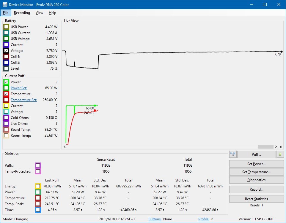

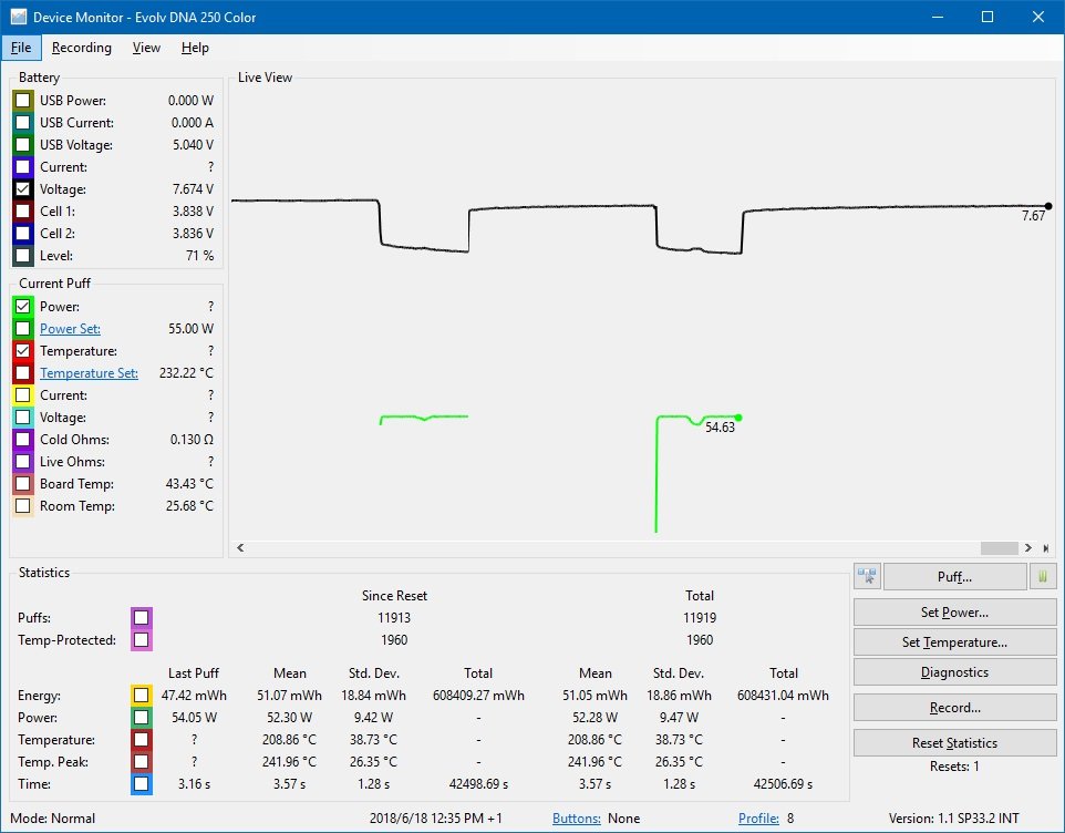

retird Posted June 18, 2018 Report Posted June 18, 2018 Can you post a Device Monitor screenshot showing firing in tc mode and one showing firing in replay mode?
pw82 Posted June 18, 2018 Report Posted June 18, 2018 Here. Of course now that I want it to, I can't catch it "throttling". I'll keep trying and post if i can catch one. Though last time I did, it appeared like a normal hit.
Pete1burn Posted June 18, 2018 Author Report Posted June 18, 2018 Pw82 is right. In the device monitor it looks like it's behaving normally but power is cut to nothing.
retird Posted June 18, 2018 Report Posted June 18, 2018 So, you say when the power cuts off Device Monitor still shows power being used and voltage lowering? Device Monitors show in real time live view... if the device isn't firing what is using the power?
pw82 Posted June 18, 2018 Report Posted June 18, 2018 It just appears as a short hit that was ended normally, even though the fire button is still being held and throttled / temp protect is displayed until released.
retird Posted June 18, 2018 Report Posted June 18, 2018 So when it drops out as a short hit Device Monitor no longer shows power being used and no drop in voltage?

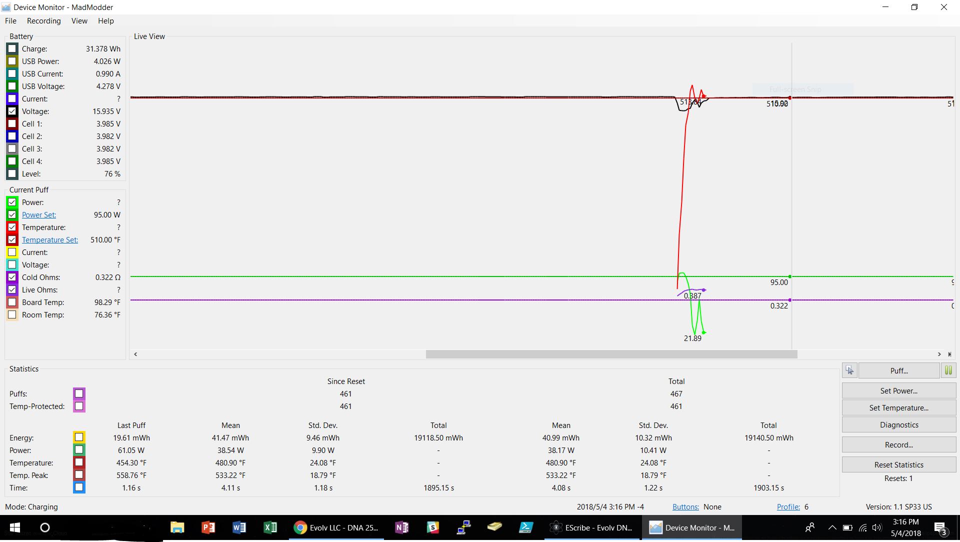

retird Posted June 18, 2018 Report Posted June 18, 2018 On 5/4/2018 at 2:19 PM, Pete1burn said: This screenshot? It looks like you overshot temp setting quickly.... at 95 watts......and you overshot wattage also..... what about turning down the wattage.... what happens then? Is your preheat set way up also? I ponder why the excessive overshooting?
