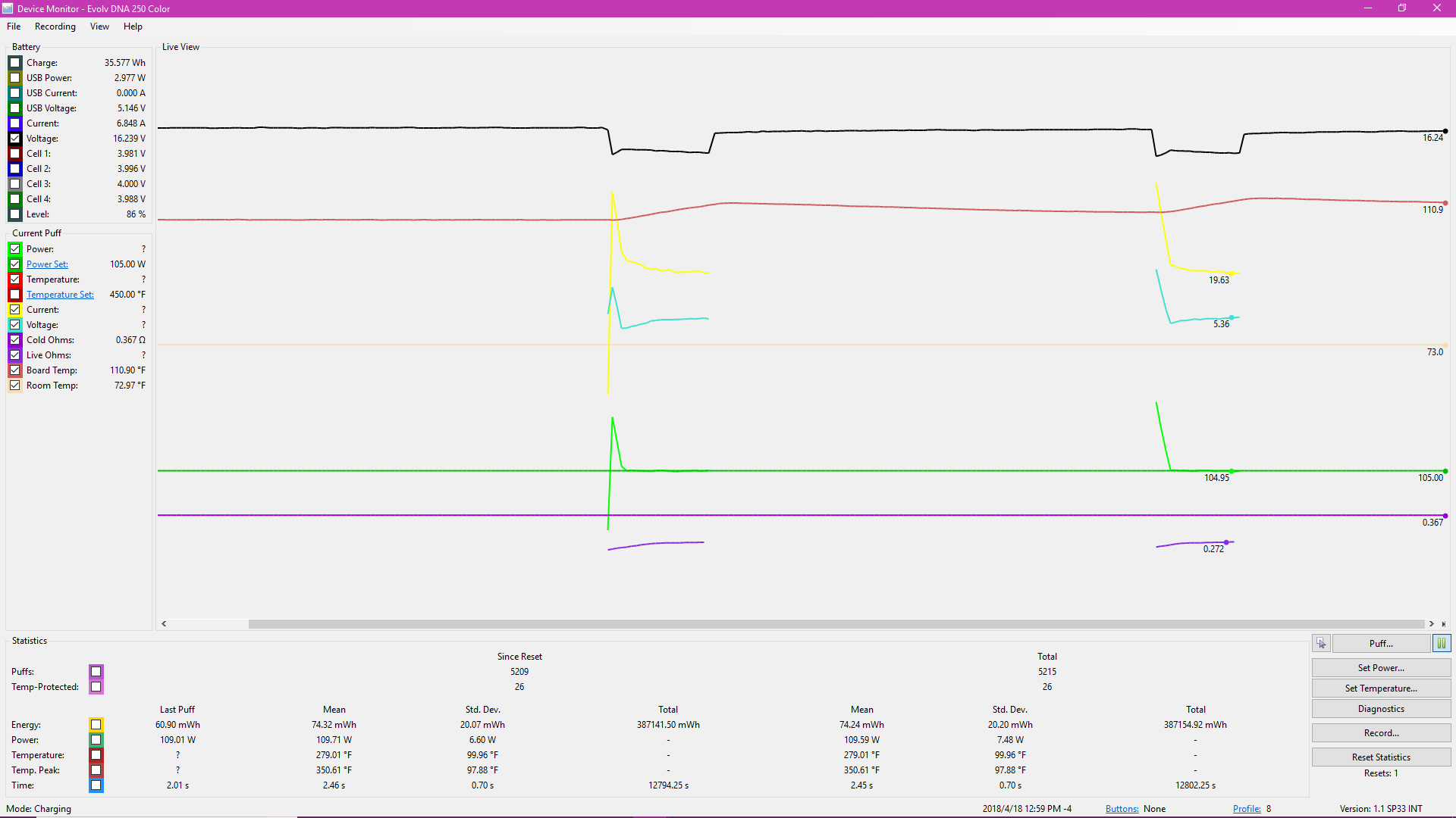

I have a Mad Modder Mod with DNA 250C chip with 4s lipo. My build is Lightning Vapes SS316L 2 core fused clapton 26g/36g 8 wraps non spaced 3.5mm id. Cold ohms is .34 and live ohms is .27. I cannot get tcr to work in SS316 mode. I always get temp protect message. Also, when I play replay, I get check atty message. What do I need to do to get these modes to work? I have tried different atomizers as well with no luck.

7 minutes ago, Wayneo said:
Well this looks backwards ????? @retird, is this possible under normal conditions on these C boards?
If it's possible I've not seen it or do I recall any similar posts.....  I really don't know much about those "exotic coils" so help may come from those who do.....  only thought now is TCR, atty, or coil issue.... he might try a simple coil in the atty and see if it goes with that one....

@Wayneo those numbers were from the device monitor. I am using The Hive RTA by CCI. I also tried the Icon RDA by Vandy Vape with no luck. I tore the Hive completely apart and gave it a good cleaning a few weeks ago. Great tank by the way. I need to rewick it. I'll try playing with it unwicked to make sure no hot spots again. I'll try a simple build on the Icon and see if that helps any.
