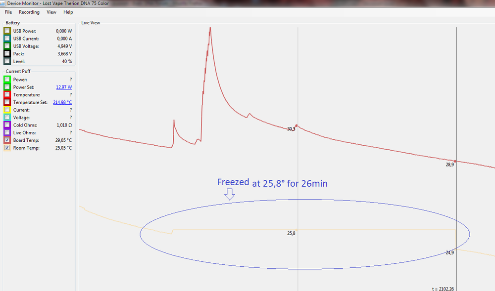

LeeWB3 Posted July 13, 2017 Report Posted July 13, 2017 Are you watching on device or in Escribe? Both ocassionally act kinda weird and kinda freeze at one room temp for a long time. Generally, however, if I am watching in Escribe's Device Monitor with Diagnostics/USB Charging Off and having clicked the view Board and Room Temperatures I can watch it as the room temperature slowly goes counts down. I set one device up with 10s case settings and it came down to the actual room temperature (or at least the best estimate it achieved) much faster. But YMMV a bit on this board. I think Evolv is still pretty actively working on the software as evidenced by the number of Escribe and Firmware releases they've been putting out recently.
Frank65 Posted August 6, 2017 Report Posted August 6, 2017 (edited) Hello Is it normal board\software beahaviour that (always) when I start firing the device , software stops calculating room temperature ? This both on fw24\25 , testing with mod (Therion 75c) connected to device monitor (with USB chargin off). After sometime (I just tested first 26 min , second 16 min , third 39 min freezing) , it unfreezes and restart calculation, with a sudden temp value deviation. Sure that's not a major bug , but I'm curios to know ,beside how "it" works, if is there any magic trick \ hidden parameter to shorten freezing time period ? Thermal test performed , room temperature (when not freezed) is very near real temperature . Sorry 4 bad english .. Edited August 6, 2017 by Frank65
