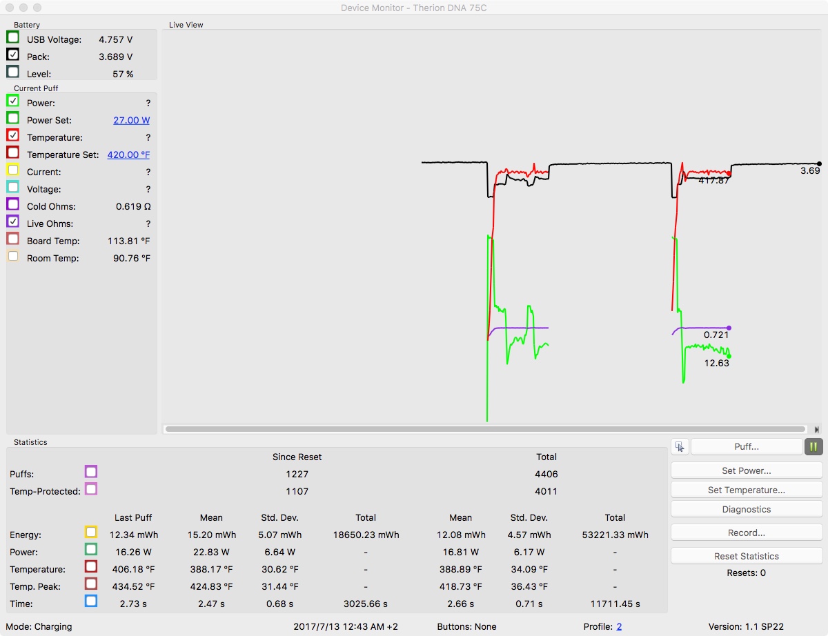

ndb Posted July 9, 2017 Report Posted July 9, 2017 I have to report something weird that _might_ be related to the latest SP22 firmware, but I'm not sure, so I'll try to describe what I'm seeing. First of all, it has happened sometime with the previous FW too, but it was occasional, while it has now become systematic. Using my two 75C mods (vapedroid x1c2 and therion 75C), with two different atomizers/builds (serpent smm on the droid with a 1.3ohm SS316L, squape Xdream on the therion with a 0.62ohm SS316L) both with the SS316L profile from steam-engine. After the mod has been idle for a while (probably for the time it takes to auto-lock, but I'm not sure), it won't fire going immediately into "temp protect". In a couple of instances I was able to get it firing again just re-trying for 3 or 4 times, but most of the times it won't just fire, _never_. The workaround I found to be working is: 1) switch to a watt (i.e. no TC) profile 2) fire it a couple of times (no temp protect error here obviously) 3) switch back to the TC profile 4) fire it and when asked refuse to update the cold ohm value (which is of course higher and wrong because of the heat-up during firing in watt mode) And then it'll work again. As soon as I let it sit idle for a while, it will get back into not firing and I'll have to repeat the process again. I tried to re-flash the FW, hard-reset, remove batteries, switch atomizers between the mods. Nothing seems to work. Anybody else experiencing this?

ndb Posted July 9, 2017 Report Posted July 9, 2017 7 hours ago, James said: Hmm. Thanks for reporting this. I had noticed an occasional Temp Protect myself, and have noticed Peak Temperature occasionally reading wrong. I think it might be misreading when it's down at 1W or less before firing. Will investigate on Monday. In the meantime, FWIW, the Mac version should run on SP21 just as well. 1 Thanks @James , I also noticed the following: if I re-read cold ohms right after failing to fire in TC with the temp protect error, most of the times it reads a lower resistance (e.g. right now, the 1.3 became 1.278 and the 0.62 went down to 0.605) and in some cases with this lower reading I'm able to start firing again, but then it feels like it actually read too low and I'm in weak-vape land. As I just noticed this, I haven't observations for what happens if it re-reads a cold ohm value which is _not_ lower than the pre-existing one. To summarize, 3 different scenarios: Refuse to fire, but retrying 3 or 4 times starts firing again. Only happens rarely, I'd ballpark it as less than 10% of the cases Refuse to fire forever, the fire-in-watts-then-back-to-TC dance "unlocks" it 100% of the times Refuse to fire forever, re-reading a lower resistance "unlocks" it about 50% of the times. No observations for what happens if it re-reads the same cold ohm value. 1 hour ago, Lowbytes said: I can see it in my Theme because i´ve set the Temp reading to live view - If my dest Temp is set to 210°C - firing - Temp digits are going blank (because there´s no temp reading) - after 2 or 3 Times short firing live temp is coming back! 2 Exactly, but in my case it self-recovered in less than 10% of the cases, see my point 1 above. 1

ndb Posted July 12, 2017 Report Posted July 12, 2017 1 hour ago, James said: I've posted up a version that should be compatible with OS X High Sierra b3. @ndb, let me know if it fixes your firing problem, by the way. Thanks! Hi @James, just tried and unfortunately nothing changed wrt the immediate temp protect problem. Neither on the Therion nor on the vapedroid. I can't use eitherof them unless I go through the wattage profile first. I've uploaded a video showing the behavior on the Therion, the vapedroid does exactly the same with a different atomizer and a different (higher ohms, ~1.3) build. Please have a look if you can: (By the way, my room temp is currently ~84F, which is what I've forced into the cold ohm settings, while the board reports 91F)

ndb Posted July 12, 2017 Report Posted July 12, 2017 (edited) 9 minutes ago, James said: Could you try resampling your Cold Ohms? Well, I had just resampled (to the 0.614ohm seen in the video) from escribe right after applying the service pack and before shooting the video. In any case, even if I had just done those two test fires, I resampled and to my surprise I got an even lower 0.609ohm. The good news is that it now seems to be firing again without temp protection, the bad news is that it seems really like a misread cold ohm value, since I now have an anemic vape and had to crank temperature up to 480F.. Note that this atomizer reads ~0.623 on other DNAs. EDIT: right after posting this and trying to have a vape, I got another couple of temp protects on first fire (and it hadn't even got locked in the meantime), but this time it started firing again at the 3rd attempt without having to go through watts... Edited July 12, 2017 by ndb Add additional info
James Posted July 12, 2017 Author Report Posted July 12, 2017 Hmm. Does Atomizer Analyzer consistently say 0.609? Also, is it a commercial atomizer? If so I'll order one for testing. What kind of resistances are you seeing while firing?
ndb Posted July 12, 2017 Report Posted July 12, 2017 (edited) Well, I've now vaped it another 3 or 4 times, so it's not at base temperature for sure, but atomizer analyzer is fluctuating btw 0.616 and 0.621. That particular atomizer is a Squape X-dream, so yes, it is commercial, but keep in mind I'm having the same experience with another completely different commercial atom (a serpent SMM) on the vapedroid, where I already resampled another three times and still getting temp protect. The only difference on the vapedroid/serpent combo the ohm reading didn't get too low. I'm feeling a bit lost... EDIT: Sorry, I forgot to mention that on the therion atomizer analyzer shows a resistance up to 0.704 while vaping with temperature set to 420F EDIT2: Looking at live res with AA is not the right thing to do, here's a screenshot of device monitor for the therion/squape, after resampling again, this time @ 0.619ohm, live res going up to 0.721 Edited July 12, 2017 by ndb
