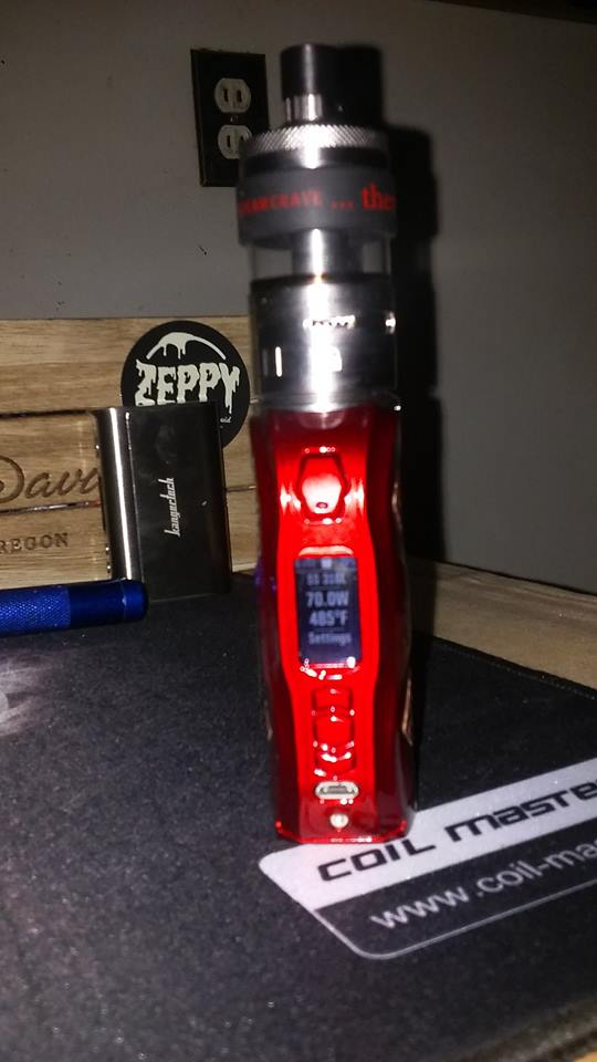

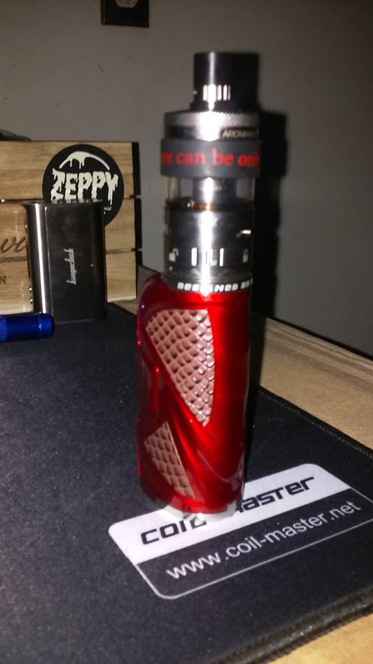

Smokin Dave Posted July 8, 2017 Report Share Posted July 8, 2017 I've had the red one for about two weeks and I think it works just fine.I'm experiencing no heating issues with the battery door but I digress that it is a bitch to use the down button when the usb is hooked in plus the buttons can stick but to me not a huge issue.I have a Steamcrave Aromamozer 30mm plus on it and it looks fine.I also swapped out the theme to this one .... which works better than the stock theme. Link to comment Share on other sites More sharing options...

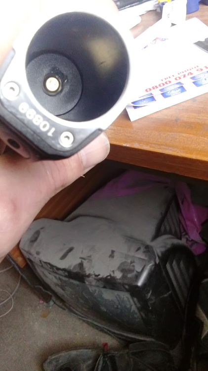

David247 Posted July 18, 2017 Report Share Posted July 18, 2017 (edited) The same thing happened to me with 2 green efest 26650 David Edited July 18, 2017 by David247 Wrong pic Link to comment Share on other sites More sharing options...

danforthharris Posted July 18, 2017 Report Share Posted July 18, 2017 On 7/18/2017 at 5:39 AM, David247 said: The same thing happened to me with 2 green efest 26650 David Expand Ok, I think I figured it out. The positive terminal with 26650's is quite large. What seems to be happening is if you tighten the battery door down too much, the positive terminal on the battery actually touches the top of the battery tube, which is the body, which is the ground or negative side, thus basically shorting the battery. I just put a 26650 battery in, and with the positive pin not even in place the top of the battery started to ground out. The plastic insulator at the top of the battery tube.....well It's shit!! and now mines melted a little bit. I imagine this will not happen as much or even at all with 18650's. The positive terminal on 18650's is only about the size of the hole for the positive pin of the mod. Less likely to touch anything there. THIS IS VERY DANGEROUS!!! THE MOD IS DANGEROUS TO USE WITH 26650's Link to comment Share on other sites More sharing options...
David247 Posted July 18, 2017 Report Share Posted July 18, 2017 I agree I have gone back to using the tube and 18650 as the battery cap sits flush. Link to comment Share on other sites More sharing options...
danforthharris Posted July 18, 2017 Report Share Posted July 18, 2017 (edited) A better insulator at the top of the battery tube should do the trick. some felt or some vinyl or something of the like. This will probably make the battery door stick out slightly. The problem with this is, the consumer shouldn't have to do this. This has nothing to do with Evolv. This is on Hcigar. I truly hope no one has a 26650(or any battery for that matter) vent on them with the mod in their pocket or worse. I'm not an alarmist. But I believe this to be a potentially dangerous mod in its current configuration. Edited July 18, 2017 by danforthharris 1 Link to comment Share on other sites More sharing options...
Lowbytes Posted July 18, 2017 Report Share Posted July 18, 2017 (edited) BUT - the size of an unprotected flat top cell should be 65 millimeters (corrected) - no matter if it is a 18650 or a 26650 For me it looks like that the Area around the positive contact inside the tube is isolated - or do you think that the spring loaded contact is pushed against some area behind the spring load??? In the german DNA75C Group no one reported problems with 26650 cells on the Hcigar DNA75C - beside getting weak Bat.......... Edited July 18, 2017 by Lowbytes Link to comment Share on other sites More sharing options...

danforthharris Posted July 18, 2017 Report Share Posted July 18, 2017 On 7/18/2017 at 12:38 PM, Lowbytes said: BUT - the size of an unprotected flat top cell should be 65 millimeters (corrected) - no matter if it is a 18650 or a 26650 For me it looks like that the Area around the positive contact inside the tube is isolated - or do you think that the spring loaded contact is pushed against some area behind the spring load??? In the german DNA75C Group no one reported problems with 26650 cells on the Hcigar DNA75C - beside getting weak Bat.......... Expand An 18650's diameter is 18mm and a 26650 is 26mm. The Length of both is close to 650mm. The positive terminal on a 26650 is much larger then the 18650. I had the short happen with the positive pin of the mod removed. I was looking for the area of the short. The positive pin of the mod seems to be adequately insulated from the body. The contact area is somewhat isolated. There is an insulator at the top of the battery tube, but it's very thin. i'm not sure how but if you look at Dave's picture up above you can see where the insulator started to melt a little. Somehow the positive terminal of his and my 26650 is shorting on the battery tube. Most 18650's are slightly shorter then 26650's. Only by a little bit but enough. 18650's are also just shorter then the adapter tube for this mod. With the spring loaded Positive pin I think there is plenty of space for them to not contact the upper insulator. So this issue shouldn't be had with those batteries. Link to comment Share on other sites More sharing options...
Smokin Dave Posted July 18, 2017 Report Share Posted July 18, 2017 On 7/18/2017 at 5:39 AM, David247 said: The same thing happened to me with 2 green efest 26650 David Expand Wow. That's pretty messed up.I've had zero problems with anything like that other than a weak battery screen popping up but rectified with a good cleaning of the door threads.Plus I'm using Ijoys and Efest 26650 batts.I'd send it back and say fix this POS. Link to comment Share on other sites More sharing options...
Droopydroors Posted July 19, 2017 Report Share Posted July 19, 2017 I wouldn't use efest batteries for multiple reasons. 1.) They suck and have a horrible sag that only let's you get down to around 40% on the battery before the sag stops the mod from working even at 30w. 2.) They are too long. When using the Efest 26650 the battery cap should not be tightened to tight. When you do tighten further than snug you will bend the flat top causing it to short. So even though the battery cap is not screwing in the whole way it's better than blowing your hand off from over tightening. The Ijoy and Brillpower batteries fit much better and the Ijoy is a far superior 26650 that acts much like an 18650 as far as sag. I have run the battery below 25% without issue. 1 Link to comment Share on other sites More sharing options...
