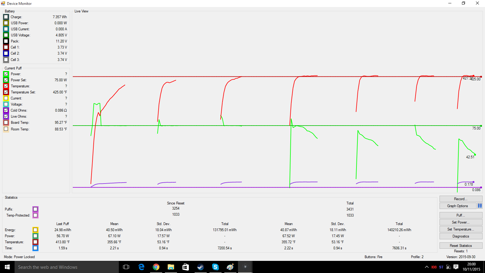

Spector NS5 RD Posted November 10, 2015 Report Posted November 10, 2015 from what u posted, nothing looks fishy with your settings. how bad does it burn your cotton? does it just singe it or burst into flames? you are using spaced coils right? im sure u know nickel is very soft and not to crank down on the post screws. can you post some pics of your build and a screen shot of device monitor while firing the ni or ti coil? make sure temp, set temp, ohms, live ohms, power, and power set are ticked in the boxes. do a couple test fires and post those up on here.edit..... make sure the your mod res is set to .0045 and not .045 just check and make sure

Spector NS5 RD Posted November 11, 2015 Report Posted November 11, 2015 device monitor looks good, normal. maybe try building a little higher in the ohm range like .15 and above. ive noticed that the 200 is quicker to throw up the " temperature protected" message than the dna 40. but all that message means is youre set wattage is higher than what is needed for that peroid of time during your vape, so the chip regulates the wattage so your temperature isnt exceeded. ive been around temp control for quite a while now and it can still be frustrating sometimes, but most of the times its my error. just play with your temp settings, wattage, builds ohms etc and you'll get the hang of it. i would ditch the nickel, its too fussy to work with(imo). stick with ti. if u get a chance try some nife48, it should be a must try on your list. you probably have hot spots in your nickel coil and your preheat is exploiting that. try a new coil and only make your preheat 25% above your set wattage and see what happens.

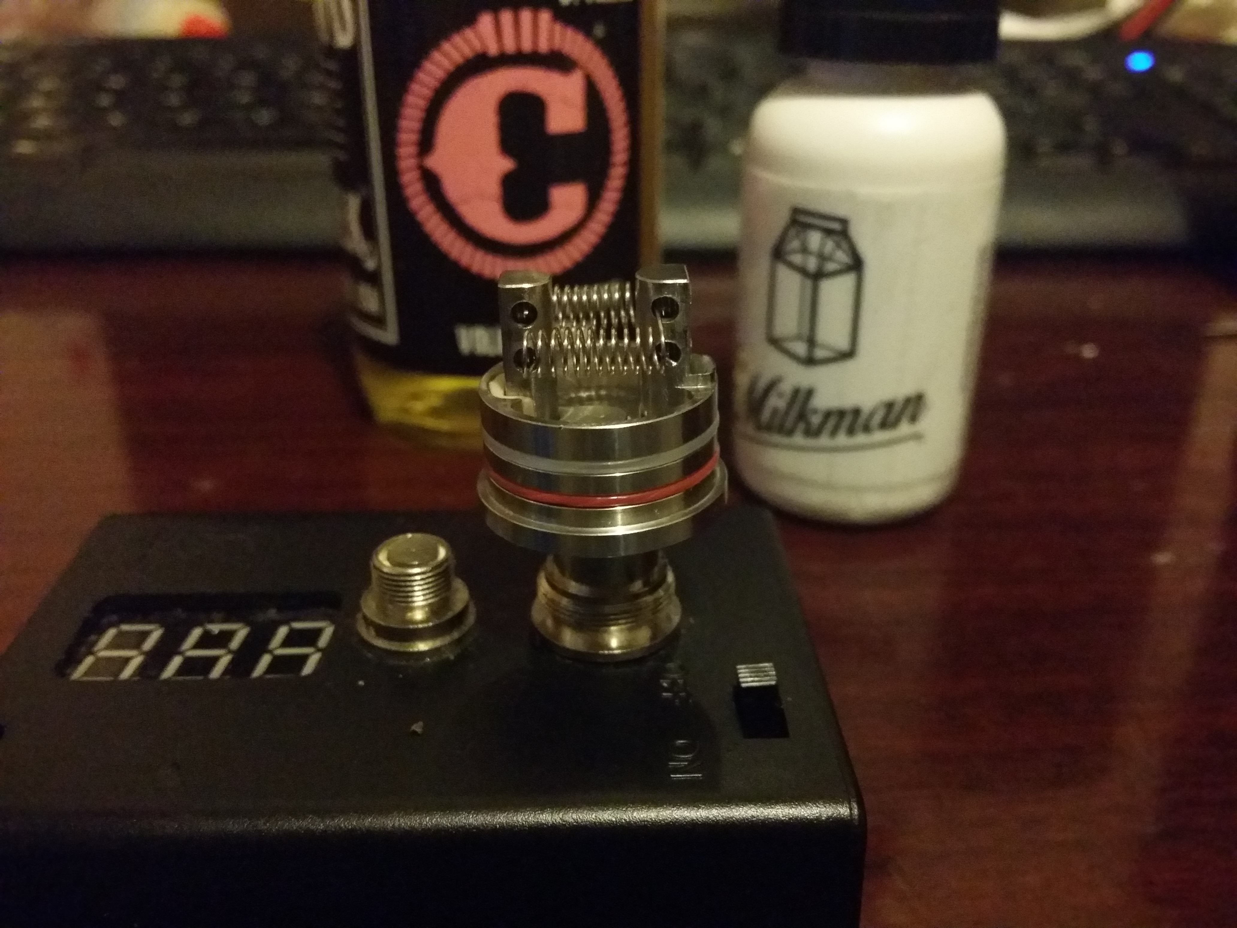

Rip Posted November 11, 2015 Author Report Posted November 11, 2015 Ok. This is my first try at temp control. Guess I'm so used to kanthal and n80. I'll try and turn the temp up more - for a warmer vape. Here is what my ni200 builds look like
Spector NS5 RD Posted November 11, 2015 Report Posted November 11, 2015 great looking build. i see youre insistent on making dual ni coils, lol. arrrrggggggg. try a single one first. make absolutely sure they're an equal number of wraps if their gonna be dual coil. im telling you if you have some ti grade 1 you'll be much happier. you can do contact coils with ti. overall easier to work with.
