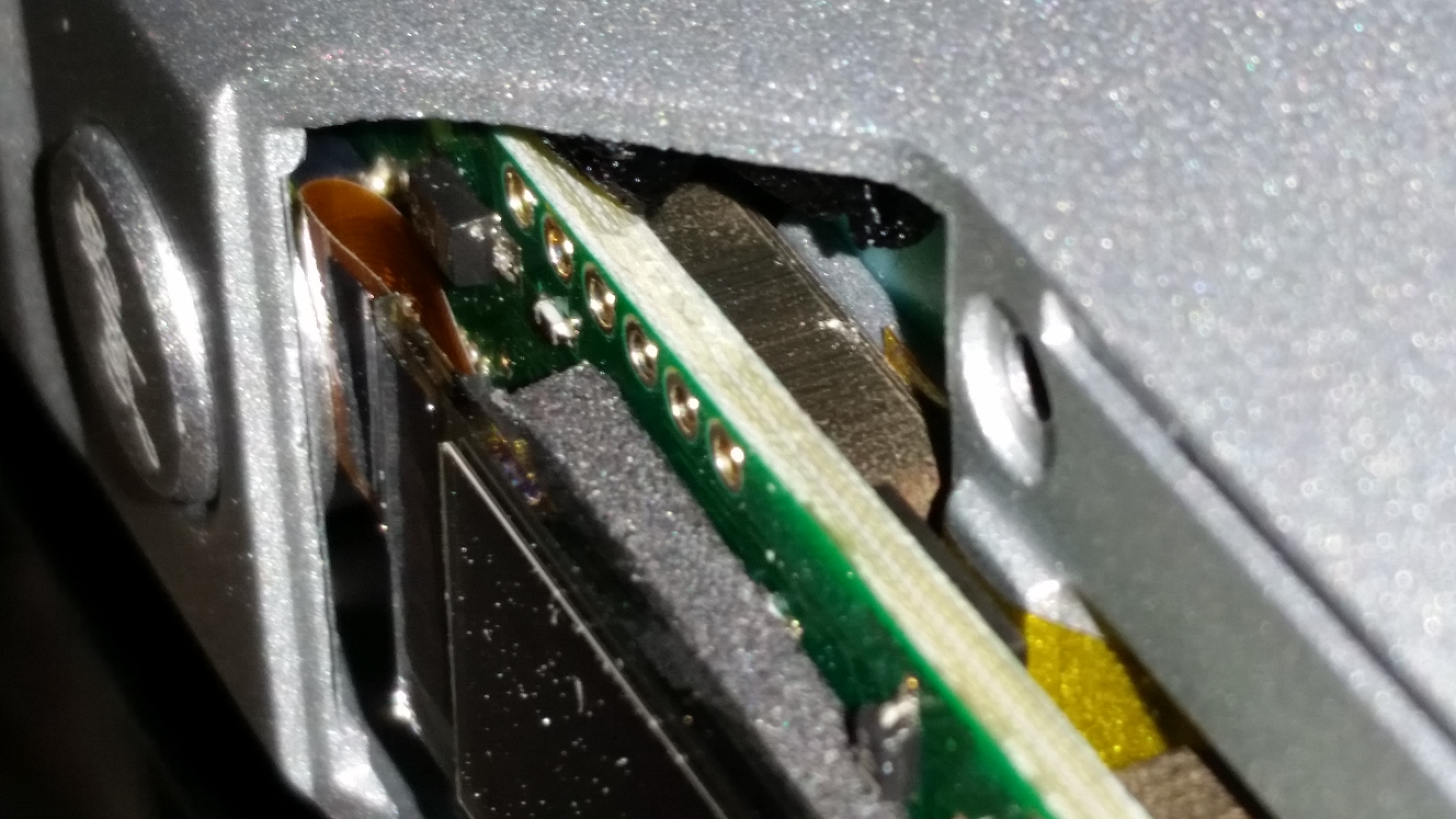

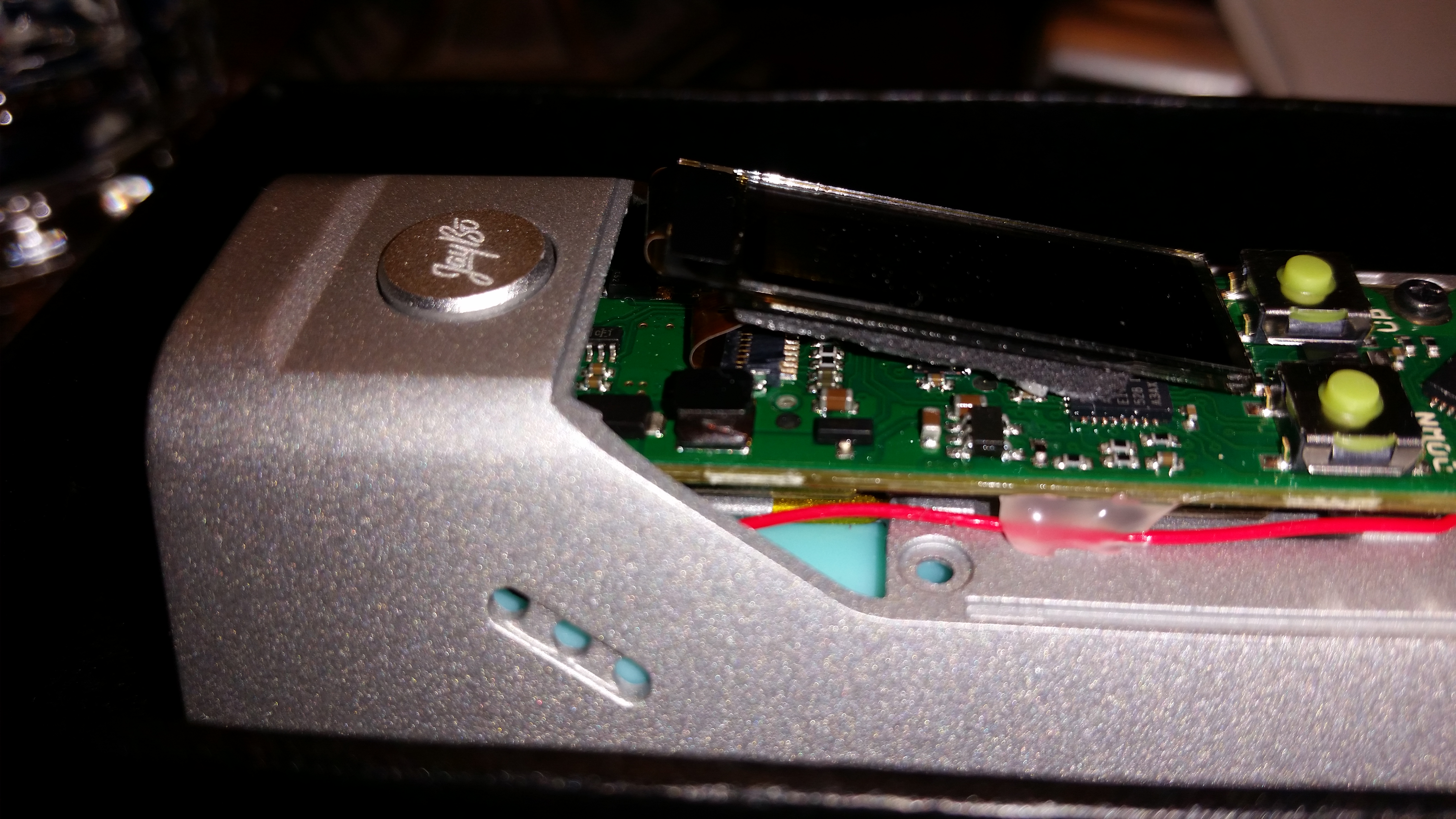

Vaportron Posted December 26, 2015 Author Report Posted December 26, 2015 My reu dna screen IS working but i cant help wonder if i bent the ribbon too much or too closely to the ends. As long as i dont unbend them it should be ok right? Wrong? Never did anything like that before. I have a pic but dont know how to upload it here
VapingBad Posted December 26, 2015 Report Posted December 26, 2015 Vaportron said:My reu dna screen IS working but i cant help wonder if i bent the ribbon too much or too closely to the ends. As long as i dont unbend them it should be ok right? Wrong? Never did anything like that before. I have a pic but dont know how to upload it hereIf it is working fine after bending then it's all good and as you say just leave it be it just needs to be clear of the button.
Vaportron Posted December 26, 2015 Author Report Posted December 26, 2015 VapingBad said:If it is working fine after bending then it's all good and as you say just leave it be it just needs to be clear of the button.Cool thanks. How do i alter the tcr number?I only know how to upload csv'sDo i open and alter the csv's?I found the pic thing so here it is
