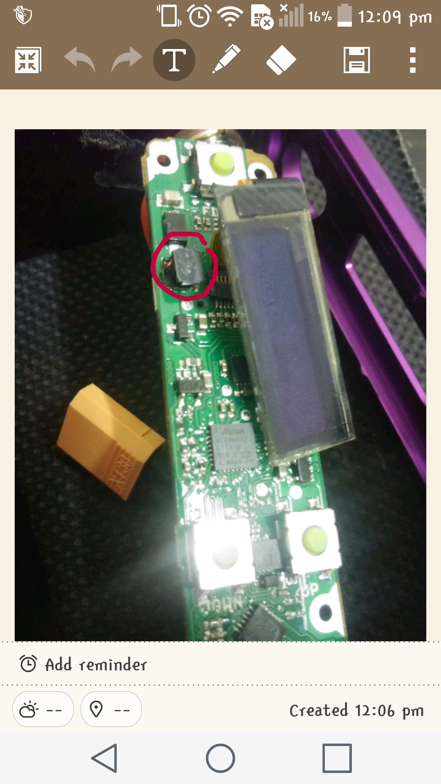

My effusion fuse blown..send to local eletronic shop to replace the 25amp fuse..its back like normal..but after a while i figured someting is wrong with the mods. When the mods go idle..its won't turn on..connect to escibe everything is fine..i try to dismantle the mod and find out the guys accidentally broke the Inductor coil on board..so i need to find a replacement part number for the inductor coil. Anyone can help me on this..much appreciate if someone can tell me the part number so they can replace it back.
