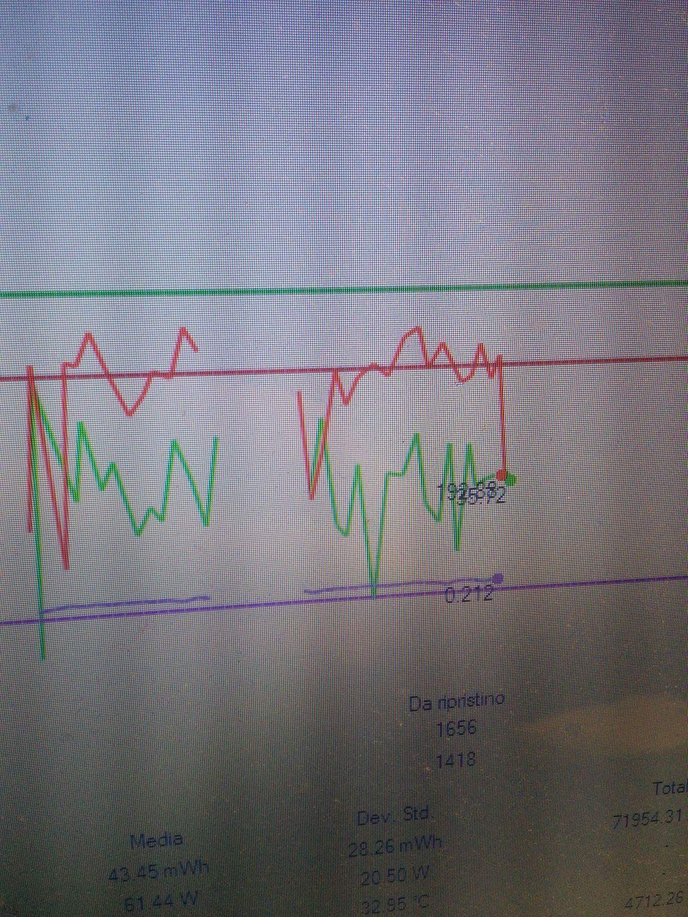

I seem to be having issues with stainless steel (317L) and temp control. I have not tried any other wires other than kanthal.
When I first made my coils I put some cotton in the wick and set to 200C and fired it and immediately the cotton burst into flames.
With no cotton in the coils were pulsing bright orange - clearly not something expected from temp mode.
I tried again with another RDA. This time I set the temperature much lower at 150, tried spaced coils and didn't even try and fire until juice was on.
Extremely erratic vape experience. Sometimes it would work, other times it would throttle the watts to nothing.Even when working I could taste the warming and cooling significantly as the coils were pulsing. In the end I switched back to kanthal in normal mode.
The temp curve was downloaded from steam-engine and I recorded the results in the device monitor.
I have no idea what is going on here but it is certain it is not working correctly.
Any ideas?

Did you decrease the default preheat and load SS TCR into one the profile? If no, download a SS TCR csv file from steamengine website, load the csv file into one of the profile, temp set at 400F, decrease preheat to 15 and set fire wattage to 30w. Build a spaced coil at 0.3ohm, juice the wick, put on the tank, select the SS profile on the mod and let it idle for 20 seconds. Pulse fire it before vaping, make sure ohms are consistent and hopefully it works for you.

I see this on my vaporshark dna200 - when using Celsius - when setting it to F it seems to work just fine ... might be worth a try as I can see you are using Celsius as well ..

Same story here... With 316L SS 0.60 first attempt and 0.50 second attempt, 6 wraps per coil - inconsistent temp curve staying at what device monitor says. No issue with nichel on the same atomizer. Later I'll try to use another atom and see what happens. To simplify tests o don't wrap and don't wick my coil just letting the wire looped and check device monitor while pulsing and firing. It just does not work. Downloaded csv files but did not change preheat and let it at 80 °C, how it wat set before on ni200 Check this pic

Thanks for the replies and the assistance!
I changed to F, used the settings as mentioned by seankwong and then tweaked them a little and it does seem less erratic - maybe there is an issue with Celsius?
Does this graph seem more normal?

Sorry for double post but after posting this went back and had a puff - back to erratic behaviour - nothing has changed other than a minute or so of time and here is what I now get - virtually no vape...

Same issue here, man! Don't know what to do! Cleaned threading, brushed atom Pin and rebuild it again. No way to work for it! Just hoping for un update or something or waiting for Santa's/Jesus/Allah/Gamesh etc... PROBLEMASS.jpg
