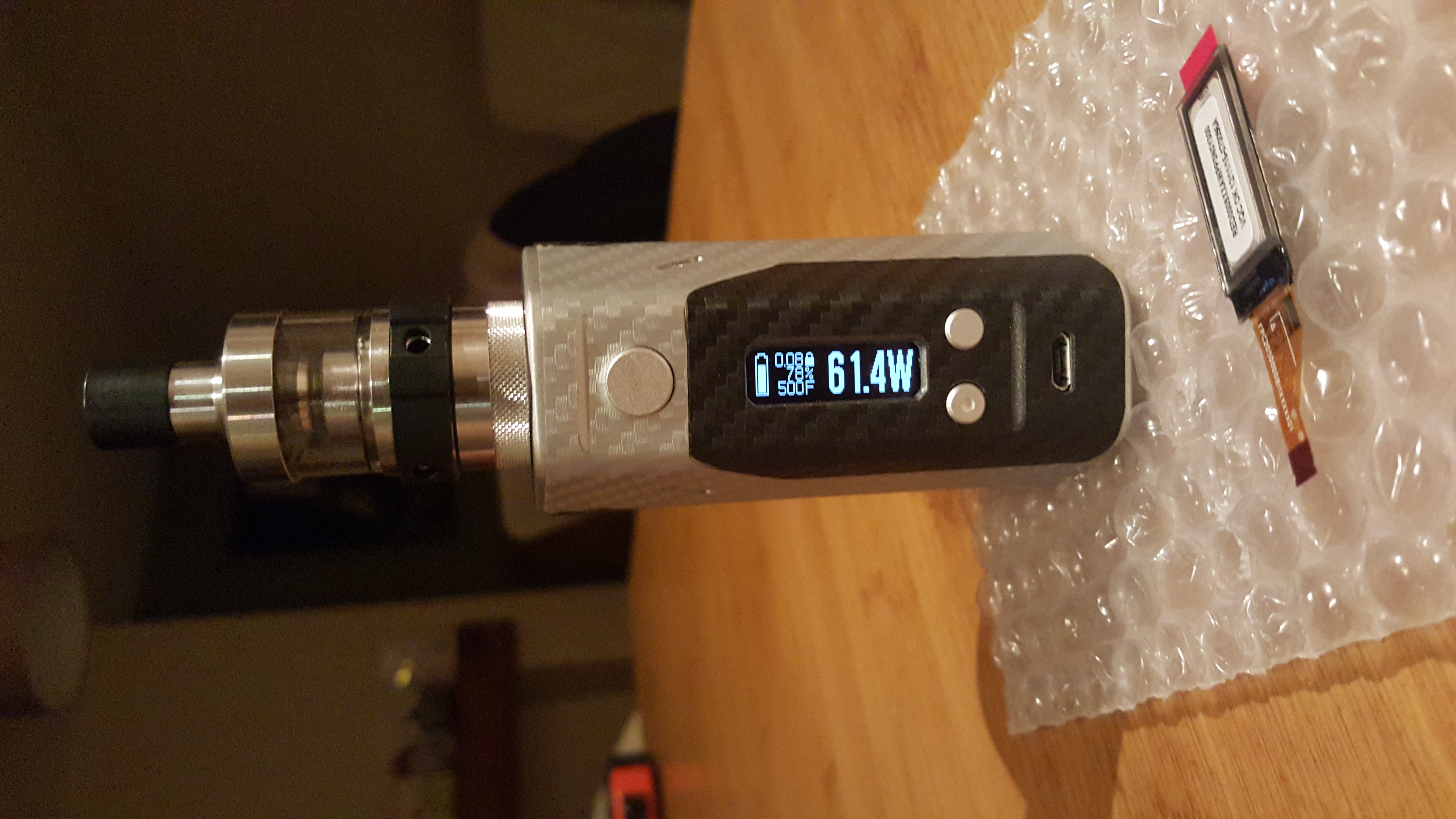

Update.... It's alive! They sent me screen's with a red tab on them that looked like they'd fit OK. Read on this forum the red ones are only suitable for the DNA200 and not the 40+200 like the green ones so that explains the email yesterday. Fitted it with the cable folded under the screen and without breaking anything on the first attempt as well. It's been a rollercoaster.
They do work with the DNA 200 but not the DNA 40. Quote from the forum info/QandA page. "Q: Will DNA40 large screens work with a DNA200? A: Large screens with the green tabbed film on them will work with the DNA40 and 200. Screens with the red tabbed film will only work on the DNA200. No components from any manufacturers other than Evolv are compatible with our boards, or have been tested."

They do work with the DNA 200 but not the DNA 40. Quote from the info page "Q: Will DNA40 large screens work with a DNA200? A: Large screens with the green tabbed film on them will work with the DNA40 and 200. Screens with the red tabbed film will only work on the DNA200. No components from any manufacturers other than Evolv are compatible with our boards, or have been tested."

Cheers VapingBad, reading through that thread pieces all of this together. CDV probably didn't know there was a difference until after posting what they thought (understandably) were DNA40 screens out to customers. I've emailed to let them know I'm happy with what I received and highlight the whole red tab green tab thing.
