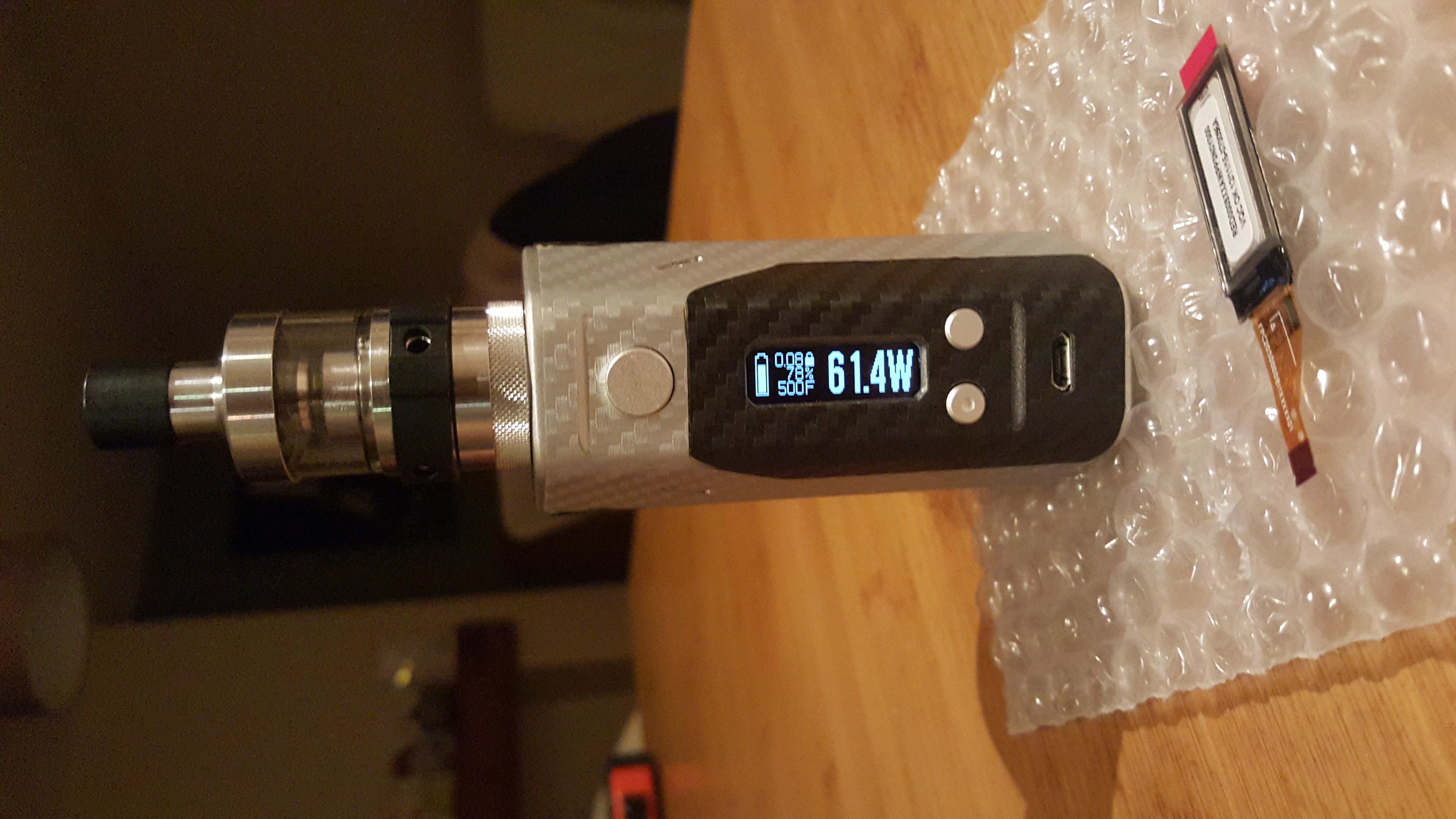

  1. Cheers VapingBad, reading through that thread pieces all of this together. CDV probably didn't know there was a difference until after posting what they thought (understandably) were DNA40 screens out to customers. I've emailed to let them know I'm happy with what I received and highlight the whole red tab green tab thing.
  2. They do work with the DNA 200 but not the DNA 40. Quote from the forum info/QandA page. "Q: Will DNA40 large screens work with a DNA200? A: Large screens with the green tabbed film on them will work with the DNA40 and 200. Screens with the red tabbed film will only work on the DNA200. No components from any manufacturers other than Evolv are compatible with our boards, or have been tested."
  3. Update.... It's alive! They sent me screen's with a red tab on them that looked like they'd fit OK. Read on this forum the red ones are only suitable for the DNA200 and not the 40+200 like the green ones so that explains the email yesterday. Fitted it with the cable folded under the screen and without breaking anything on the first attempt as well. It's been a rollercoaster.

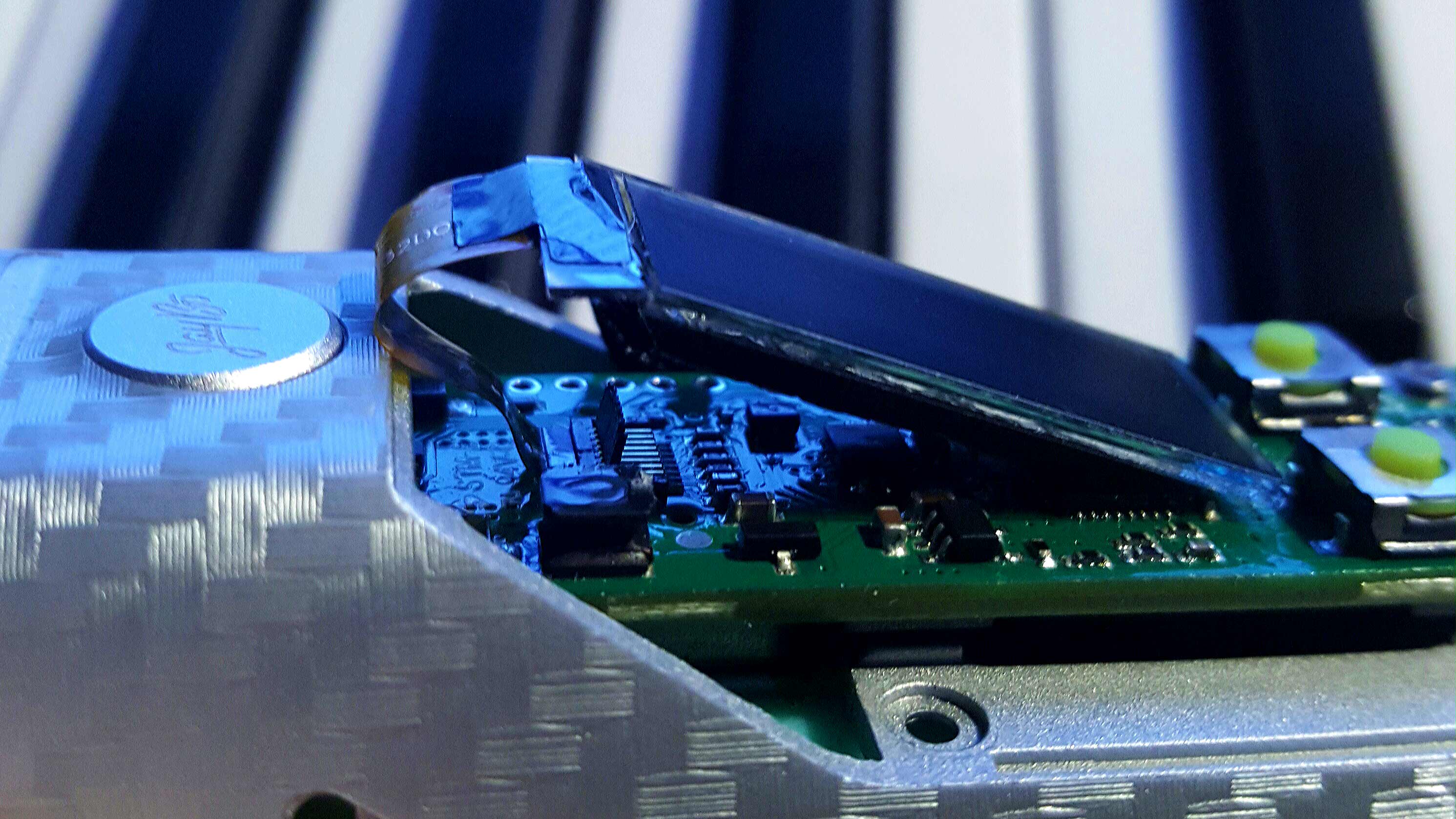

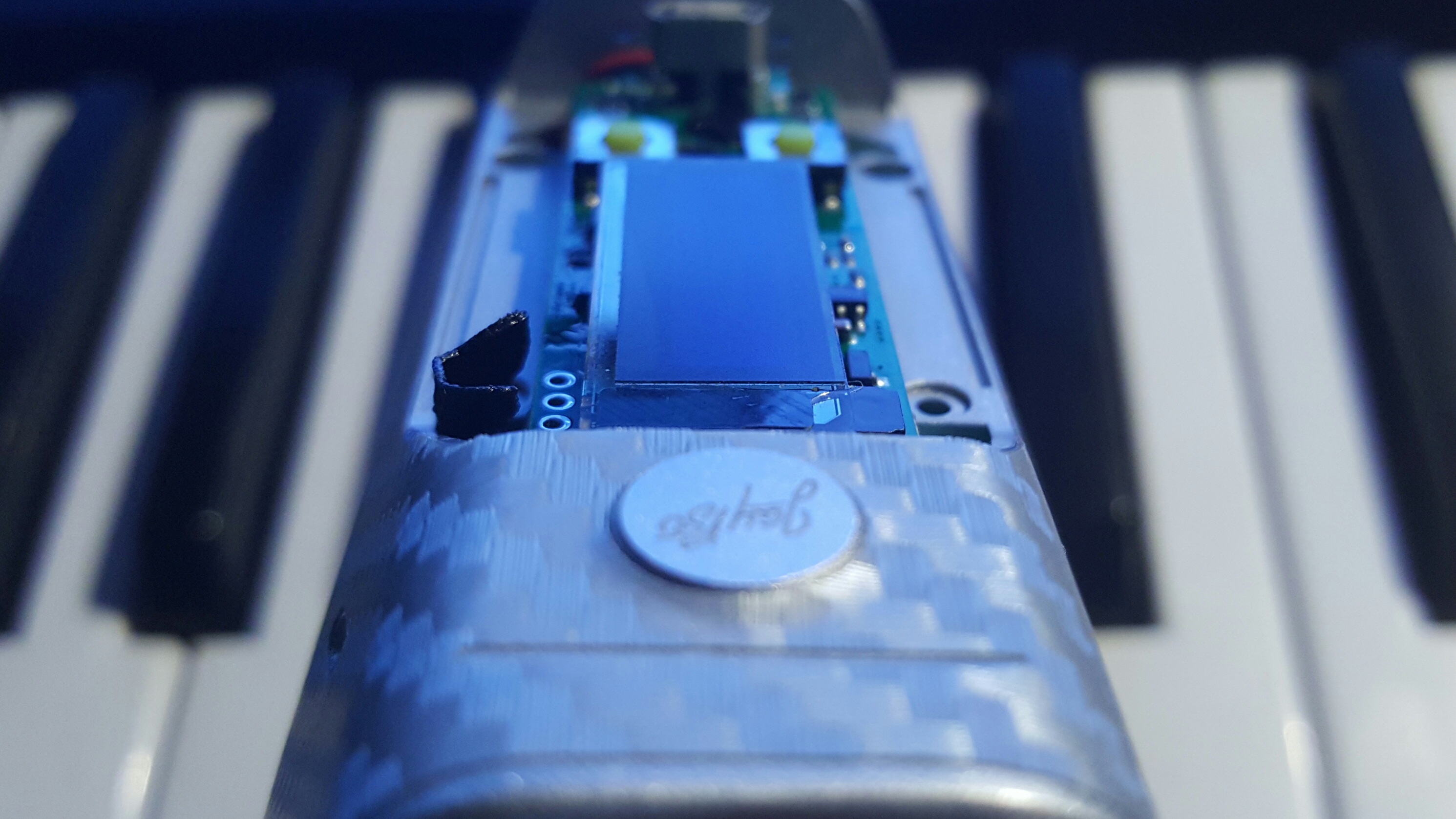

  9. I need to keep my insomniac fiddling limited to coil builds and do this type of stuff in the morning after ive properly read and digested the instructions with some coffee in me! Turns out I've snapped the top section of the glass under the epoxy because I hadn't seated it 100% correctly before attempting to put the front back on . Also explains why half the screen was working after the first try. It still connects to fine to Escribe and vapes great but Ive cut the ribbon back and put electricians tape over it to prevent any shorts to the main board just to be on the safe side. Looks like im waiting patiently in the que for screens from stealth vape when they come back in stock, found a detailed guide that recommends gently bending the ribbon with a credit card in specific points to make installation easier.
  10. One thing I noticed after trying for the first time was the locking tab for the ZIF connector was in the open position. I hope to god I haven't screwed up the board.
  11. Bugger it! Busted my screen trying this because I repeatedly folded the ribbon trying to get it underneath with a plastic stick that was probably (it was) too large for the job. Had only the top half of the screen working after my first attempt and now its totally blank after fiddling around more, I didn't realize how fragile the ribbon is. Looks like im vaping super stealth mode until more screens come in stock.
