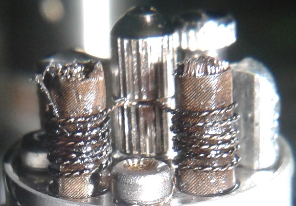

Stainless steel rope wicks with stainless steel mesh covering, this is 0.16 mm (34 AWG) Ni200 so with very high current if there is any short through the wick you will pop the coils before you see the problem. And with thicker wire the current can cause an electrical arch to the wick can burn a hole in it or weld to it.  Fantastic vape, especially with ribbon Ni200, but the only situation I have found where high preheat can be a problem.
