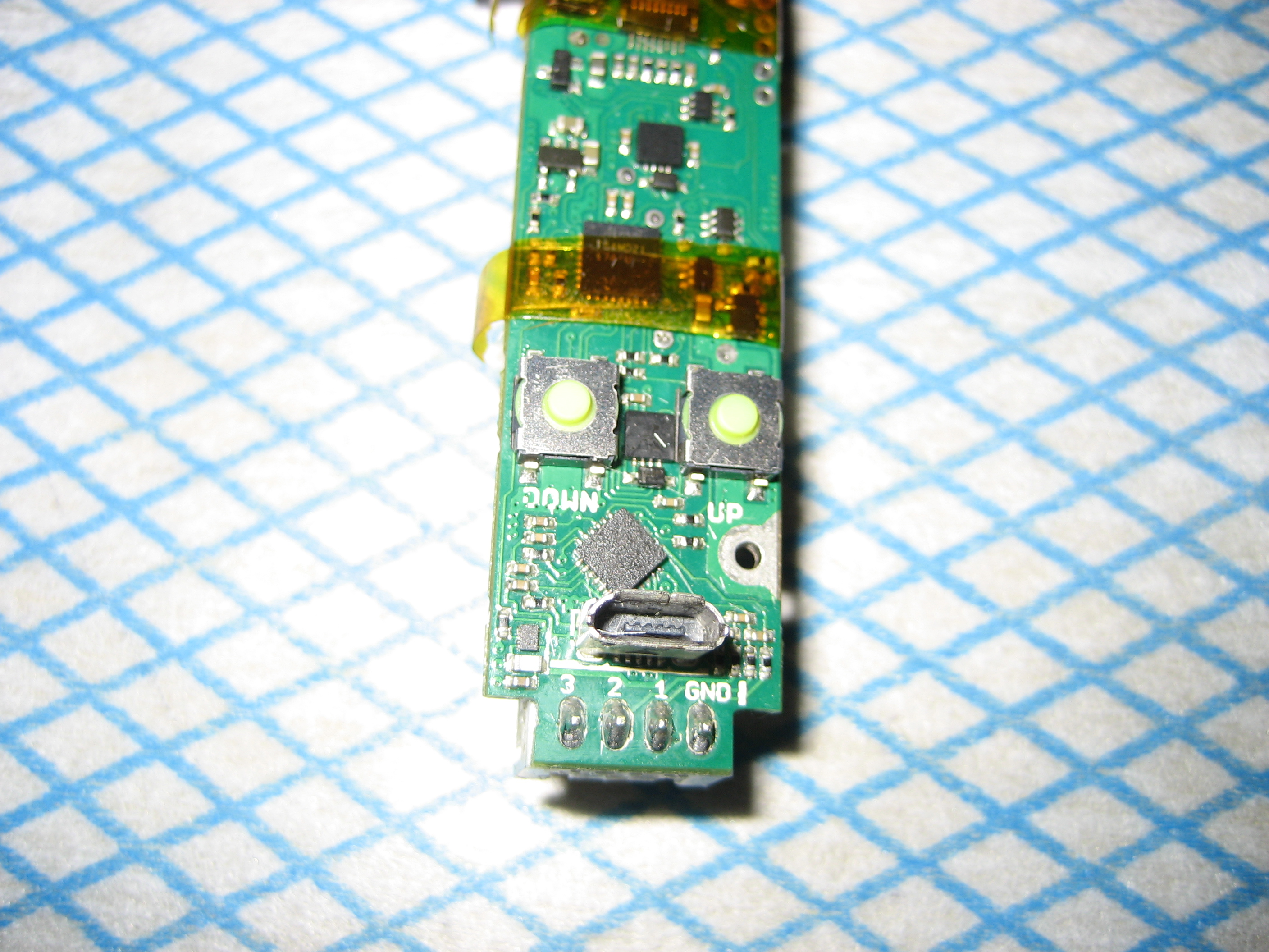

I have tried both soft and hard reboot and i also tried downgrading firmware and then letting escribe auto update it back to the latest. Here are some pics i took of the bottom half of the board when i had it out.
I read about the resistor problems while searching the site for clues and these all look correct to me.

from what i can see nothing looks misplaced to me. i would rma the board back to evolv. not unless someone else comes up with any ideas. if a cell's voltage is fluctuating, sounds like a bad connection somewhere (intermittent connection).

I didn't buy it a friend did and i am trying to sort it for him. I may have found the problem, when i look at the picture of the board on the ordering page it shows a square chip just above the usb port with 6 pins on each side. When i look at this board i can see that only 4 pins are soldered on the bottom right hand side and the 2 middle pins are tucked under the chip. If that is the case then it must have been a manufacturing fault and my dozy friend never bothered with escribe or checking his battery stats.
