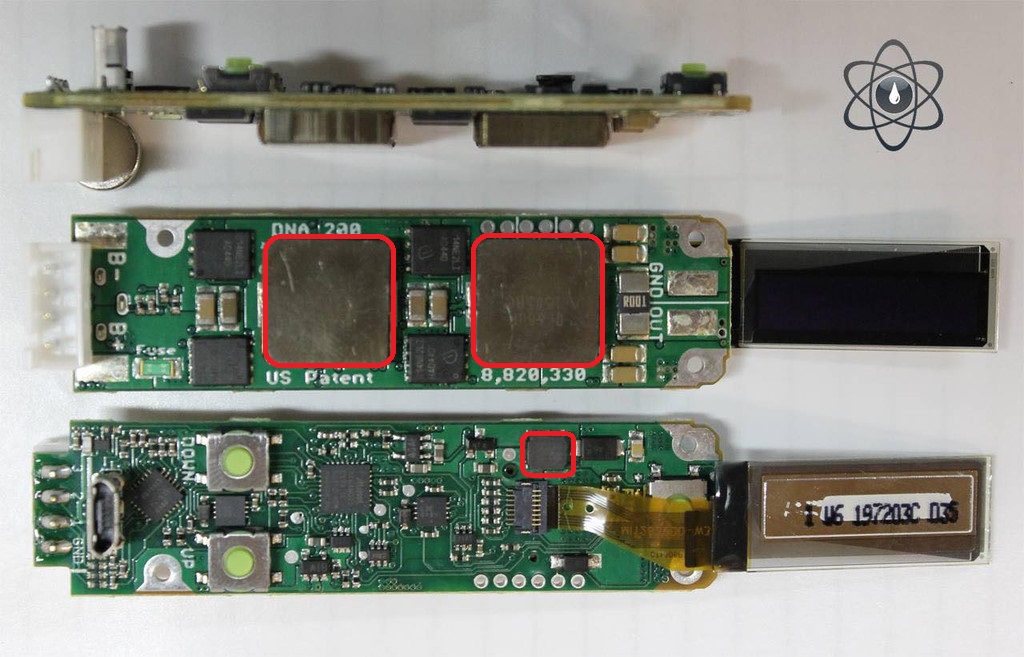

alee132 Posted April 11, 2016 Author Report Posted April 11, 2016 OK I opened it up finally to figure out what is shaking around. It turns out one of the 2 big square heat sinks has come loose. Is that fixable ? Or am I screwed now ?
black lace Posted April 11, 2016 Report Posted April 11, 2016 alee132 said:OK I opened it up finally to figure out what is shaking around. It turns out one of the 2 big square heat sinks has come loose. Is that fixable ? Or am I screwed now ?not sure what your calling a heat sink, as far as I know there is no heat sink as standard on the board as far as named "heat sink" can you put a shot up..are you referring to an inductor, one of two,,, check this thread.. https://forum.evolvapor.com/topic/66994-topic/?do=findComment&comment=902800
VapingBad Posted April 11, 2016 Report Posted April 11, 2016 alee132 said:OK I opened it up finally to figure out what is shaking around. It turns out one of the 2 big square heat sinks has come loose. Is that fixable ? Or am I screwed now ?The 2 components marked in red on the middle pic? If so they are inductors and you need to send the mod/board for repair, if the vendor wont help Evolv probably will.
alee132 Posted April 11, 2016 Author Report Posted April 11, 2016 VapingBad said:The 2 components marked in red on the middle pic? If so they are inductors and you need to send the mod/board for repair, if the vendor wont help Evolv probably will. Yes it's one of the big ones marked in red. So will evolv let me send it to them for repair ? Do they do that as I don't trust wismec to fix it.
