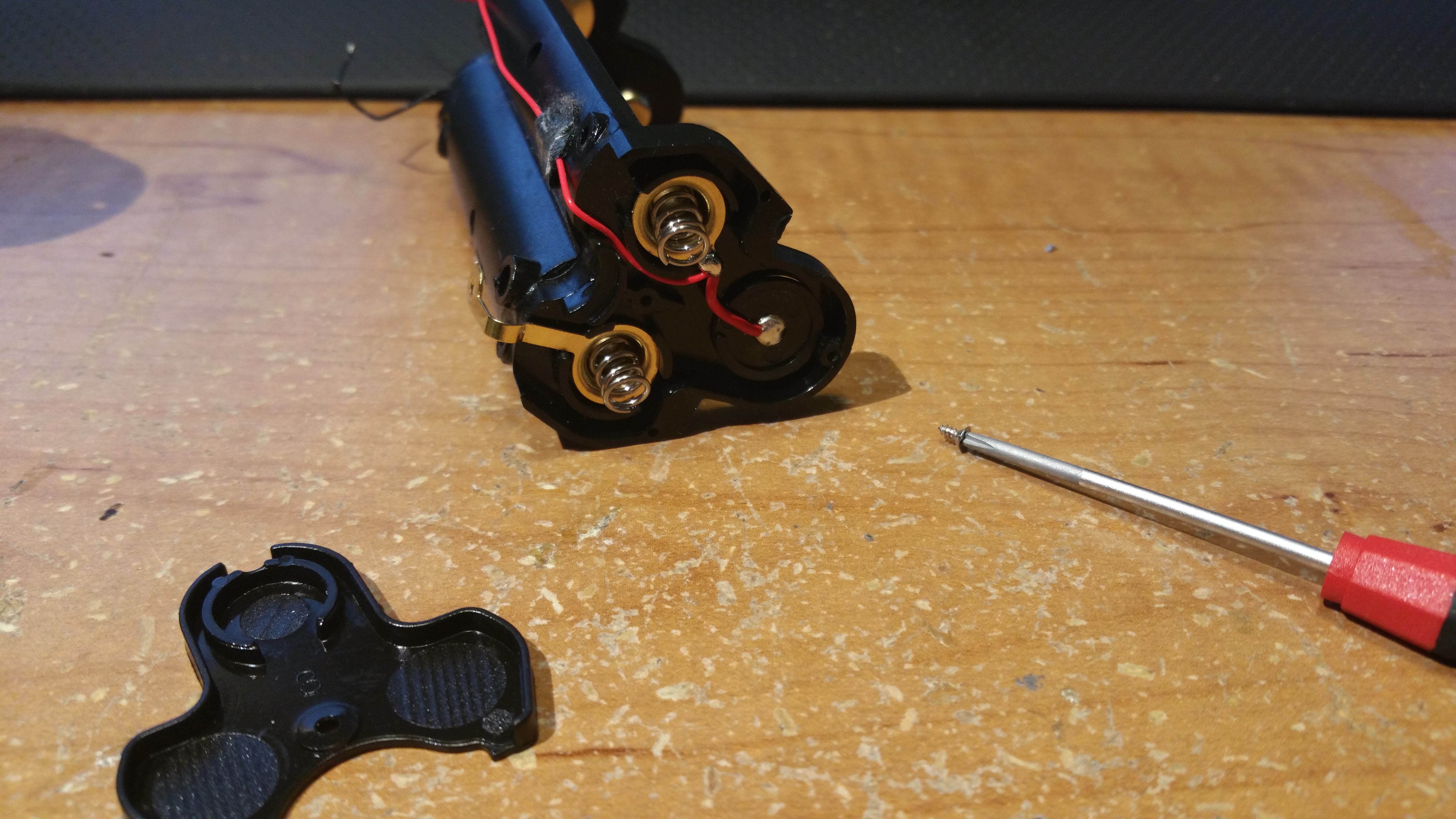

jurdanas Posted January 27, 2016 Report Posted January 27, 2016 After 4 hours of rework.Only change "chips".I have:Working well.

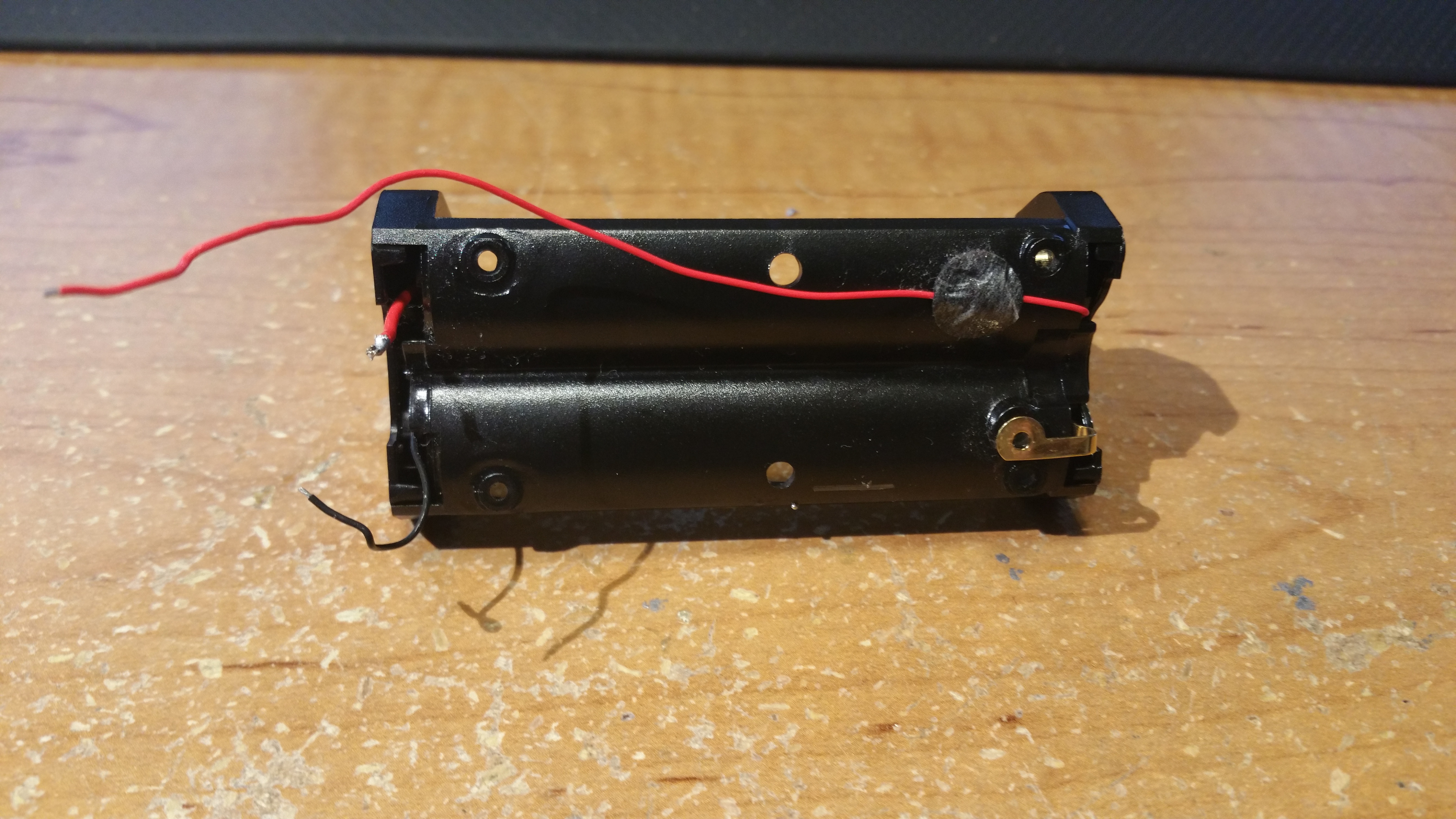

justinizme Posted March 11, 2016 Report Posted March 11, 2016 Does anyone have a picture or a diagram of the stock battery sled? What I mean is how the stock wiring is ran.. I seen in the thread he posted just one side was posted. I need the opposite side. I need a picture/diagram of the side with the "negative" up front(The spring loaded pin).
hackn3y Posted March 16, 2016 Report Posted March 16, 2016 justinizme said:Does anyone have a picture or a diagram of the stock battery sled? What I mean is how the stock wiring is ran.. I seen in the thread he posted just one side was posted. I need the opposite side. I need a picture/diagram of the side with the "negative" up front(The spring loaded pin).This what you're looking for?

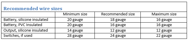

mixvibes666 Posted May 20, 2016 Report Posted May 20, 2016 can anyone pls tell me what gauge wire on the positive battery sled of rx200 i accidentally ripped my off ..please help
VapingBad Posted May 20, 2016 Report Posted May 20, 2016 Sorry no idea, it is not an Evolv board or product maybe try Joytec, but the Evolv recommended wire size for the battery for an DNA 200 is 18 AWG silicon/ptfe insulated or 16 AWG PVC insulated.
