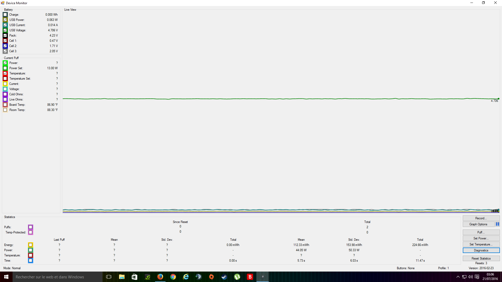

SERUM Posted July 21, 2016 Author Report Share Posted July 21, 2016 Link to comment Share on other sites More sharing options...

Spector NS5 RD Posted July 21, 2016 Report Share Posted July 21, 2016 my best guess SERUM........you have a bad/dead battery. all three cells are way under an acceptable voltage. you could try USB RECOVERY in DIAGNOSTICS - DEVICE MONITOR however, i doubt usb recovery will work. only works with cells above 1 volt, i think. USB charging will not work with a dead battery. Link to comment Share on other sites More sharing options...

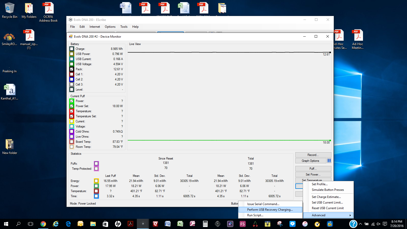

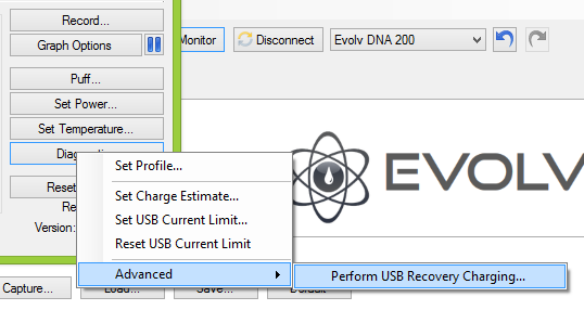

retird Posted July 21, 2016 Report Share Posted July 21, 2016 Essayez d'effectuer de récupération USB en charge sur le moniteur de périphériques. Cliquez sur Diagnostics, Avancé, effectuer de récupération USB en charge.( Try to Perform USB Recovery Charging in the Device Monitor. Click on Diagnostics, Advanced, Perform USB Recovery Charging. ) Link to comment Share on other sites More sharing options...
VapingBad Posted July 21, 2016 Report Share Posted July 21, 2016 The battery has got discharged to below 2.5 V per cell, the battery may be ruined, but you can try a recovery charge from Device Monitor. It may take several attempts as it has a safety time limit, but after all the cells are more than 2.5 V it should charge normally. Link to comment Share on other sites More sharing options...
SERUM Posted July 21, 2016 Author Report Share Posted July 21, 2016 already doneIt does not work Link to comment Share on other sites More sharing options...

VapingBad Posted July 21, 2016 Report Share Posted July 21, 2016 The problem is the battery not the USB, it has been over discharged and it looks like you need to replace it. Link to comment Share on other sites More sharing options...

dwcraig1 Posted July 21, 2016 Report Share Posted July 21, 2016 Cell #1 is really too low for a recovery charge, surely the battery is damaged.A recovery charge will take many many hours, I see that you said that you tried that.Contact seller or Vaporshark Link to comment Share on other sites More sharing options...
