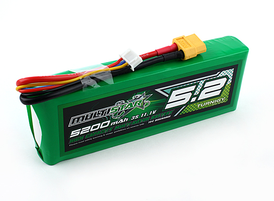

BillW50 Posted July 10, 2016 Report Posted July 10, 2016 If you are looking for big, how about this one? Specs:Minimum Capacity: 5200mAhConfiguration: 3S1P / 11.1V / 3CellConstant Discharge: 10C (52 Amps)Peak Discharge (10sec): 20CPack Weight: 331gPack Size: 142 x 49 x 22mmCharge Plug: JST-XHDischarge Plug: XT60www.hobbyking.com/hobbyking/store/__66475__Multistar_High_Capacity_3S_5200mAh_Multi_Rotor_Lipo_Pack_AR_Warehouse_.html
JaI Haze Posted July 10, 2016 Author Report Posted July 10, 2016 21mm W x 69.5mm length x 25mm D is the max I think becuase the hana is very limited in the room I got

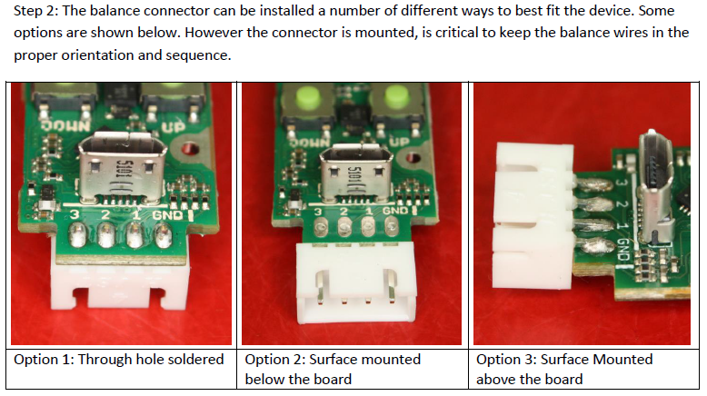

JaI Haze Posted July 10, 2016 Author Report Posted July 10, 2016 ok quick question; I am kind of embarrased but the wiring for the balance connector, if I was to get one of these batteries and wire it up. I see the pos and neg but the other 4 wires that go into the connector, is there a number scheme I could use instead of colors? Maybe I cant do this manually, unless I ask employees to help me out with the colors; its just super embarassing
BillW50 Posted July 10, 2016 Report Posted July 10, 2016 Evolv uses these labels for the balance connector (GND,1,2,3).GND (black)1 = cell 1 (read from GND and 1)2 = cell 2 (read from 1 and 2)3 = cell 3 (read from 2 and 3) [red]
JaI Haze Posted July 10, 2016 Author Report Posted July 10, 2016 ok there is no one that makes a plug and play plug for the lipo balance connector bill? I dont want to make a catastrophic decision. I can solder the black and red to board no problem its just all those other colors. Trianopia color blindness is not on my side here
VapingBad Posted July 10, 2016 Report Posted July 10, 2016 There is no fixed scheme, but identifying the ground and positive should be easy, 99% would be black and red. The plug only goes in one way so as long as you solder the socket on the right way you cannot plug it in the wrong way. The board labels these connections as GND, 1,2,3 if you want a number system.
BillW50 Posted July 10, 2016 Report Posted July 10, 2016 JaI Haze said:ok there is no one that makes a plug and play plug for the lipo balance connector bill? I dont want to make a catastrophic decision. I can solder the black and red to board no problem its just all those other colors. Trianopia color blindness is not on my side hereYes this is a common JST-XH connector. You can buy them at many places. If you need help, just ask.
