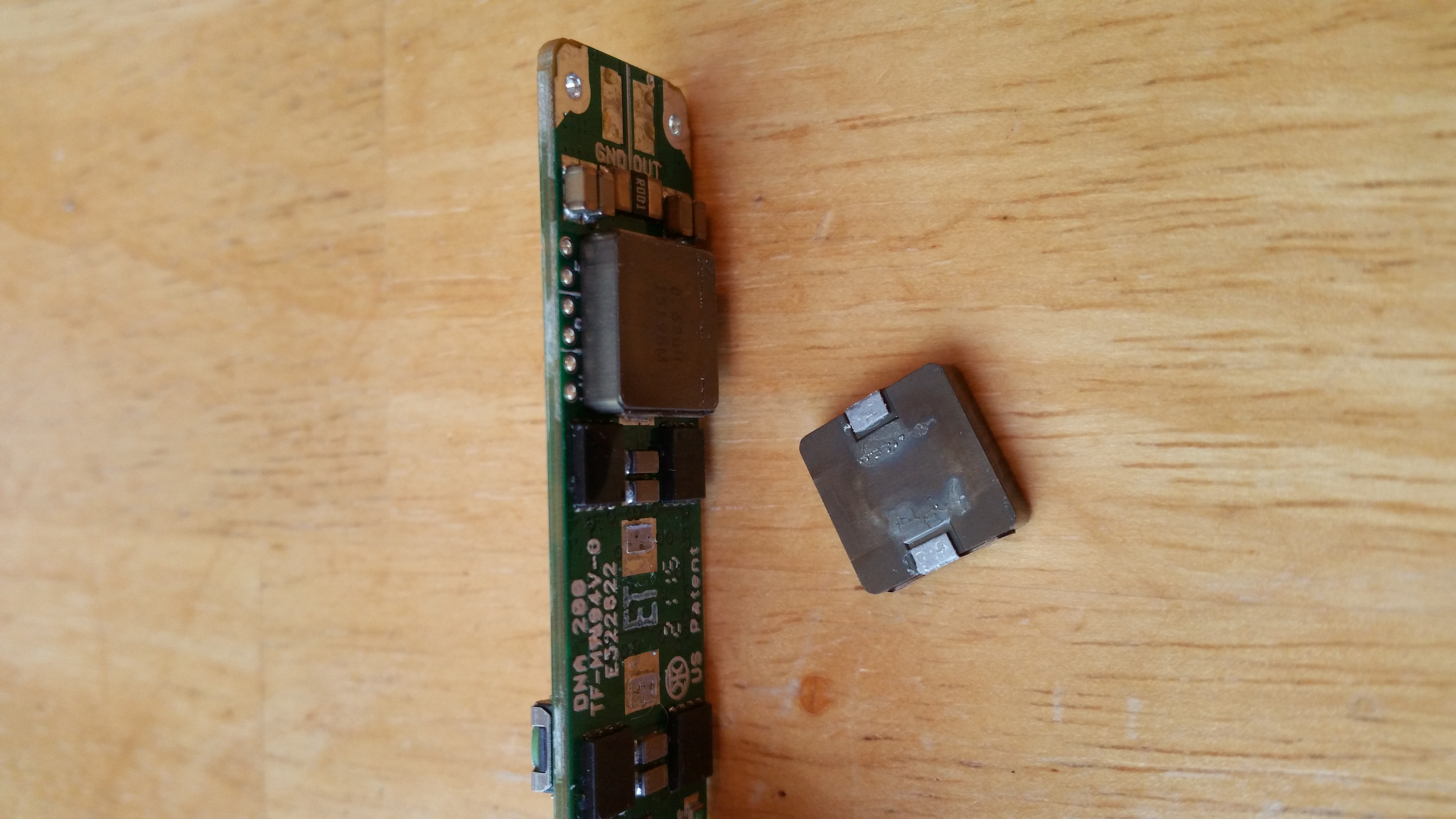

So, I sat the board on the table while working on my enclosure and this happened. It literally fell off...cold solder maybe? Not sure what to do at this point? I could just solder it back but wasn't sure if I'd mess something up. Lol

That does look cold. On the 200, we have to run the boards through the line inductor side first, and the second pass through the oven they're just held on by solder paste surface tension, so we lose a few here. This one probably was loosened up by that, but held on just long enough to get to you and be disappointing.
If you want to try to solder it back on, you're welcome to and if you break it send it in and we'll fix it. If not, just send it in and we'll fix it.

This /\/\/\ is exactly why I'm a fan of Evolv. Thank you for the quick response. I'll give it a go and report back later! Thanks again John
Finally got around to working on it. Happy to report everything is working just fine. Thanks again!

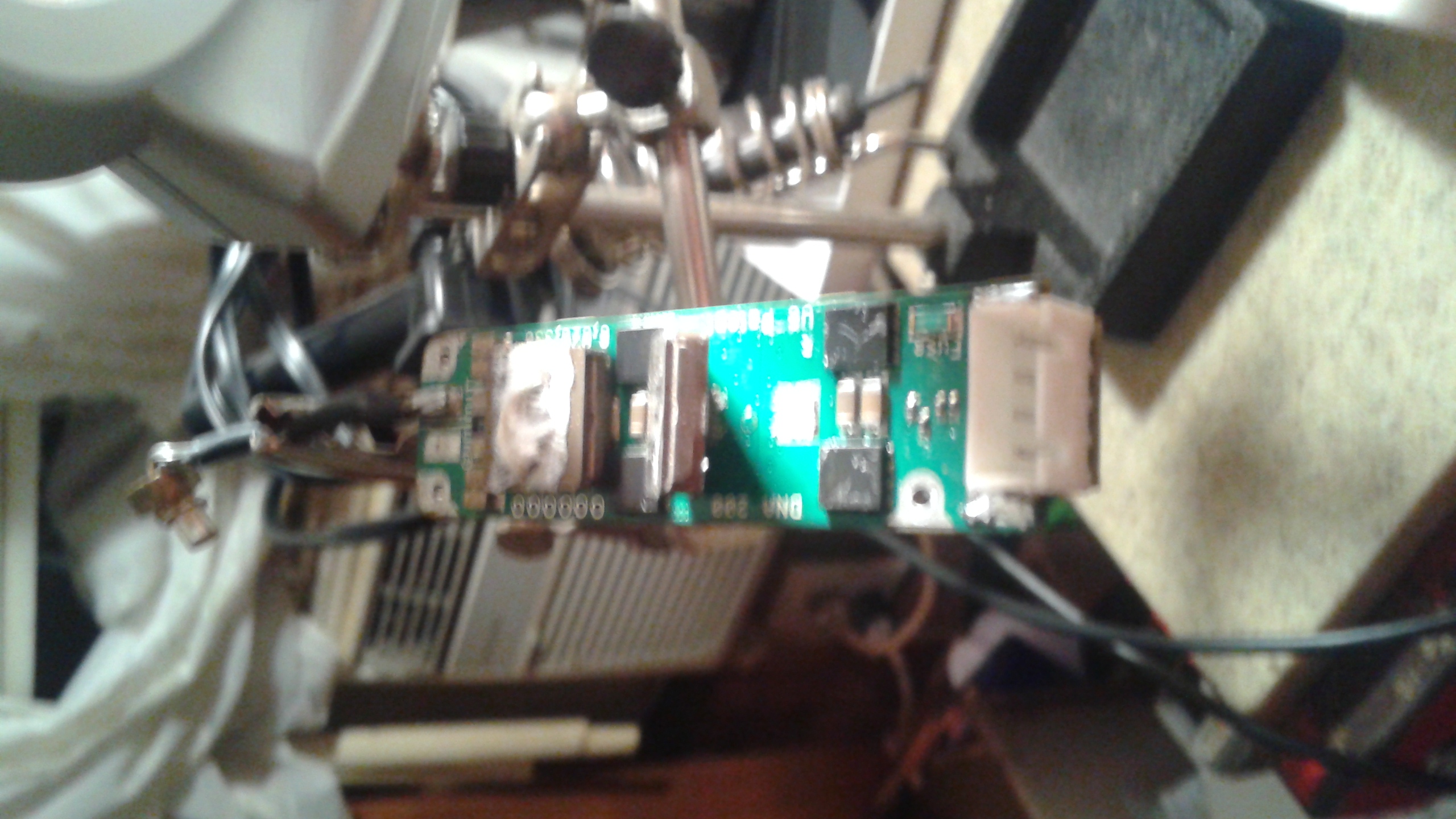

[/QUOTE I have been running in to a problem same area at first I thought it was caused by dropping the mod might be still but I am getting a lot of issues that seem to be linked to this part of the board I do not write what I mean so good I am not trying to say anything bad or imply anything I have one that came loses on one side I have looked at it moved it and other side holding strong I have another board after installing the latest up date gave me short message after a week of run time I reinstalled 2/2016 software it then said check battery so I did it showed on E scrib good equal voltage but when I try to fire it bad voltage drop like a short so I installed new battery board out made-up a test stand to fire board out of box fired it every thing check out good .I was very happy this board is out of my go to all time favorite device. The old battery pack did have 8 months of use so no big deal and well over 360 change cycles still playing / testing I heard something short arc and got warranty message .I got a sick feeling at once fuse did not blow first thing I checked but all around I believe it's called mosfet.I have burn marks and damage so seeing this board is history I start trying to see how much it would take to knock loses this box looking thing that came lose on the other board in a short period. in my very unprofessional opinion it would break the board first .I am so frustrated. @John I have had 4 boards fail 3 in the past 2 months .am i to the point of saying my mec mod is what I am stuck with never being able to enjoy variable voltage variable wattage let alone temperature control / monitoring again and safety ? Or might I find a answer in the DNA 250 I do not need more power I run 120 watts preheat max 1 second 65 watts run 510 max temperature or in kanthal edit add in looking over this post do to my terrible grammar it looks like I am frustrated with John the way I typed it I was trying to tag John like I said not good and putting thoughts down being frustrated dose not help

If it is an inductor that has come off the board then the best advice is to return the mod to the seller or the board to Evolv to fix.

I don't work for Evolv and didn't post anything to you, but there is not a solution other than properly removing and re-fixing the inductor and it's the kind of job where if you need to ask how, best let someone with the right tools do it.  The pads are beneath the inductor, the inductor will act as a big heat sink when soldering and without the right tools it would be too easy to overheat the board or end up with a dry joint.
