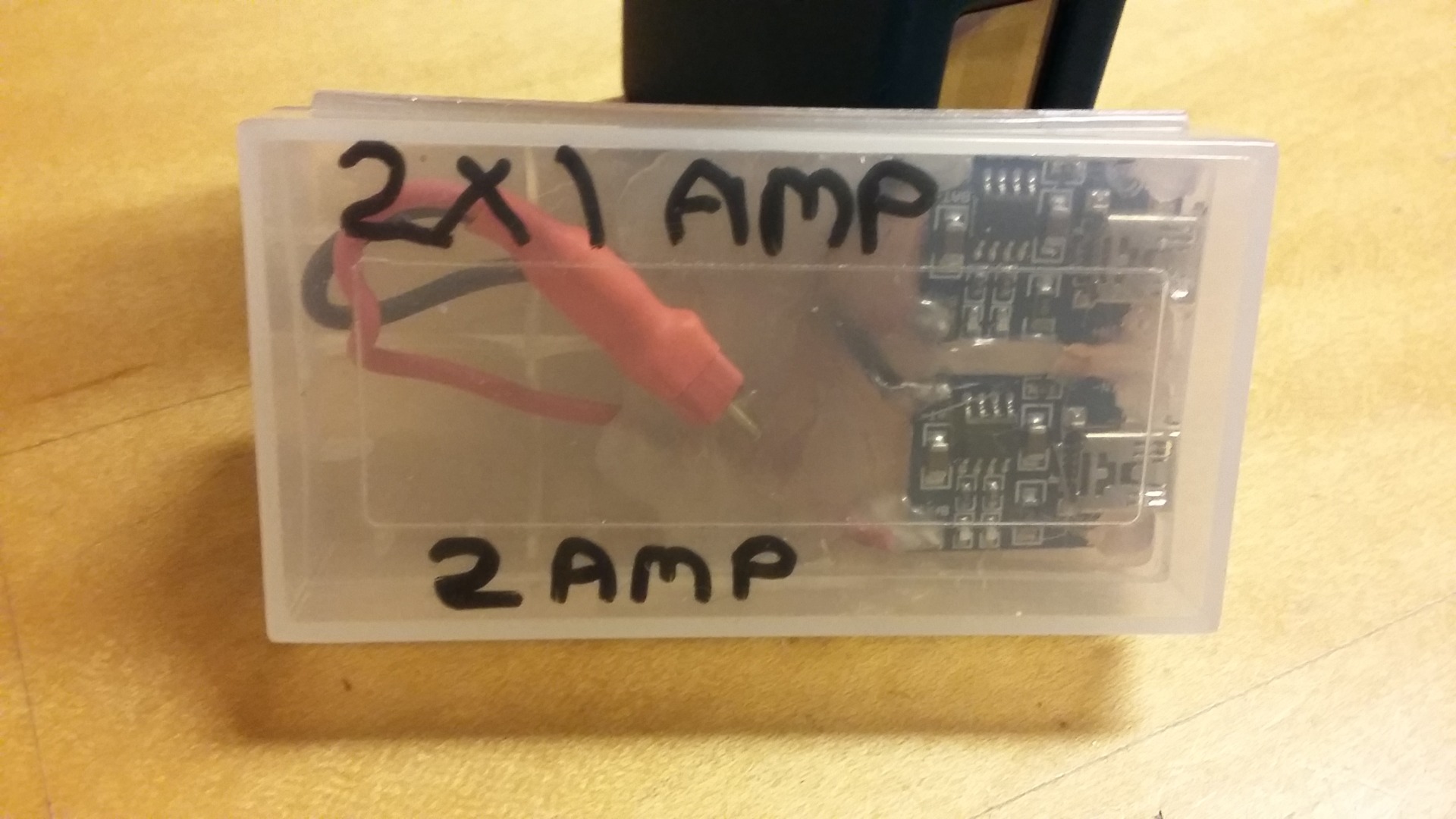

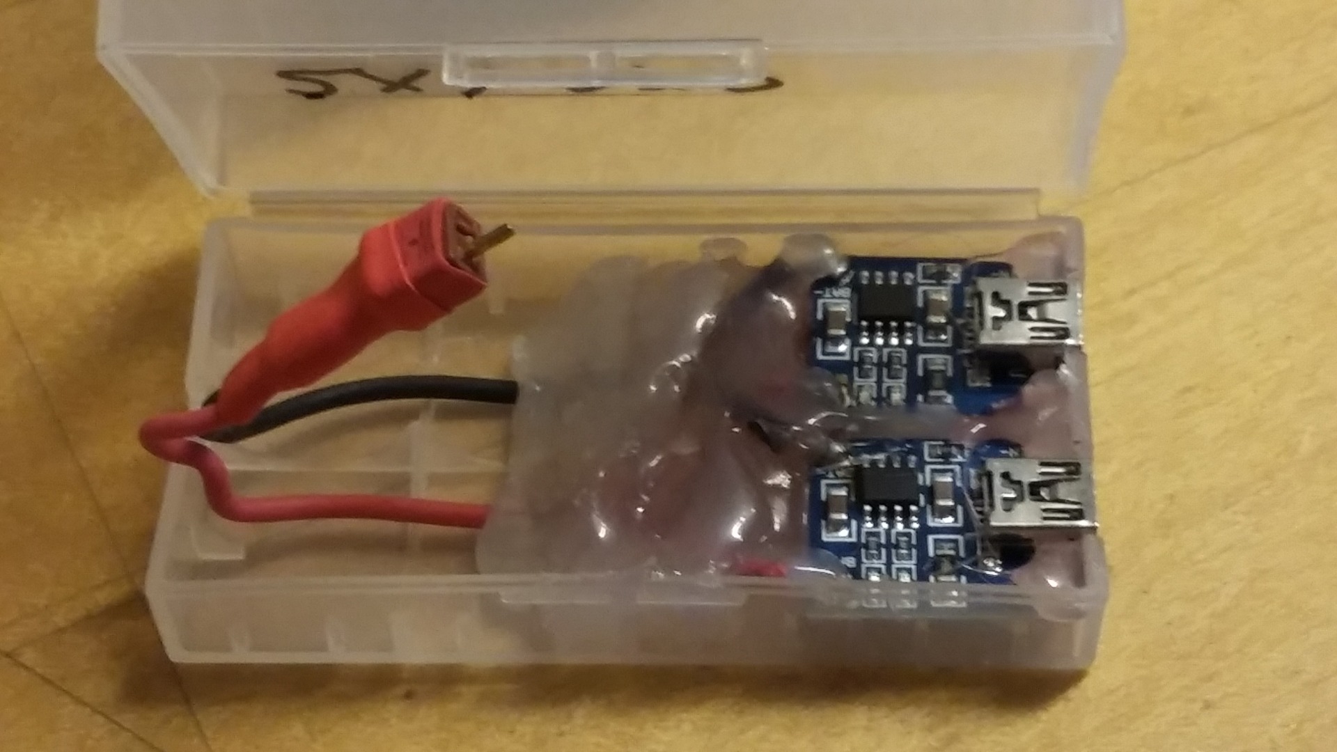

If you reload the video he does show his power source/charger towards the end, a bit too pricey for me now because i have plenty of mods for backup, so wouldnt get used, i do have a small lipo ballance charger, i think its called an Imax B3 and are not very expencive either. The pic above of my homemade, i use it to charge a straight through wooden box mod with paralal 18650's it works fine, and built specificaly with that in mind... quoting vaping bad and the youtube bloke, you only need the one 1Amp charger board for what your doing. I think the RC people burn their way through batteries a lot quicker than us..
