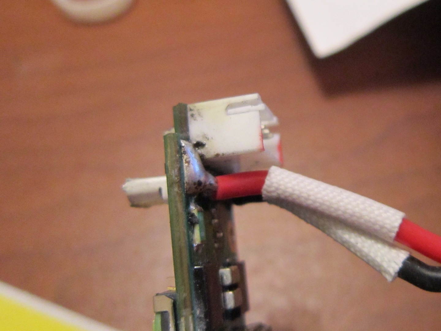

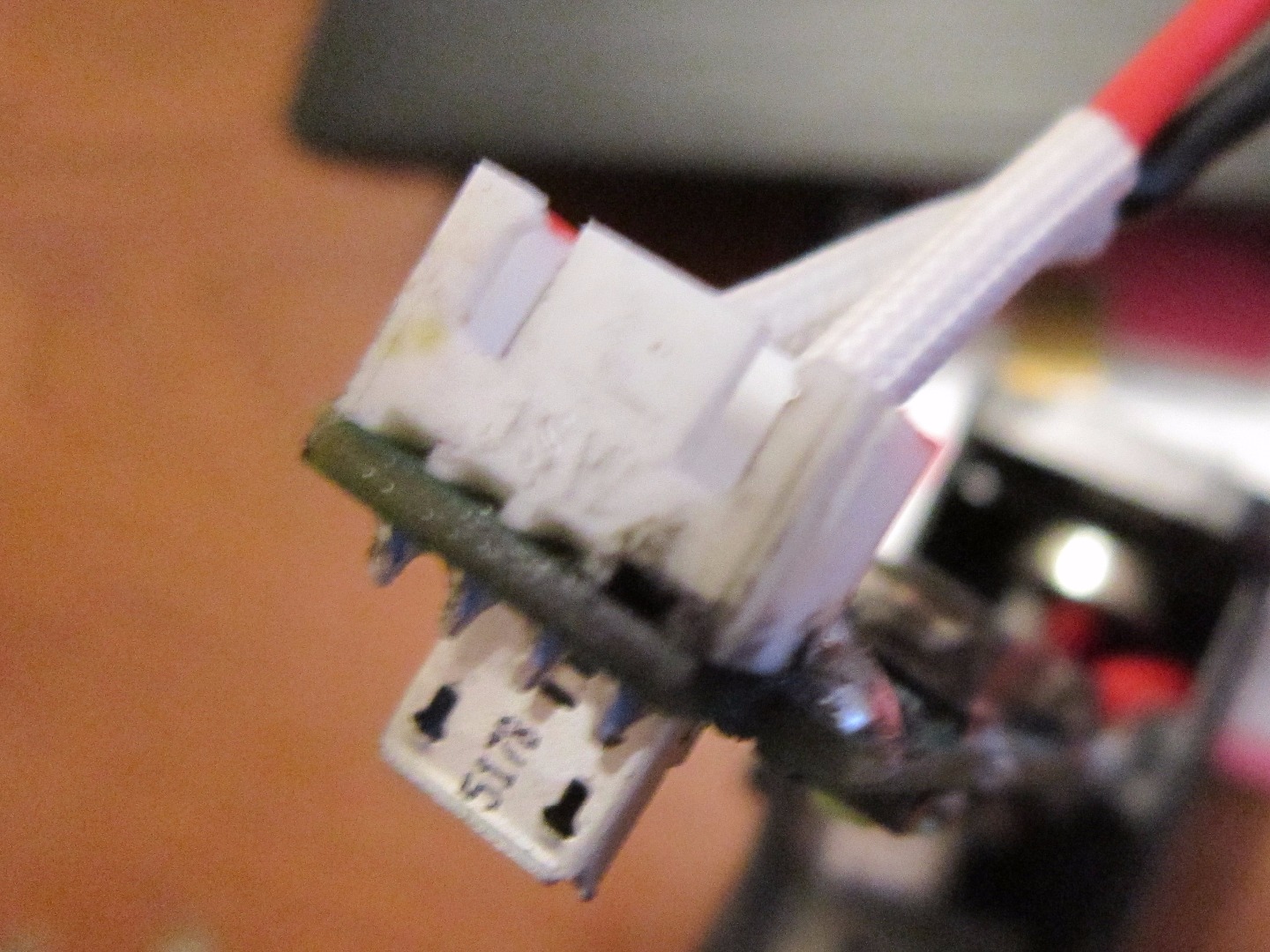

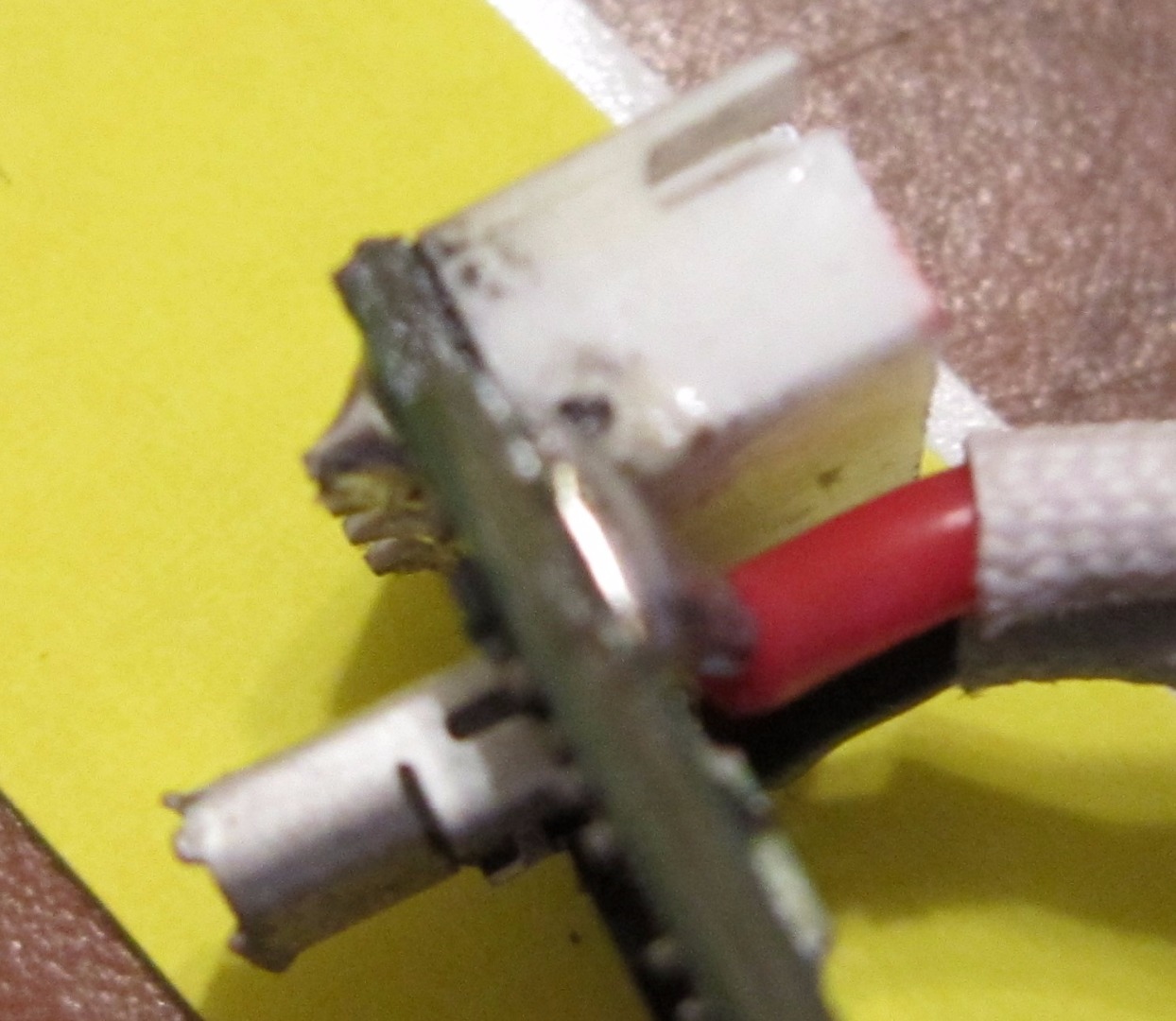

Cincikid Posted August 23, 2016 Author Report Posted August 23, 2016 Ok so I'm having a problems with cell 3 discharging itself. I opened the board housing and this is what i found... See the black stuff? Mabey juice.. Idk. How should i go about cleaning this?
VapingBad Posted August 23, 2016 Report Posted August 23, 2016 Isopropyl Alcohol and an old tooth brush. The best way to clean them is in ultrasonic with the correct detergent but it is not available in small quantities that I can see (do your own research if you want to try this as the wrong detergent or too long can cause damage). 1
wiredl0ve Posted August 24, 2016 Report Posted August 24, 2016 That looks like flux residue that wasn't properly cleaned from the board. Pure rosin flux isn't normally that bad, but you have no way of knowing what type of flux that is and it looks like the flux was burned. There also looks to be some melting on the jst connector where the tip of the soldering iron was pushed against it while either soldering or re-flowing the solder on the positive battery pad and I'm not even sure what the chunk is by the fuse, but I'd get that cleaned off too. I usually use everclear(or any PGA) to clean flux by applying some to a brush and the rest of the bottle to me. I'm not sure if the PCBs ever come clean, but I'm too drunk to care at that point.
Cincikid Posted August 24, 2016 Author Report Posted August 24, 2016 Finally got to it. The iso and toothbrush seem to have done the job.Yesterday morning I cleaned the board and put my battery (c1-4.18, c2-4.18, c3-3.99) on the charge... I noticed steady (if slow) improvement throughout the day.. This morning i'm siting at 1c-4.20, c2-4.20, c3-4.15.Too soon to be certain but i'm pleased so far.If i ever have to clean the board again i will definitely have to try wirdl0ve's method.Thanks again guys. This forum is awesome!
