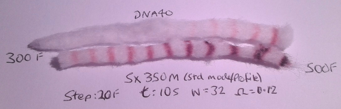

IMO the cotton scorch test is great as long as you ridgy stick to a set fire time and the same brand cotton, I use 10 seconds as it should more than compensate for heat up time, let alone humidity or cotton water content, which I don't think is an issue personally.  Done like this you get a clear graduation, I like doing 20 F steps, sometime 10.  This is an old pic of Ni200 on a DNA 40, ignore the bottom one for the SX Mini that thing was way way off, the point is you have many degrees of scorch so if you use a new wire make a Ni coil of the same geometry and test both like this, then refine your TCR for the new wire. Note that only went up to 500 F as the SXM had set fire to the cotton, with a DNA I would up to 600 F and the shade is different for each temp, sorry I should do an up to date pic.
