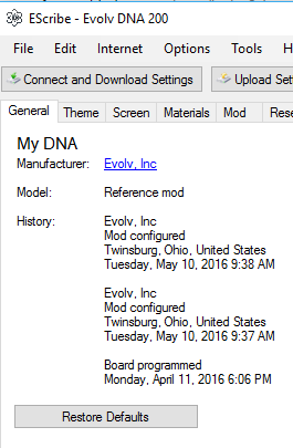

retird Posted September 26, 2016 Report Posted September 26, 2016 You can click on "Get Information" In the General tab under "My DNA" of EScribe. There is info about your DNA board there that may help in when the board was programmed and etc.Example:

2legsshrt Posted September 26, 2016 Author Report Posted September 26, 2016 This is all the info that was available on that screen
retird Posted September 26, 2016 Report Posted September 26, 2016 Yep not much info.... but board programmed in December of 2015...I deleted your double post as it was redundant.... hope ya don't mind....
2legsshrt Posted September 26, 2016 Author Report Posted September 26, 2016 Nope I just put it there to get your attention. Yeah it had under manufacturers settings at the bottom part were either 100 or 0. Steve gave me what he got off of his when he measured it so now it is all up to date there. They had the Kanthal limit at 100 everything was just probably like it came from Evolve. 0 case resistance now set to .004 and all the other numbers set to what he got after measuring.
