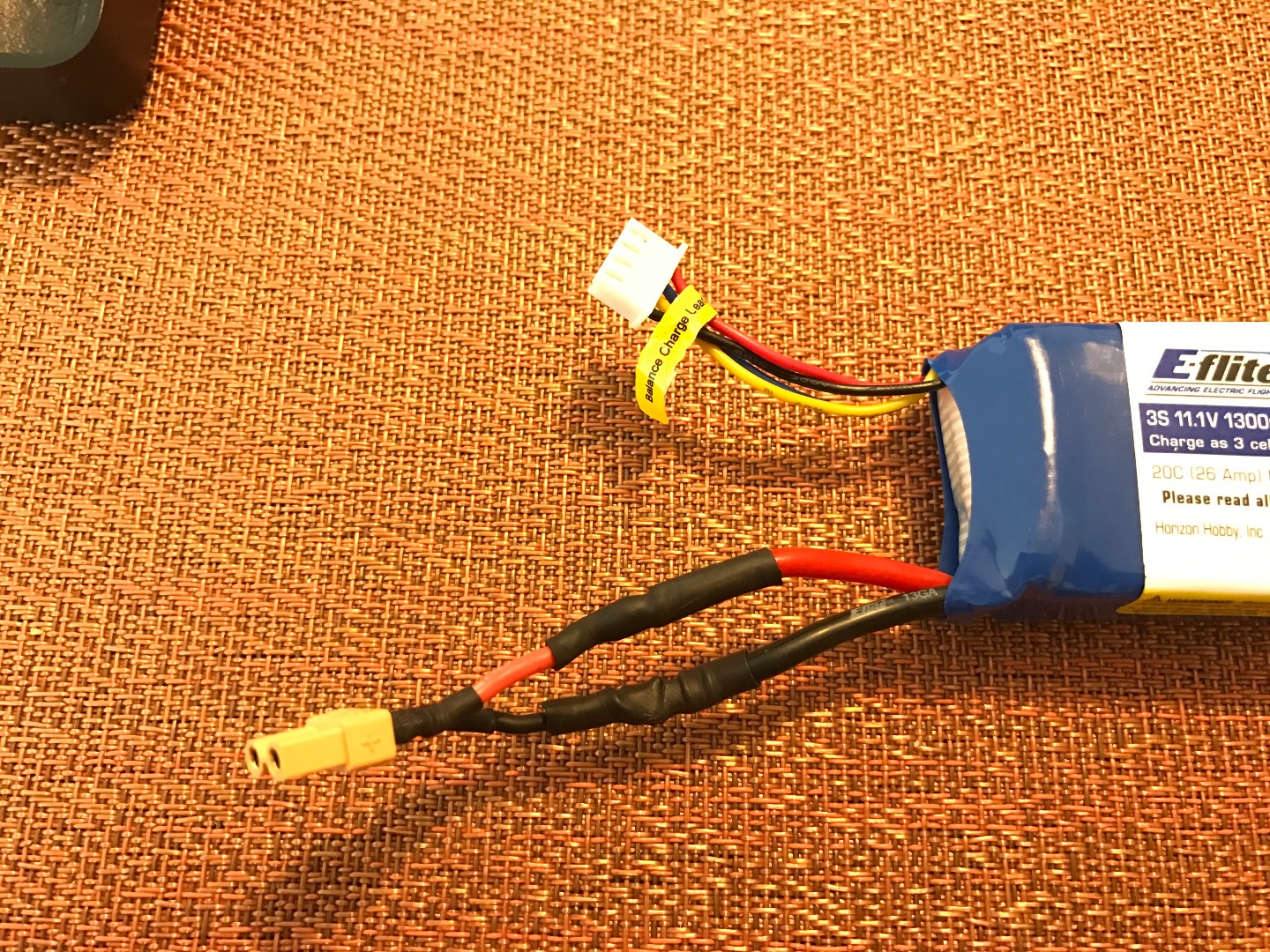

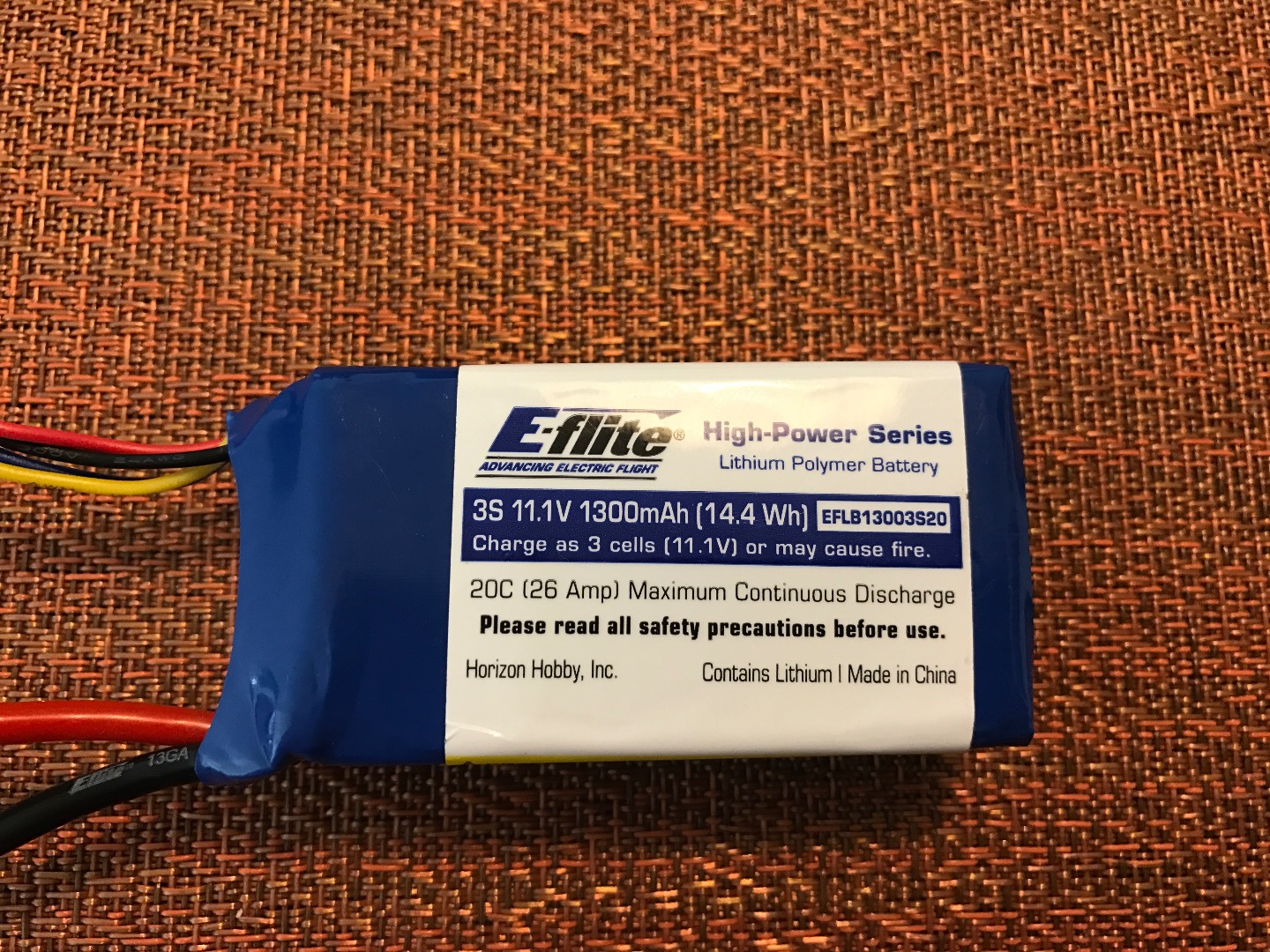

jamtwo Posted November 4, 2016 Author Report Posted November 4, 2016 VapingBad said:It takes a while, that cell is in a state where they can't use the usual charging method. see here 37 mins, he name checks some looser thoughhttps://www.youtube.com/watch?v=lxP0FFnF2-8&feature=youtu.be&t=2221 So one last question for yah VapingBad. I bought a new lipo for it, the other didn't seem to be salvageable. I managed to find another 1300mAh lipo, also 3s, same 11.1v, but the replacements look to mostly be a 25c-50c discharge rate, this one is 20c (25c max). Any idea if this will be safe to run?
awsum140 Posted November 4, 2016 Report Posted November 4, 2016 The DNA200 draws about 30 amps at max output if I remember correctly. Assuming you don't run it that high a 20C should be fine especially considering that vaping is essentially a pulse of current rather than true continuous current.

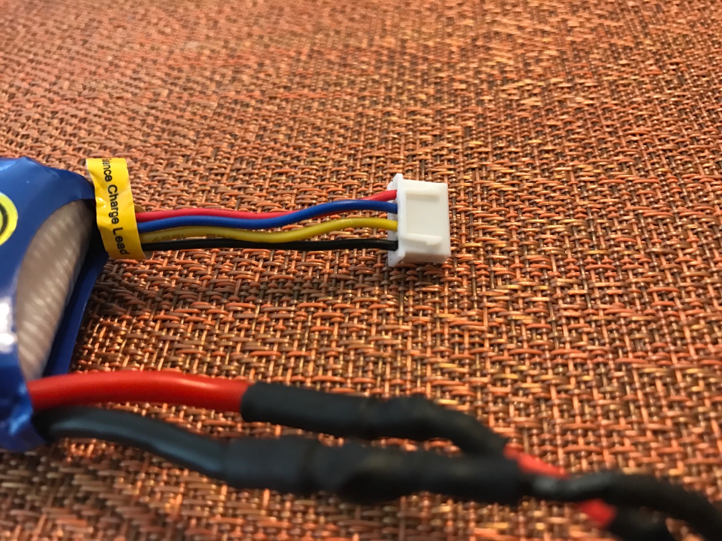

VapingBad Posted November 5, 2016 Report Posted November 5, 2016 Having a higher C rating battery is fine, I would test the battery you found with a 3S battery tester or multi metre first to check it is wired correctly it is not unheard of that they connect cells in the wrong polarity or reverse the balance connection.

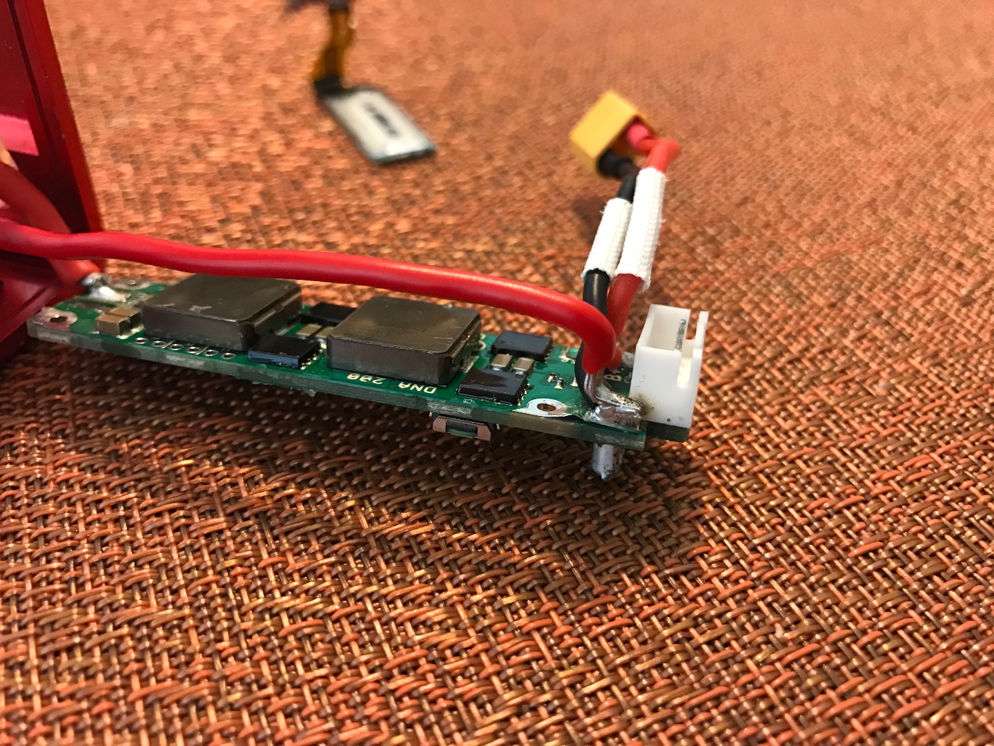

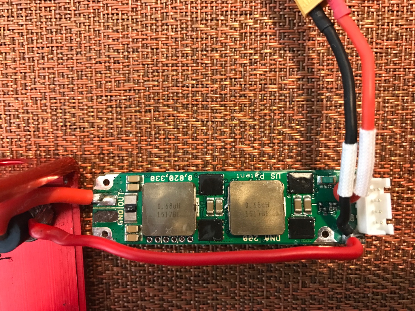

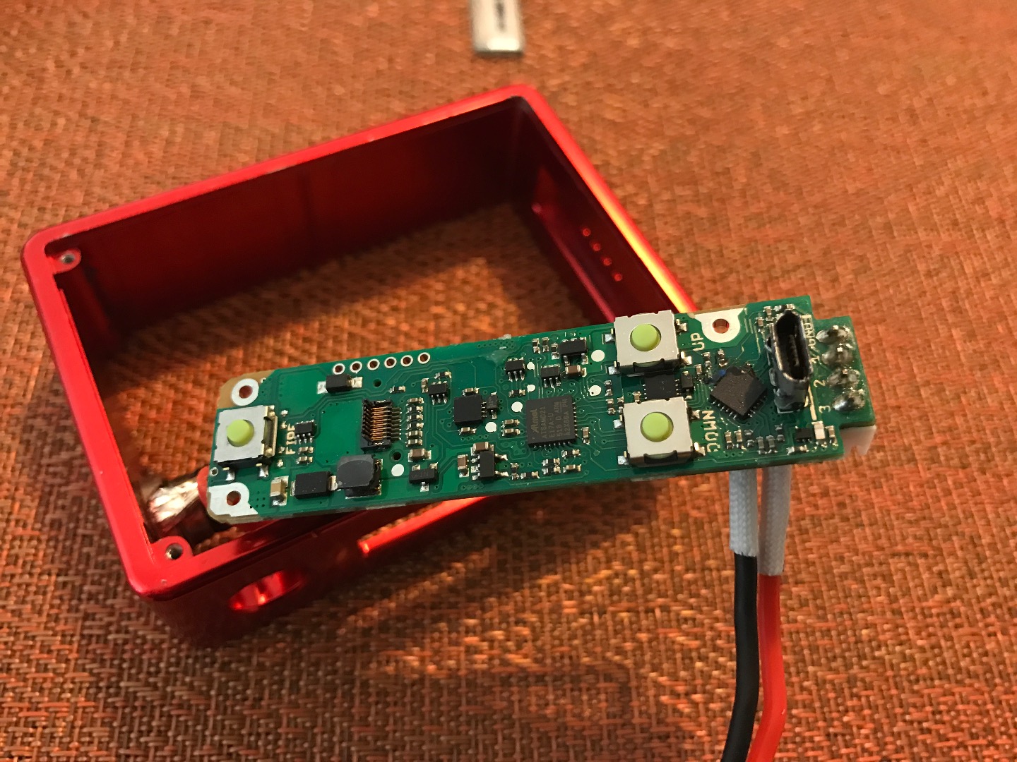

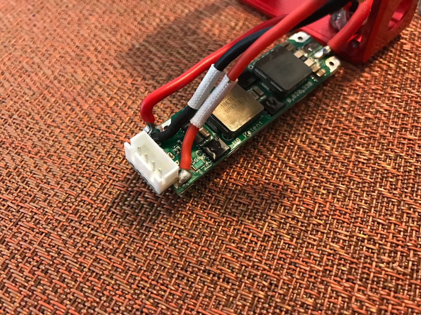

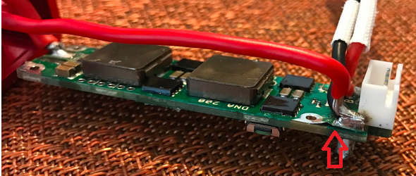

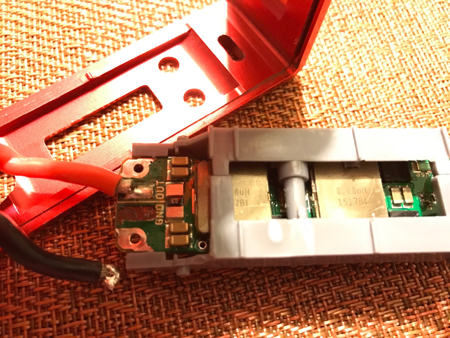

retird Posted November 5, 2016 Report Posted November 5, 2016 @jamtwo, I've seen, many times, where Evolv has replaced boards that were damaged by the end user during installation, or even out of warranty, even though it was not covered by the warranty. I understand your frustration but can't agree with your evaluation of Evolv as a company and their product(s). Can you post pictures of your build showing only the board (front and back) and the wiring as we may be able to do a bit of long distance visual troubleshooting and possibly assist you. I do see cold solder joints and a missing ground pad in your post 1 picture. A picture of the battery and the attached connector (s) would be helpful also.Lots of folks here that really try to help .......

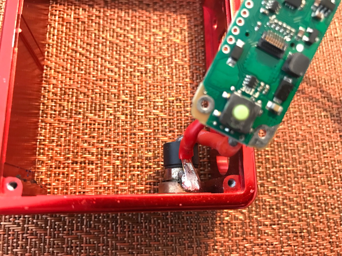

jamtwo Posted November 5, 2016 Author Report Posted November 5, 2016 Here are some photos of the second chip. I appreciate the help from the members of this forum. I'm glad to hear of others great experiences with the company, it just rubbed me wrong when the response from Evolv was to pass the buck onto someone else.
awsum140 Posted November 5, 2016 Report Posted November 5, 2016 I'll leave the solder evaluation to Retird, he's got eyes like a hawk!Did you use a voltmeter to check the balance connector on the battery to make sure it is set up in the right sequence and that red is truly positive power on the main power connections?If you soldered on that ground lead to the 510 did you check for a short in it after soldering?Not trying to be a smart guy, just looking for the obvious first and I've "been there and done that" myself.
VapingBad Posted November 5, 2016 Report Posted November 5, 2016 You have lifted the battery negative pad, you should never put the strain of bending wires on solder pads, especially these very thick wires. Always bend the wire to it's final shape before soldering, you can get more flexible wire with finer strands, but if the solder wicks up the wire it will still become stiff. Also holding the heat on for too long can cause the pads glue to melt. You may get away with connecting to a mounting point, but you may have damaged some of the nearby tracks.
jamtwo Posted November 5, 2016 Author Report Posted November 5, 2016 VapingBad said:You have lifted the battery negative pad, you should never put the strain of bending wires on solder pads, especially these very thick wires. Always bend the wire to it's final shape before soldering, you can get more flexible wire with finer strands, but if the solder wicks up the wire it will still become stiff. You may get away with connecting to a mounting point, but you may have damaged some of the nearby tracks. That pad lifted after the fact. When I initially jumped the 510 ground to it, the pad was still good and it was still not functioning.
jamtwo Posted November 5, 2016 Author Report Posted November 5, 2016 VapingBad said: Yeah I understand what you were talking about, when I soldered that 510 wire on, the ground pad was still secure to the board and it was still not registering any kind of battery.
