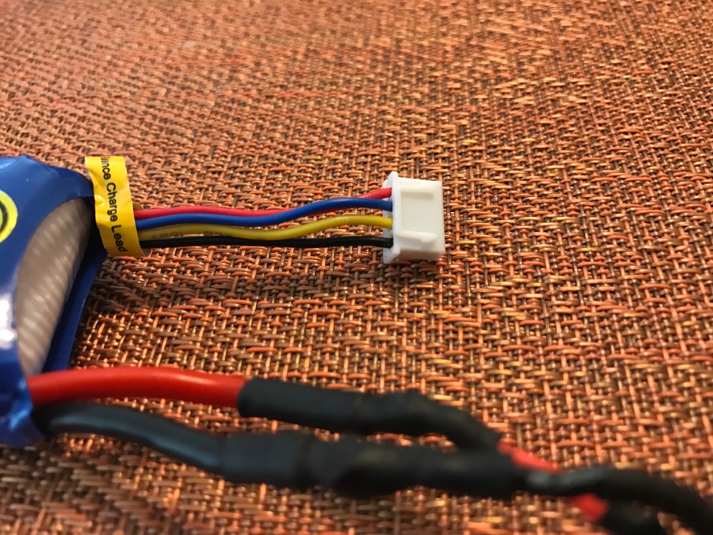

So one last question for yah VapingBad. I bought a new lipo for it, the other didn't seem to be salvageable. I managed to find another 1300mAh lipo, also 3s, same 11.1v, but the replacements look to mostly be a 25c-50c discharge rate, this one is 20c (25c max). Any idea if this will be safe to run?

I appreciate all the help. It looks like cell 1 is only reading out at 1.3v but the recovery charge doesn't appear to be doing much.
Thank you so much, I did this and it appears to have worked. On to a separate issue now though unfortunately. So I put it all back together, threw it on the charger and it seemed to be charging intermittently. I plugged into my PC and ran escribe, did a hard reboot, updated the battery settings to 1300mAh and now it doesn't look to be charging at all. I did get the "imbalanced battery" alert a couple times. I would guess that maybe the battery is shot due to sitting for roughly 4 months not being charged or used? I know LiPo packs can get finicky when they're stored. Does this sound like a fair guess?
