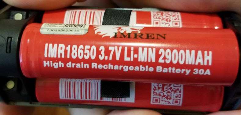

I am pretty new to all of this, but I am using the Triade with a SmokTech TFV8.
I currently have 3 IMR 18650 3.7V High drain 30A 2900MAH installed as recommended by the shop I purchase the Triade from.
 I am running .15? coils and vaping around 120-130w. As the battery levels drop down to around 50% I start getting low volt messages unless I lower the wattage down, eventually I get it again and need to lower the watts again to be able to continue to use it.

If i am not mistaken, batteries are in fact 2500, not 2900mah, although a sticker may be on the batteries stating they are, there not.
There is a balance between amps and mah.
for batteries with high amps, eg 30amp, the mah will be lower such as 30amp 1500mah, batteries with higher mah such as the 30Q's, they are 3000mah with 30amps, they both cant be high each end.
So, i would setup your batteries in escribe as 11.1v with 2500mah, for more accurate batterie measuring, run the analyser, takes about an hour but will be a accurate reading and will also create a battery profile for you at the end.
As for needing to drop wattage as batteries drop volts, that is normal, the DNA board is limiting its self to keep you and your batteries safe, if it cant pull the amps and get the amount of volts needed for the wattage, it will drop to what it can.
i would suggest in getting better batteries tbh, such as Samsung 25R's or 30Q's

welcome to the forum, mudbubble. what brand are these 2900mah 30 amp cells? reason i ask is because there are NO real 2900mah 30 amp cells available on the market. you most likely have some re-wrapped cells with inflated ratings. what message are you getting? there is no "low volt" message. weak battery? check battery? probably the weak battery message. it's because of the not so great re-wrap cells you are using and an incorrect (too high of a number) cell capacity value input EScribe's battery settings. as for it taking along time to charge, sounds like you have the DNA 200 version and  not the DNA 250 (which has 2 amp charging. DNA 200 only has 1 amp).
i would get a good set of non re-wrapped cells then go into EScribe and adjust your battery settings. here's a list of recommended cells by Battery Mooch... (any cell from 20-25 amp would be good for the DNA 200. i really like the Sony VTC5A cells. they're great all around cells.)

They are IMREN. Got them at Beyond Vape when I picked up the mod.

samsung 25r5's (the green samsung 25R) will be better performers than those imrens you're using.
