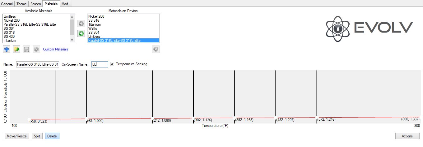

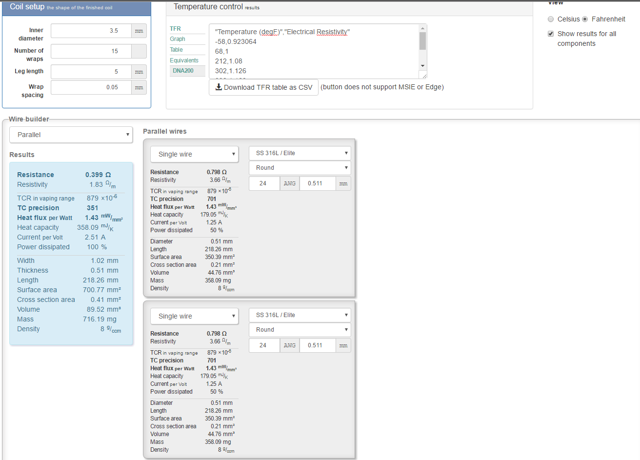

uberbdon Posted January 12, 2017 Author Report Posted January 12, 2017 First post here, hello I decided to create a custom profile for my dual coil Limitless Plus which I have set up with a set of paralel SS316L coils. I created a profile on steam engine and the CSV came out as this:[CODE]"Temperature (degF)","Electrical Resistivity"-58,0.92306468,1212,1.08302,1.126392,1.168482,1.207572,1.246800,1.3369666667[/CODE]I created a profile using that CSV and when I select it on my mod (Los Vape Triade), it shows degrees, but it also shows volts on the main display. I have temperature mode set up to show watts and degrees, not volts. There appears to be no temperature control used at all when I use this profile. It just burns and burns, no temp limiting at all.I have some screenshots of my settings in Escribe and am hoping someone can identify what's going wrong.Thanks in advance! If any other information is needed just let me know.

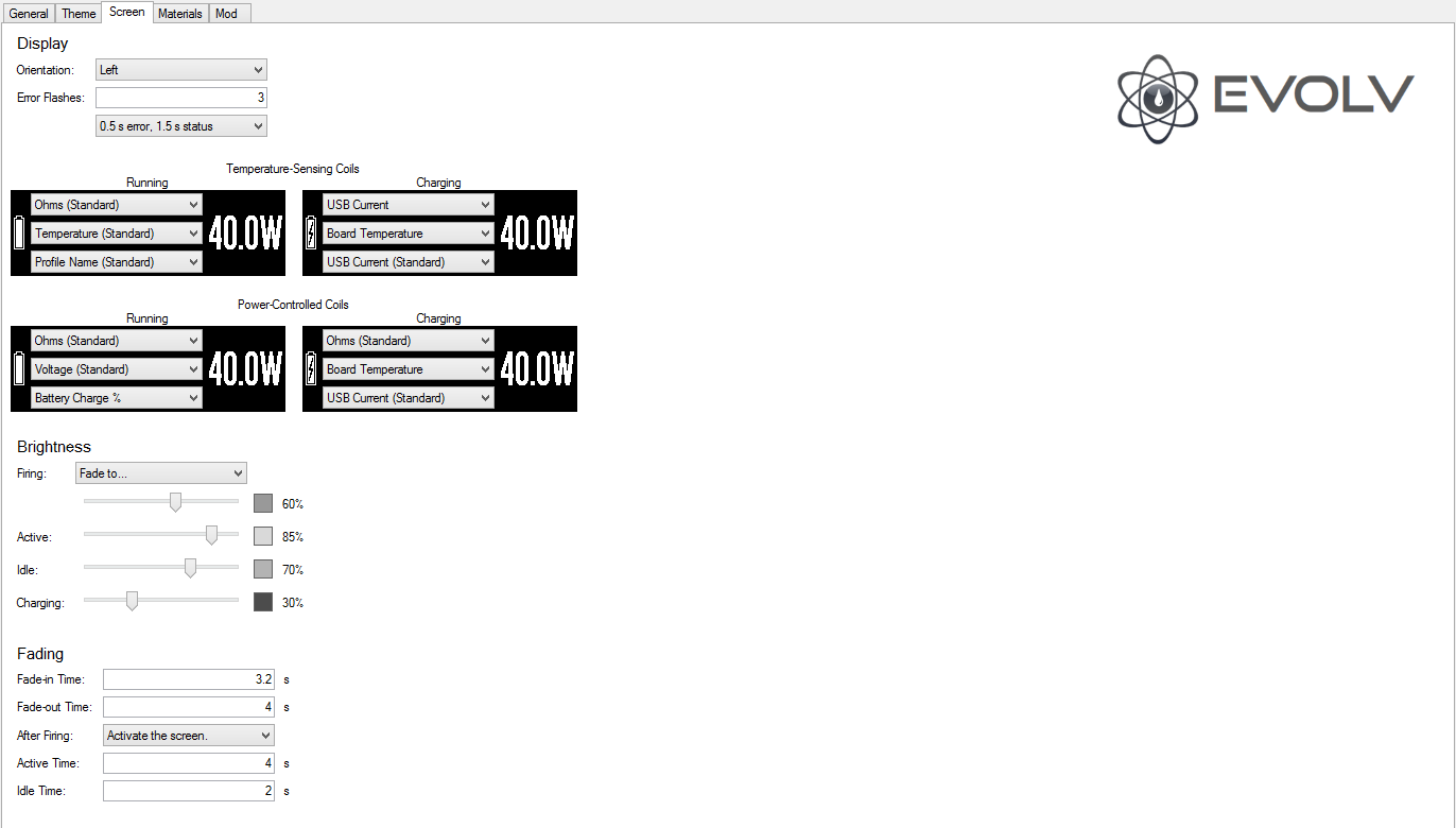

retird Posted January 12, 2017 Report Posted January 12, 2017 The device is not seeing your coil as a TC type coil. It is vaping in power mode and in power mode while running it is set to display volts.What type of material are you using to build your coil and what type coil are you building (standard, clapton, fused, etc.)?

uberbdon Posted January 12, 2017 Author Report Posted January 12, 2017 retird said:The device is not seeing your coil as a TC type coil. It is vaping in power mode and in power mode while running it is set to display volts.Something that's odd is when using the profile, it shows volts, but the main stat it's showing (in the big letters) is the temperature.

retird Posted January 12, 2017 Report Posted January 12, 2017 Can you post a Device Monitor screenshot showing Power, Power Set, Temperature, Temperature Set, Cold and Live ohms? Each coil you have is almost 0.8 ohm's?Have you tried using a default profile for SS316L?

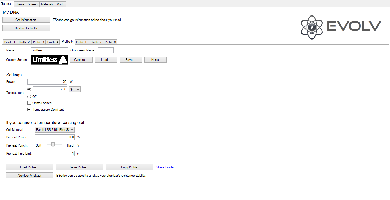

retird Posted January 12, 2017 Report Posted January 12, 2017 uberbdon said:Something that's odd is when using the profile, it shows volts, but the main stat it's showing (in the big letters) is the temperature. You have Temp Dominant checked in your profile thus Temp is displayed.

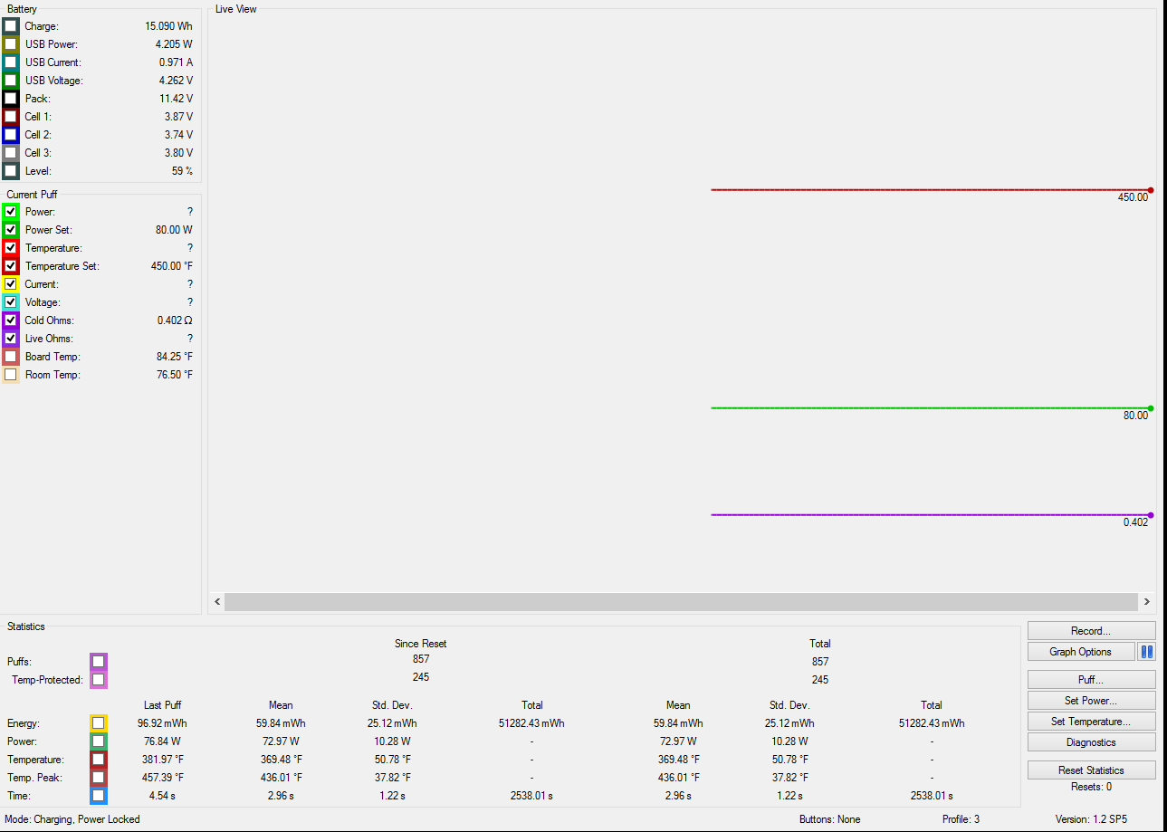

uberbdon Posted January 12, 2017 Author Report Posted January 12, 2017 retird said:Can you post a Device Monitor screenshot showing Power, Power Set, Temperature, Temperature Set, Cold and Live ohms? Each coil you have is almost 0.8 ohm's?Have you tried using a default profile for SS316L?It doesn't seem to be detecting a temp. at all
VapingBad Posted January 12, 2017 Report Posted January 12, 2017 I think retird meant a pic while you are vaping and it not doing what you expected.

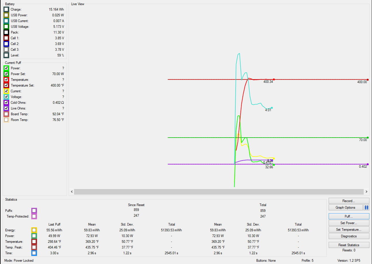

uberbdon Posted January 12, 2017 Author Report Posted January 12, 2017 retird said:Can you post a Device Monitor screenshot showing Power, Power Set, Temperature, Temperature Set, Cold and Live ohms? Each coil you have is almost 0.8 ohm's?Have you tried using a default profile for SS316L?Here we go:Oddly it appears to be working now... I'm at a loss

retird Posted January 12, 2017 Report Posted January 12, 2017 If your coils are contact coils try spacing them also... 15 wraps per coil is a lot of wraps.

Wayneo Posted January 12, 2017 Report Posted January 12, 2017 How can you be at a loss. Your first Device Monitor shot showed you were in Profile 3, your second (which matches with your profile setting 5) shows it works.Edit: excellent screen captures. Makes helping so much quicker.Beautiful solid TC you got there
