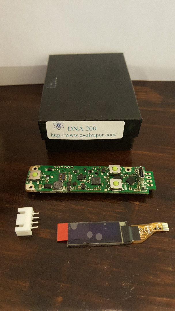

Smeef Posted January 26, 2017 Author Report Posted January 26, 2017 So I just got a replacement 200 from Evolv and the board itself is a 250. When hooked up to Escribe it reads as a 200.Has anyone seen this yet? Wondering if the did away with the old board seeing that the 250 is a bit more robust.

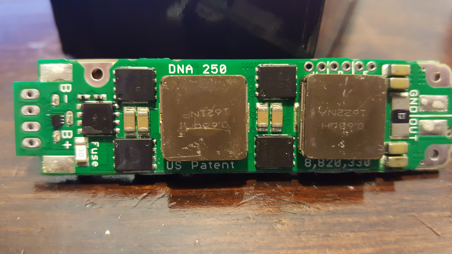

Smeef Posted January 27, 2017 Author Report Posted January 27, 2017 I'm not really sure what you intend for me to gather from that thread. I read that earlier. You mentioned someone possibly mis-labeling a board so I posted a pic to show that it's more than just a mis-labeled board. The layout and components match that of a 250.

Smeef Posted January 27, 2017 Author Report Posted January 27, 2017 That is what I'm thinking yes. I sent them a 200 and got a box with a 200 label on it, but the picture I posted is what was inside. Everything in Escribe points to a 200, while looking at it points to a 250.I'm not quite sure what that person in that thread really had to do. I swapped out a Hobo X DNA200 with a 250 board and had to modify nothing. It could just be whatever mod he had, the makers had some type of screen mount that attached to the board itself which yes, there would be extra bits in that area.I'm not unhappy by any means. Just curious if this is a way for them to phase out the 200. Replace all old 200's with a 250 and leave it up to the end user with a firmware update.
Spector NS5 RD Posted January 27, 2017 Report Posted January 27, 2017 that's a 250 board. at least the hardware layout is that of a DNA 250. post a pic of the front. that will tell me a lot more than just a pic of the back. that will also tell me what charging circuit it has. it can be possible you have the incorrect firmware on the board, your setting in EScribe are incorrect (kanthal limit, USB charge current limit) who knows. i don't see why evolv would send you a 250 limited to 200w, the 200 was not discontinued. although it is a direct drop in replacement for the 200, the 2a charging components make it necessary to modify the screen holder of many mass produced mods in order for a correct fit.
Smeef Posted January 27, 2017 Author Report Posted January 27, 2017 That's the only one I have of the front. It's in the mod now.
Spector NS5 RD Posted January 27, 2017 Report Posted January 27, 2017 ya that's 100% a DNA 250 board. you see the component (inductor) on the front marked "4R7"? that is one of a few new components, only on the DNA 250, responsible for the 2a charging. if you go into EScribe, the USB current, on a DNA 250, should be limited to 1a and .5a for a DNA 200. do you see 1a? post a screenshot of device monitor with the USB voltage and current boxes ticked. also post a SS of your battery settings. this is interesting me.

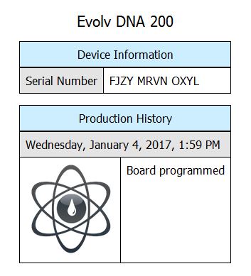

Smeef Posted January 27, 2017 Author Report Posted January 27, 2017 Also this is what I get when I retrieve the device information.
