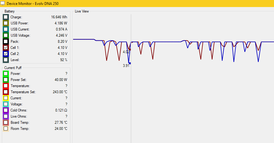

My batteries are pretty low at the moment, 11%, but on idle they both show 3.33
When i press the fire button and get the "Check Battery" error the voltages for both cells drops to 3.12 briefly then back up to 3.23 then in a jaggered fashion back to 3.33.
But I do get this error with fully charged batteries as well, actually all the time regardless of what batteries and charge state.

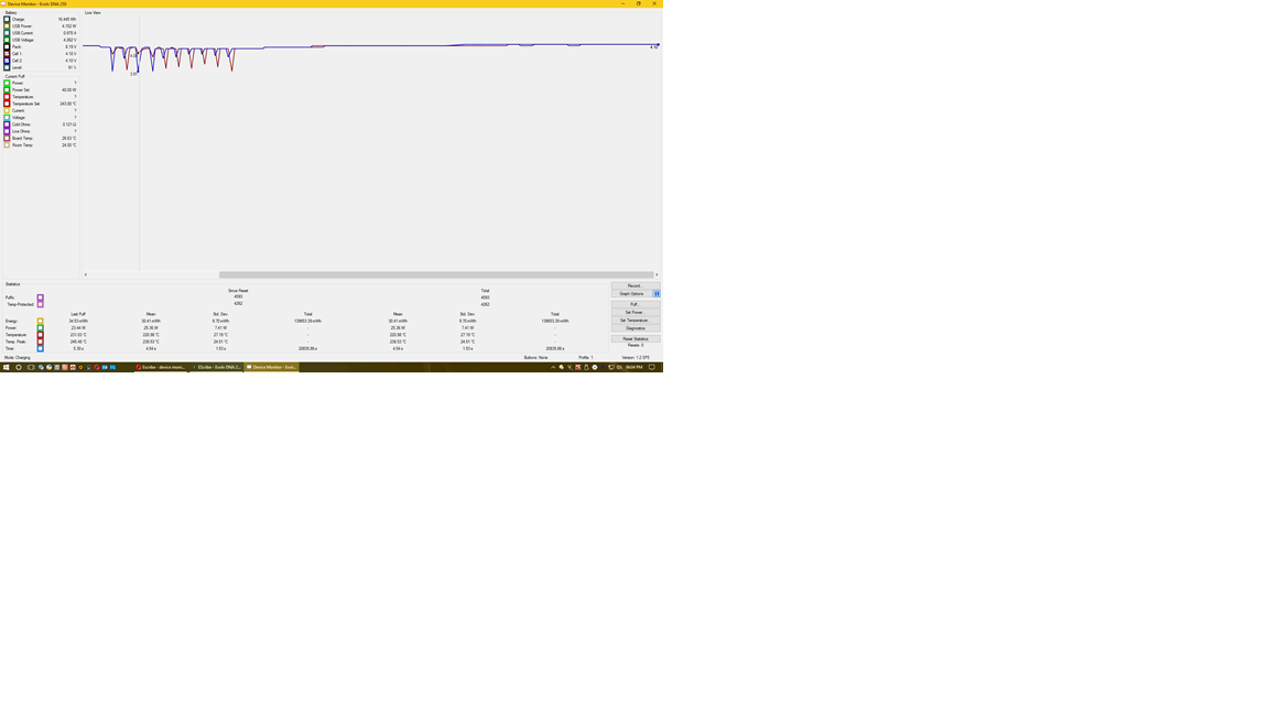

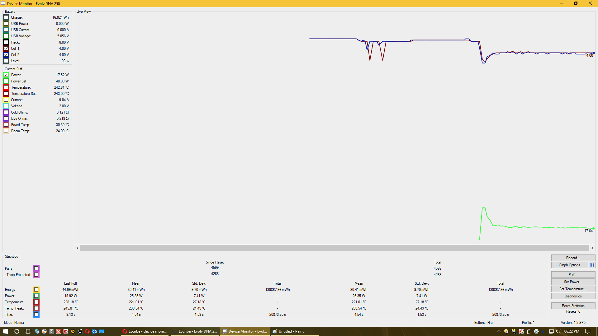

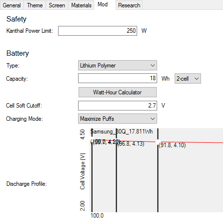

that's what I thought. Check battery, in this case, means one of your cells is hitting your cell soft value. (What do you have input for your CSC?) Also, what brand/mah cells are using? Post a screenshot of device monitor. Firing the device with only cell 1 and cell 2 boxes ticked.

the reason it will eventually fire is because after so many times of pressing the fire button, the board actually does fire atty for a split second before triggering the weak batt message. it has to do it this way to determine whether or not to display the error. you're basically warming up the coil to a point where the board doesn't need to draw much current to maintain your set temp, if that makes sense.
it sounds to me like there is a poor connection somewhere between the cells and the board. whether it's contacts or wiring or soldering related, can't say.
the nitty gritty - the board is asking for certain amount of power from the cells. it's not getting it, something's in the way.
