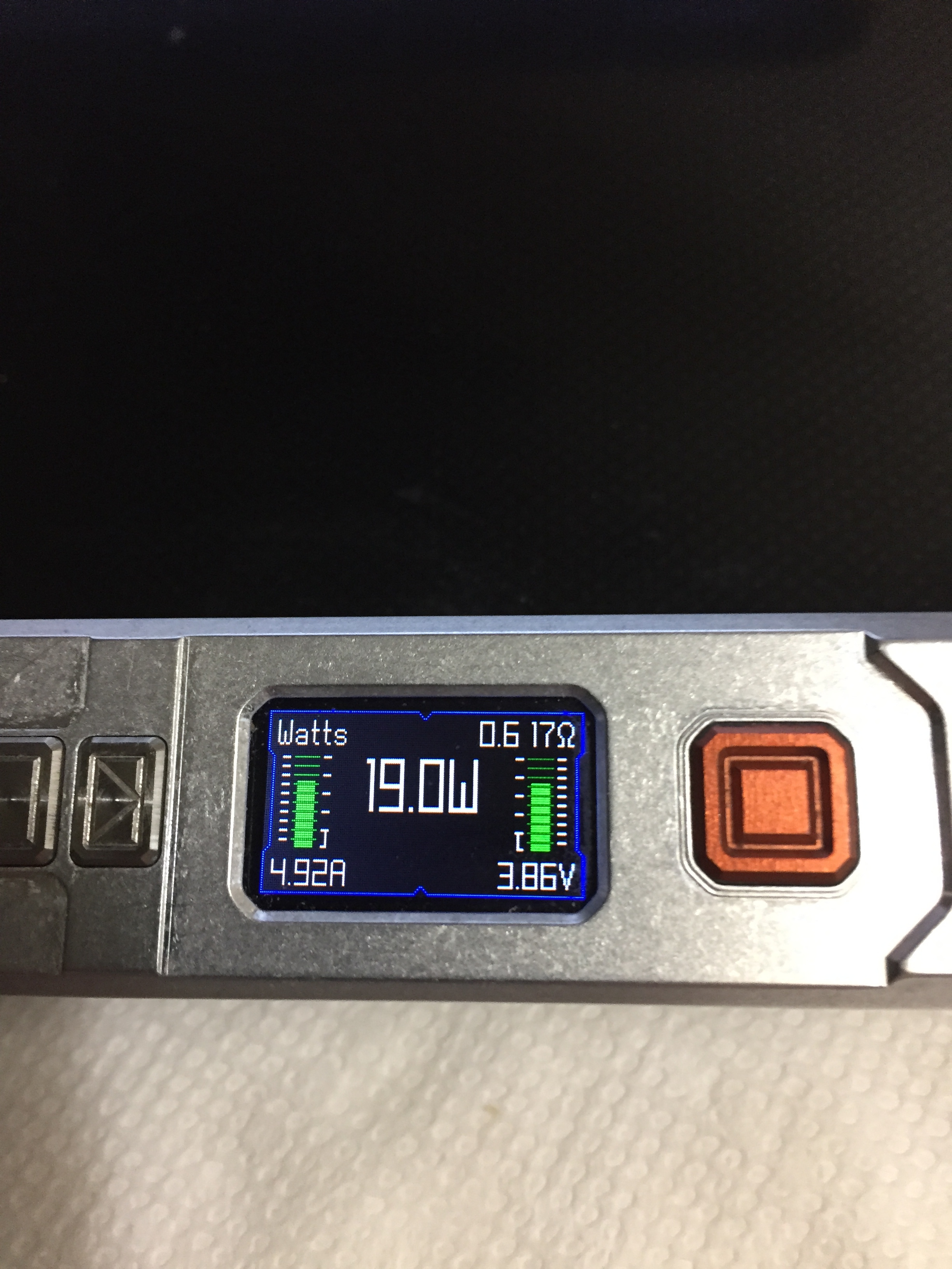

retird Posted October 4, 2017 Report Posted October 4, 2017 36 minutes ago, VapingBad said: ETA 2: Though DNAs showing resistance is not a figure that they need to work, but has always been extremely important to the user, where voltage is more academic. On the 75C you could display atomizer voltage, it is a newish field and not even a value they record for last puff because it is data rather than information (has little useful meaning on it's own without context). Per VB's comment..... Here is a DNA75C theme screenshot that shows puff voltage and the screen time out can be set so you can read the last puff voltage long after the puff. After the screen goes out the puff voltage reading zero's out until vaped again...
VapingBad Posted October 4, 2017 Report Posted October 4, 2017 3 minutes ago, retird said: Here is a DNA75C theme screenshot that shows puff voltage and the screen time out can be set so you can read the last puff voltage long after the puff. After the screen goes out the puff voltage reading zero's out until vaped again... There in no last puff - voltage field, it is under miscellaneous, they (rightly IMO) don't think it worth recording. I think they have provided it because people ask, but it has FA to do with your vape experience, temp and watts are the important parameters, in that order IMO, everything else is just virtually useless interesting detail other than for debugging except ohms which is a very useful reading to tell if everything is ship shape. Nothing wrong in being interest in the minutia and can be valuable when working through issues, but it is not going to affect your vape.
