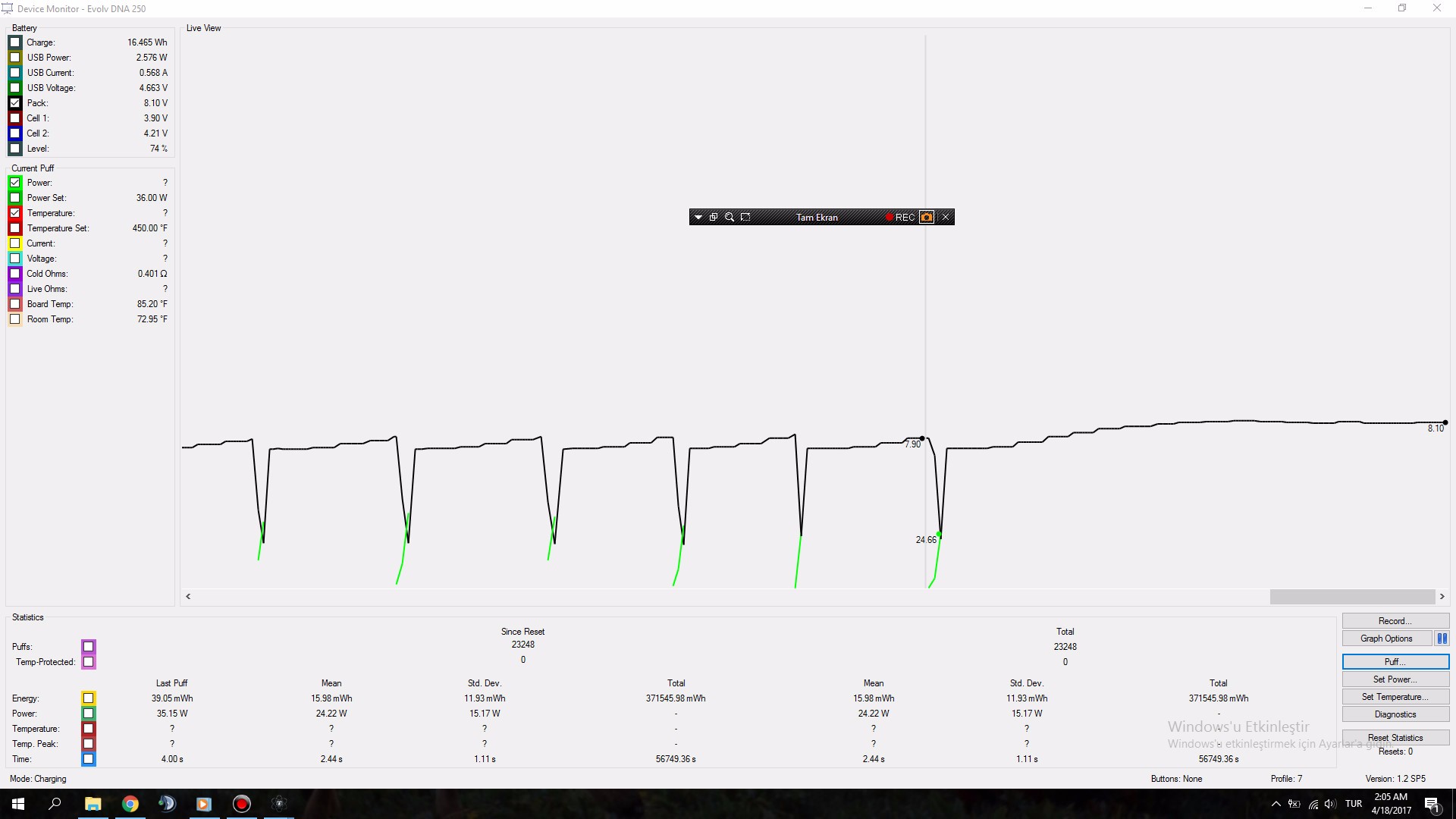

When you select the "puff" to be 3,4,5 seconds etc. it should fire for that many seconds.  Yours is dropping out after the first "puff" you selected and only firing momentary. Your Batteries are not equally charged and  there could be a poor or dirty battery connection(s).

If you look at the voltage of battery 1 and battery 2 in your screenshots/video you see that battery 1 is at 3.9 volts and battery 2 is at 4.21.  The voltage should be the same or very,very,very close to the same.
If you take out the batteries and switch locations with them does it then show battery 1 at 4.21 volts and battery 2 at 3.9 volts? If not then you could have poor or dirty battery connections and possibly a poor or loose ground somewhere.

I see that, but if he would check the Cell 1 & 2 boxes so that we can see what each battery is doing...I tend to agree with you that there is possible a connection issue, but kinda hard to tell with the info he has provided...and in the video, the batteries are almost balanced but yet in the screenshot, they are out of wack...???

giz_60 asked you to check the box for cell 1 and cell 2 and do a screenshot while firing.  This will let us look at the battery sag of each battery while firing.

The voltage for cell 2 is all over the place, even when not firing, if you look at cell 1, it stays fairly even both when firing & when not firing...you either have a weak cell...battery contacts in the device need to be cleaned (with iso alcohol) or there is a connection issue between the battery sled & the board...
