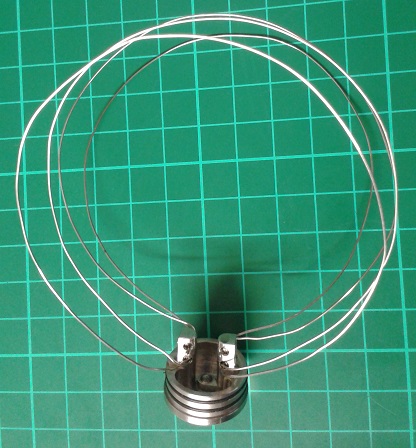

VapingBad Posted December 26, 2016 Report Posted December 26, 2016 Have EScribe Options - User Interface set to Manufacture. Just get a dripper deck and make a coil that will not get too hot, I make 4 parallel loops of 0.5 mm Kanthal around the size of a tennis ball that is good for 50 W test, you can go larger, but I wouldn't go much smaller. Put this in your mod with fully charged batteries, make sure it is standing up somewhere where it will not get knocked and the coils are not near anything that could get damaged by heat, then start the test the power level you like to vape at. You can record it to a csv file and then look at the detail in Device Monitor later, but this is not necessary. When the test finishes choose accept result, then the Save CSV button the save the battery profile.

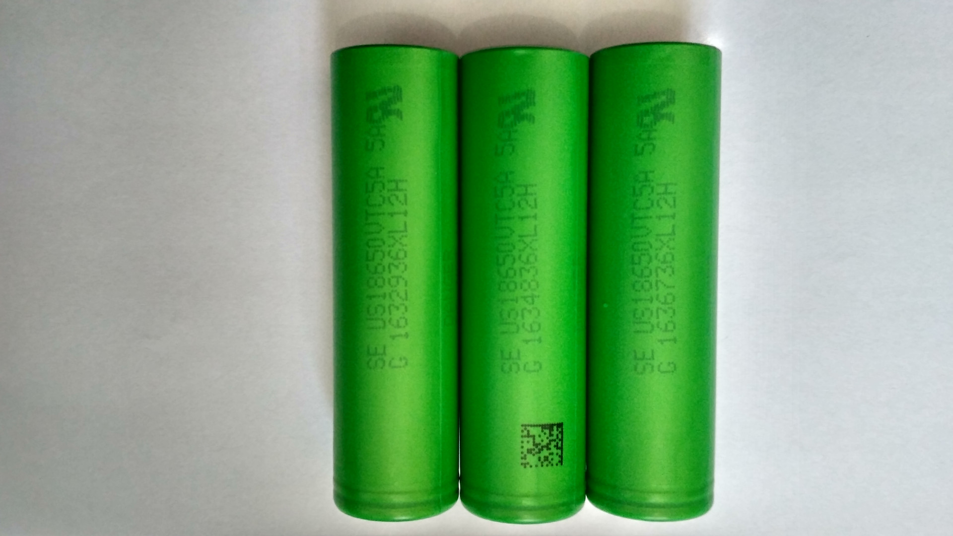

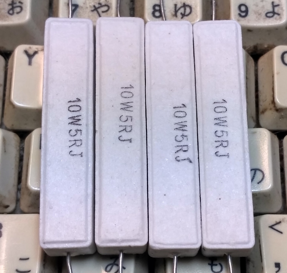

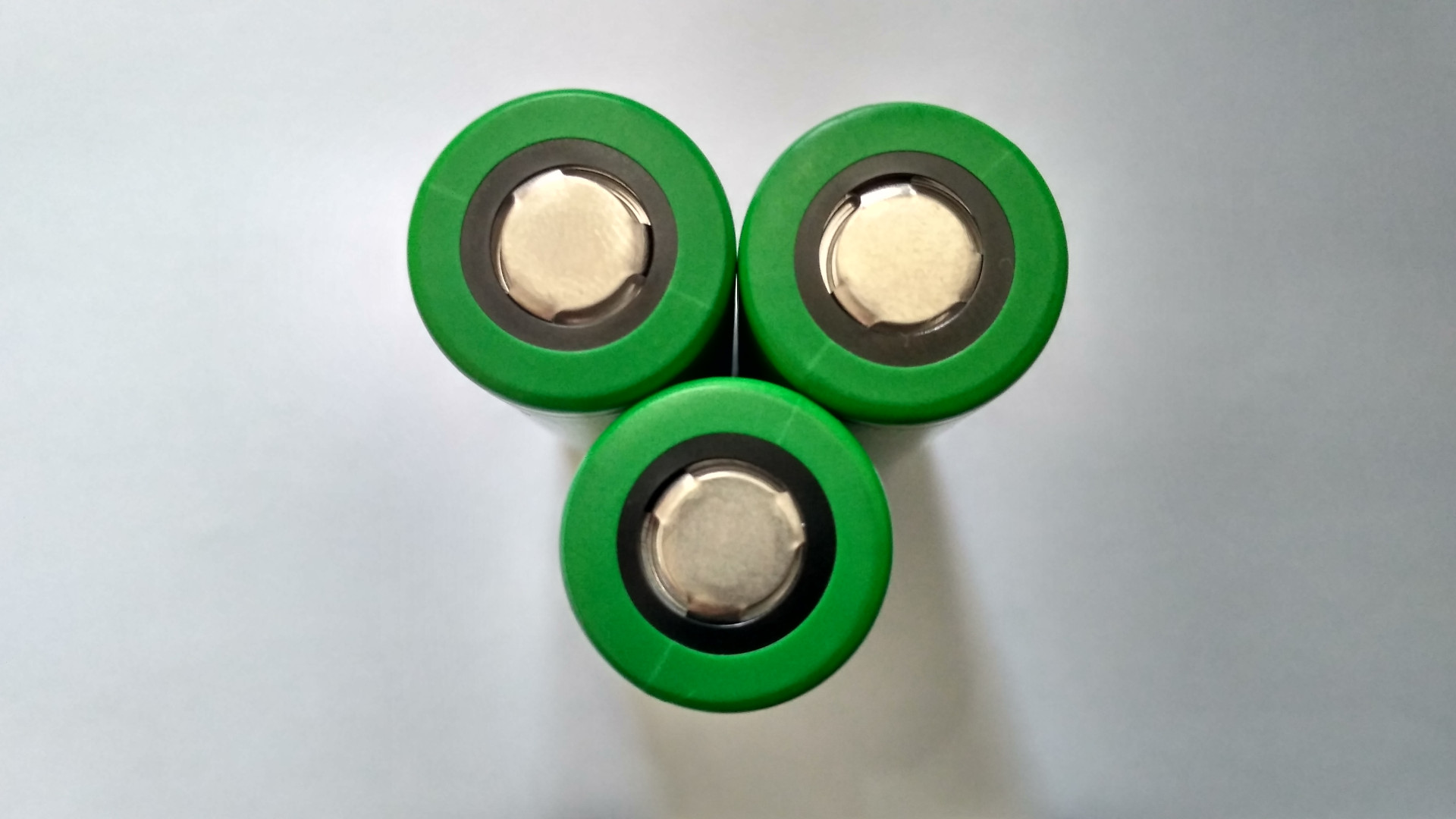

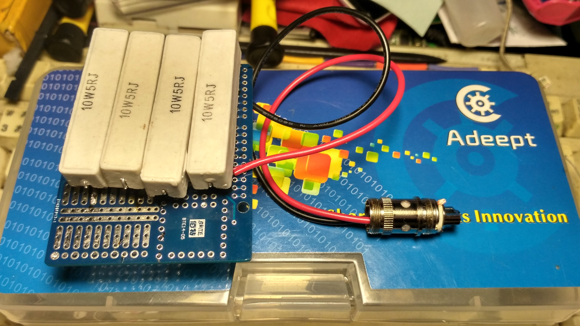

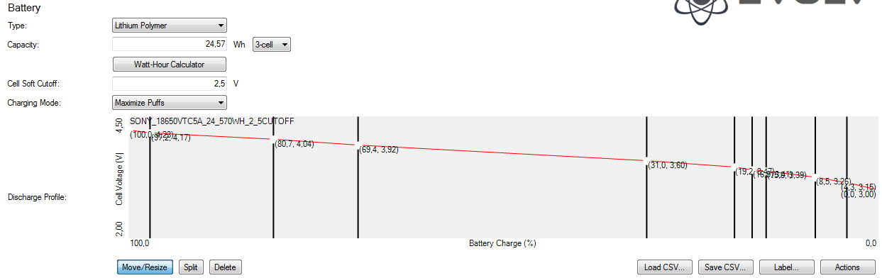

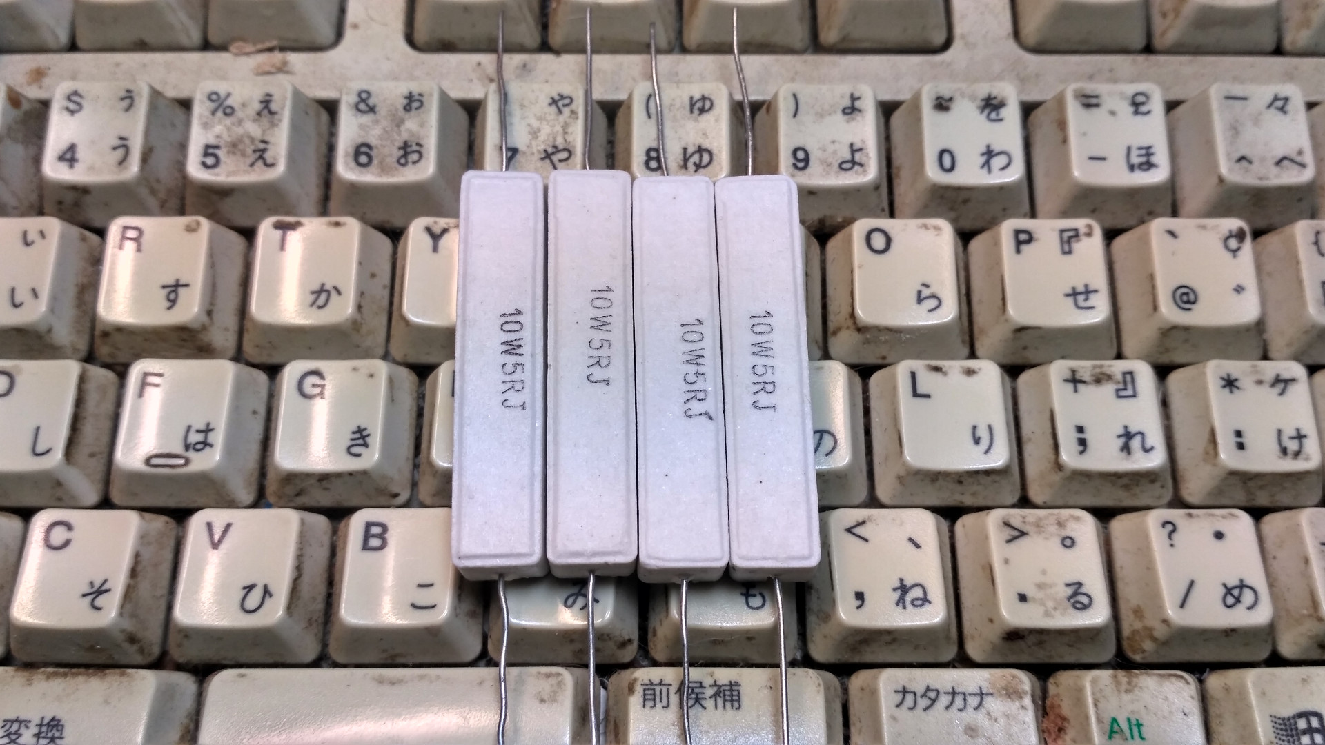

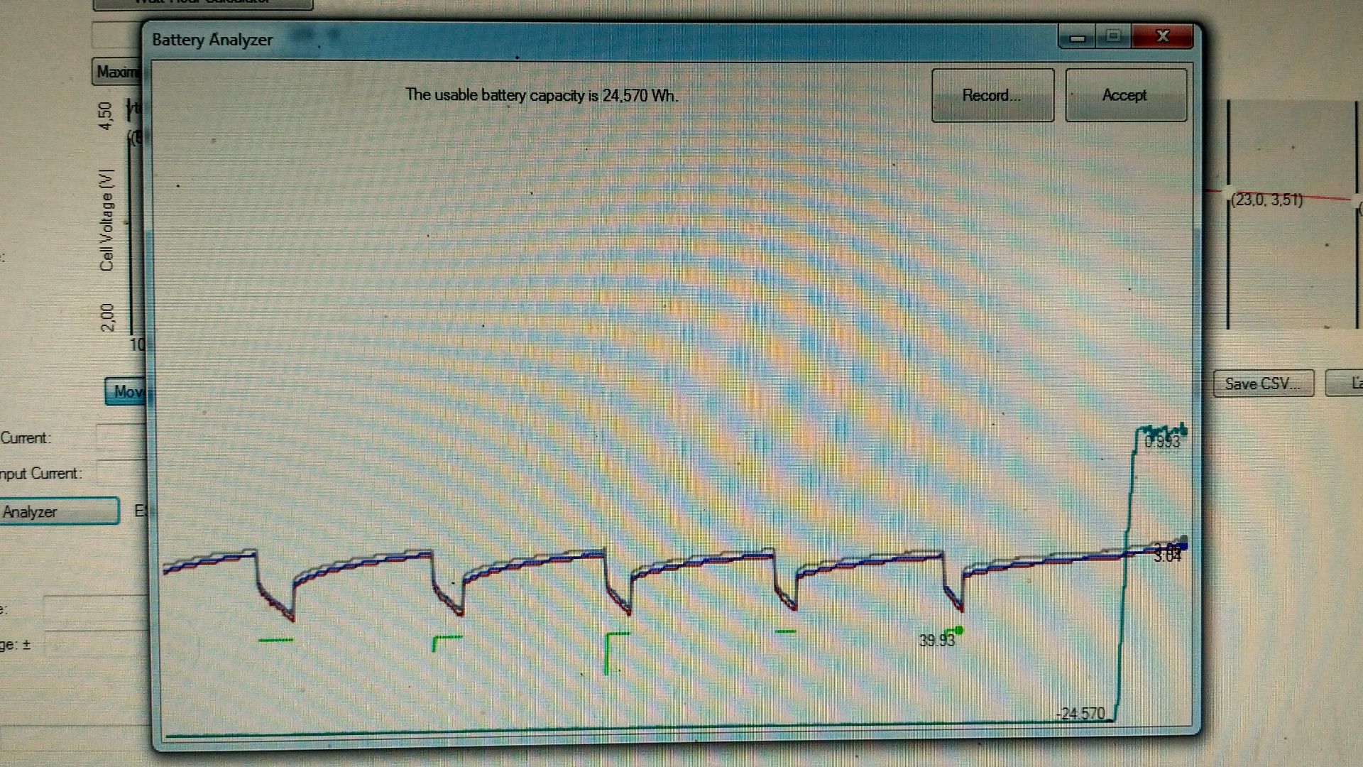

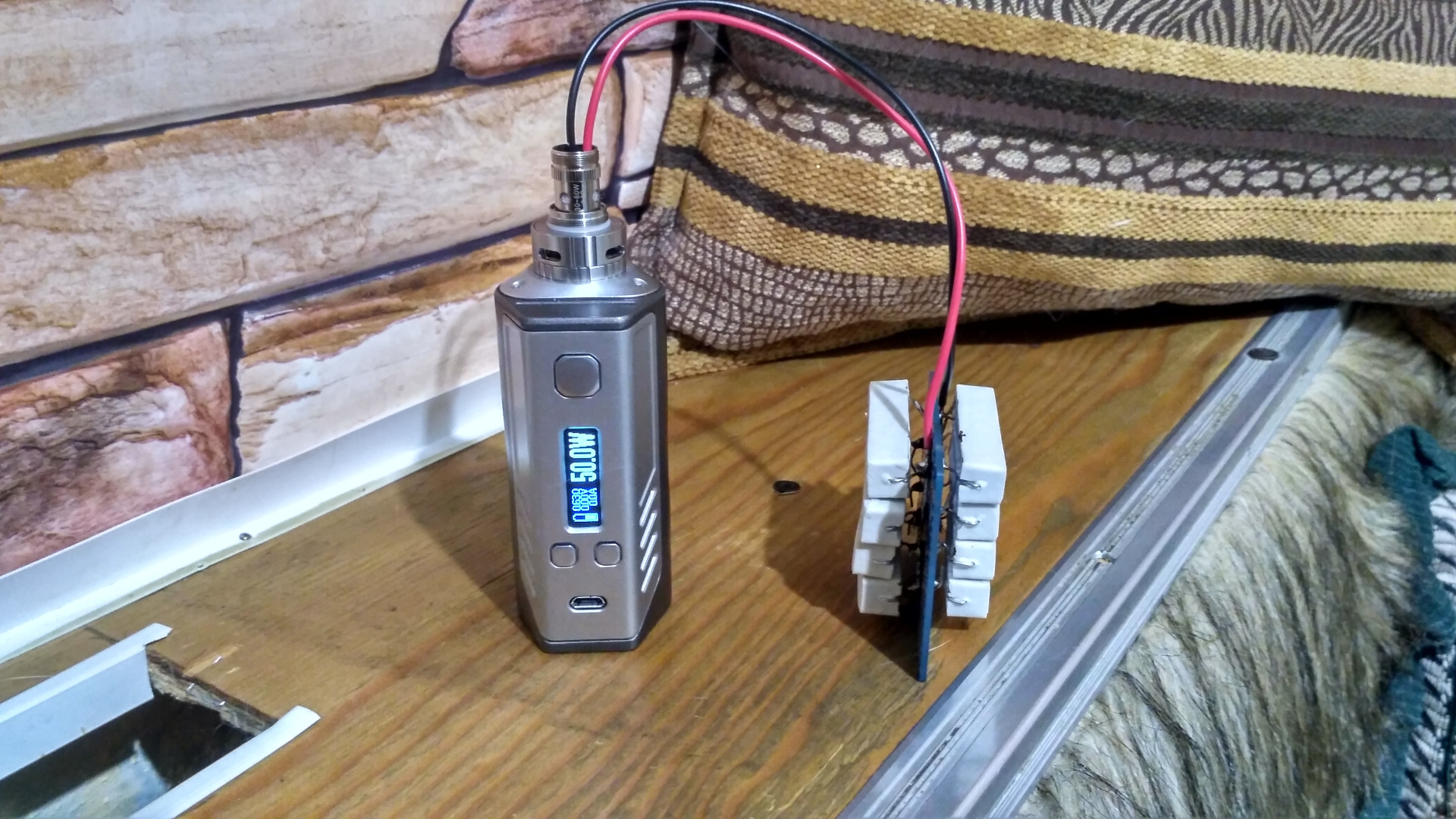

Nanaki Posted December 29, 2016 Report Posted December 29, 2016 It was not as difficult as it seemed at first =^_^=I did not have the necessary equipment as RDA and the diameter of the wire at this time, i have some 10W 5ohm resistors, Eleaf EC Coil Head parts and a strong desire to do it. >_<Resistors are same as I take 8 of them in parallel, which gave me 5 ohm / 8 = 0,625 ohm. Everything looks something like this: Of course, it needed cooling. For this PC Fan 12v has been used....about batteries. SONY VTC5A, new, original, fully charged with external charger. Cut-off voltage choosed 2.5v (Yes, I have read carefully about this all the things that had been written before). Some time later we have: sorry about that (photo insdead a screenshot)..a had lost buffer content when use printscreen twice xD Battery Analyser says that "the usable battery capacity is 24,570Wh" =^_^=When I release batteries from mod and get measurement of voltage the multimeter displays value in range 2.991 - 3.002v on each battery. The batteries is fully discharged. And the result is: Profile itself is in attachment. =^_^=SONY_18650VTC5A_40W.zip
