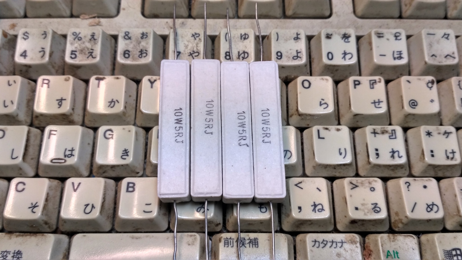

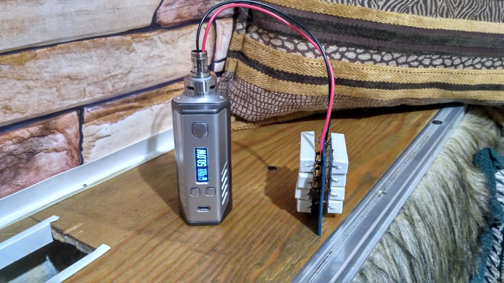

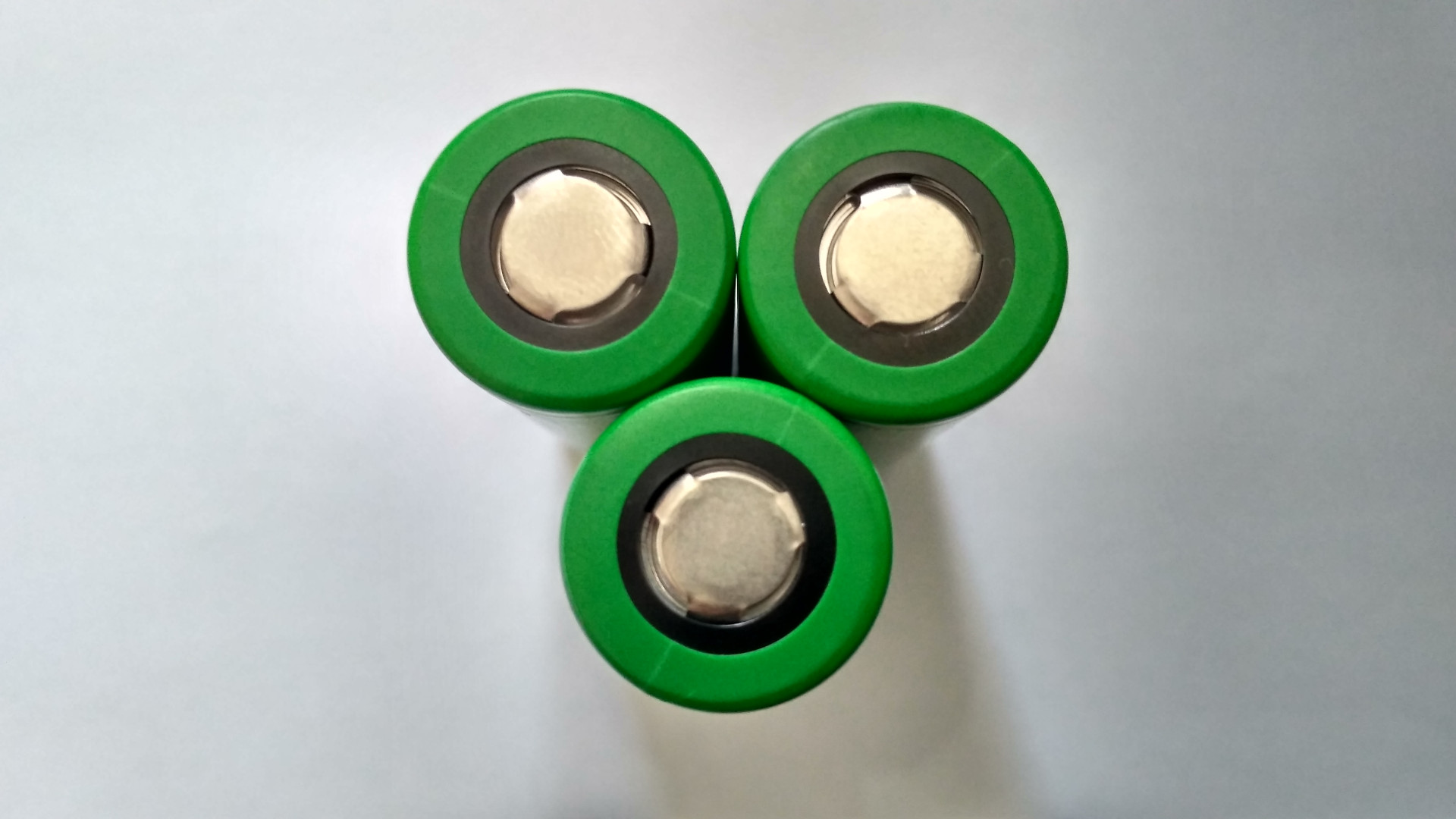

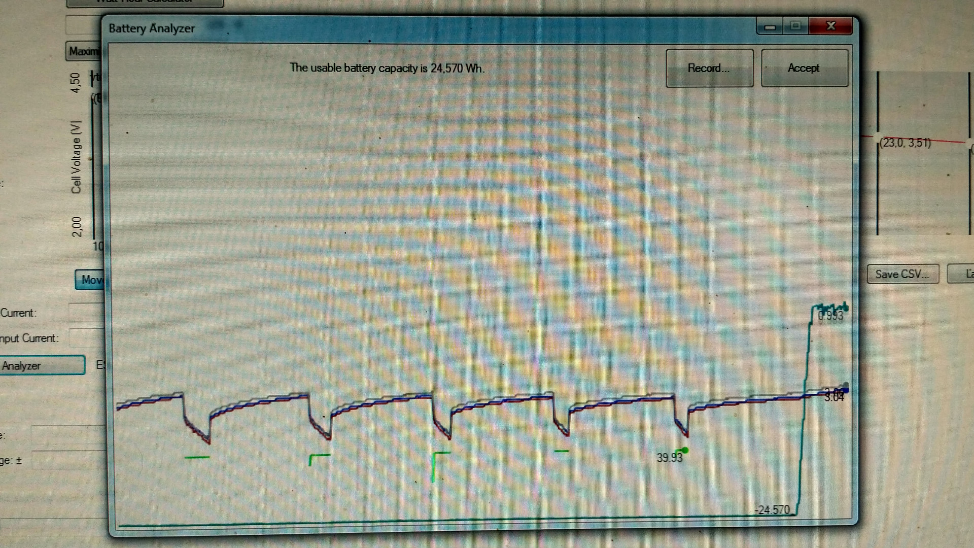

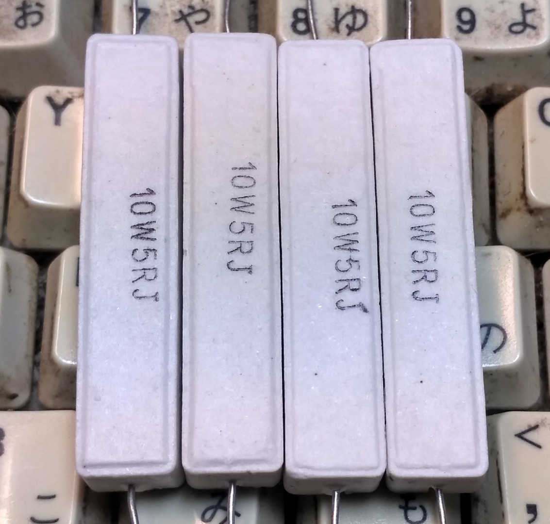

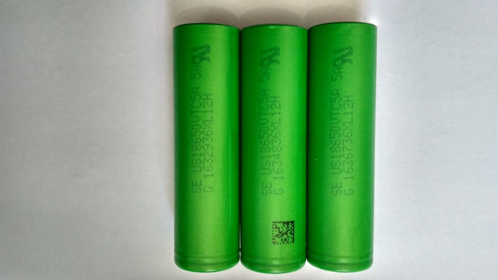

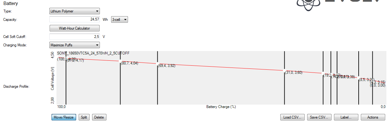

  1. It was not as difficult as it seemed at first =^_^= I did not have the necessary equipment as RDA and the diameter of the wire at this time, i have some 10W 5ohm resistors, Eleaf EC Coil Head parts and a strong desire to do it. >_< Resistors are same as I take 8 of them in parallel, which gave me 5 ohm / 8 = 0,625 ohm. Everything looks something like this: Of course, it needed cooling. For this PC Fan 12v has been used. ...about batteries. SONY VTC5A, new, original, fully charged with external charger. Cut-off voltage choosed 2.5v (Yes, I have read carefully about this all the things that had been written before). Some time later we have: sorry about that (photo insdead a screenshot)..a had lost buffer content when use printscreen twice xD Battery Analyser says that "the usable battery capacity is 24,570Wh" =^_^= When I release batteries from mod and get measurement of voltage the multimeter displays value in range 2.991 - 3.002v on each battery. The batteries is fully discharged. And the result is: Profile itself is in attachment. =^_^=SONY_18650VTC5A_40W.zip
