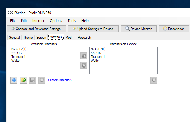

retird Posted April 30, 2017 Report Posted April 30, 2017 Can you post a screenshot of the Material tab in EScribe for one of the devices so we can see a list of materials that you have....
SadikYP Posted April 30, 2017 Author Report Posted April 30, 2017 Both devices have the same materials
retird Posted April 30, 2017 Report Posted April 30, 2017 Import this into your Available Materials and then add it from there to the Materials on Device. Then upload to device...Then make your SS316L Profile....and uploadSS316L.csv 1

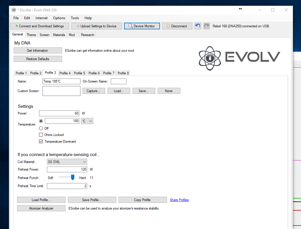

retird Posted April 30, 2017 Report Posted April 30, 2017 Just set up one of your profiles similar to this and upload it.... You can set the Wattage, Temperature, Preheat, Punch, and Preheat Time Limit to your liking...

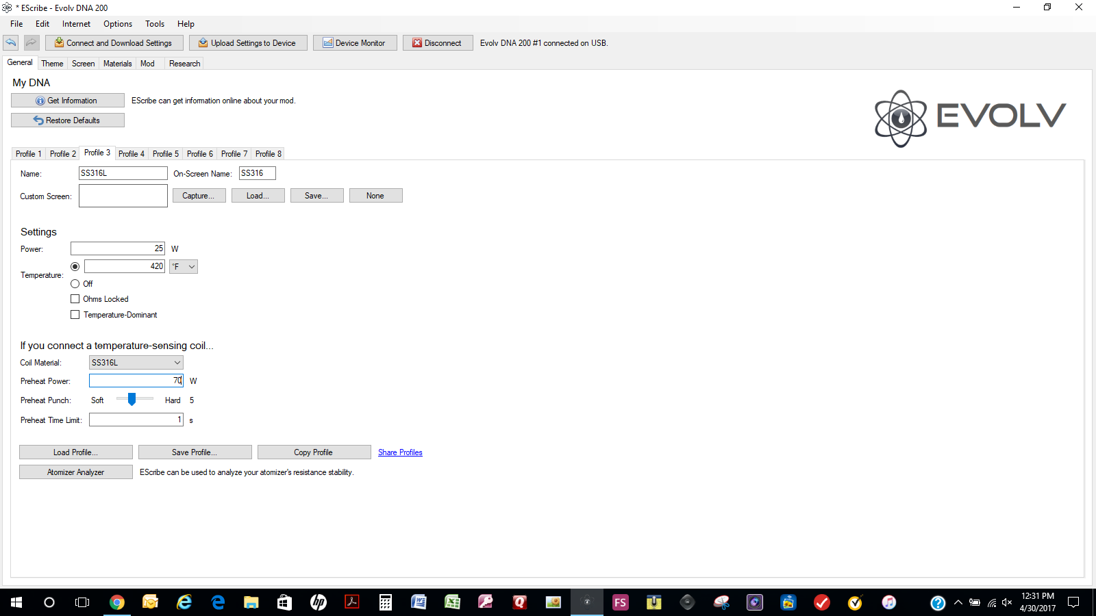

SadikYP Posted May 5, 2017 Author Report Posted May 5, 2017 Would one of the veteran vapers pleas check my SS316L profile & let me know if I've set things up correctly.Also how do I set Temp Protect to work?
mstave Posted May 6, 2017 Report Posted May 6, 2017 Looks pretty good (can't see the material curve from that screen). Your pre-heat is set for 120W and 2s - unless you are using coils with a lot of metal, that's likely a bit of over kill.Connect your mods to escribe, invoke device monitor and check to see how the coils behave under that pre-heat - could be good, could be too much - then adjust if necessary
