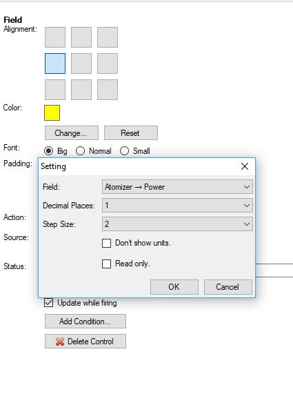

retird Posted May 7, 2017 Report Posted May 7, 2017 You really should have a DNA75 Color board to use the features in Theme Designer for the 75 Color.... when hooked up to a DNA 200 you can't get to this screen (as far as I know)..... I set the increments using a DNA75 color board as seen here and the increments will change by 0.2 watts.

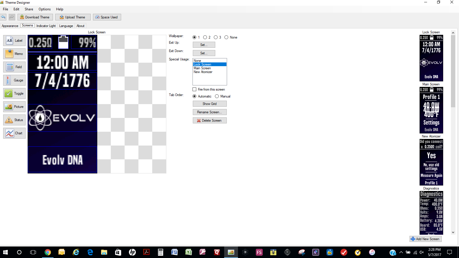

retird Posted May 7, 2017 Report Posted May 7, 2017 I believe you will find that Theme Designer for DNA200 is different than Theme Designer for the 75 Color.. here is a screen from the 75 Color Theme Designer....
Doyle4 Posted May 7, 2017 Author Report Posted May 7, 2017 Big difference, I checked the 75C options without a device connected to have a browse around. If you try Theme Designer with a 200 or 250, it brings up the Screen image import options that was under Theme like normal, just a few other options, such as Wattage Increments, but doesn't work, 0.1 always stays. Im sure they will fix it in next update
