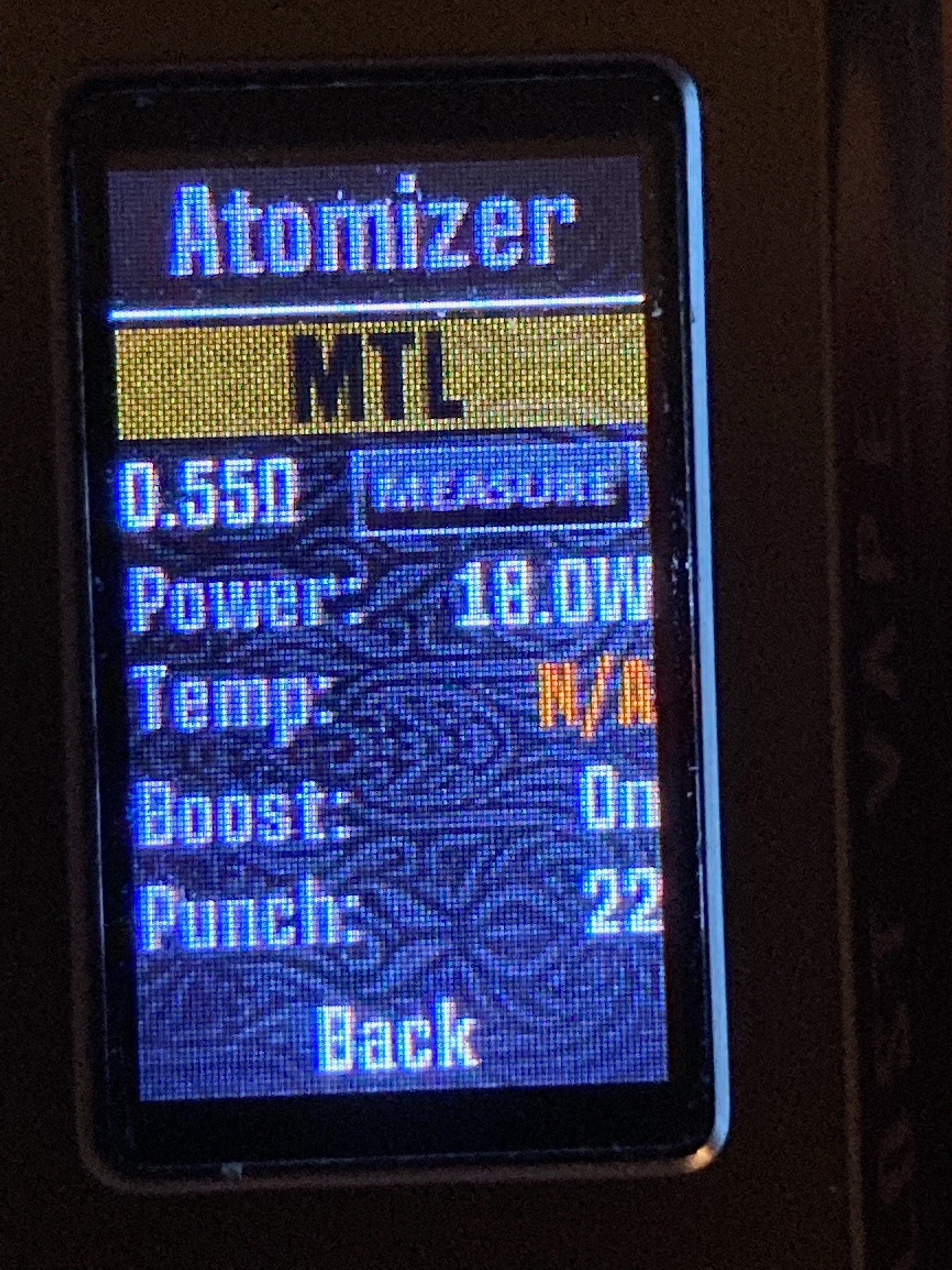

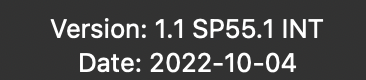

  2. I noticed it on a custom theme I made myself but I've checked several popular themes and it's the same on all of them. Lost Vape Official Theme, downloaded from their website (picture below). All other themes I've checked (Gauges, Material-ish Fire, ProVapers LED) go up to 22 too. Most themes have a gauge rather than a number, but the gauges go from empty to full in 22 clicks. Maybe this is normal, it just struck me as strange as everything I've read talks about the Boost / Punch going up to 11, and the Escribe software only goes up to 11. Escribe version is: Device is Lost Vape Thelema, DNA250C version is:
  3. Does anyone have any idea why my 'Boost Punch' option goes up to 22? In the Escribe software, profile section, the option only goes up to 11. Within my device's settings (Lost Vape Thelema), the punch option goes up to 22. Is this a bug?

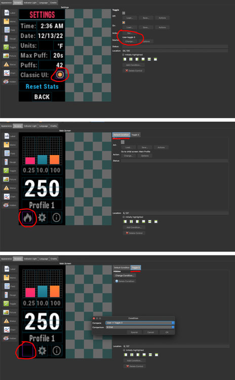

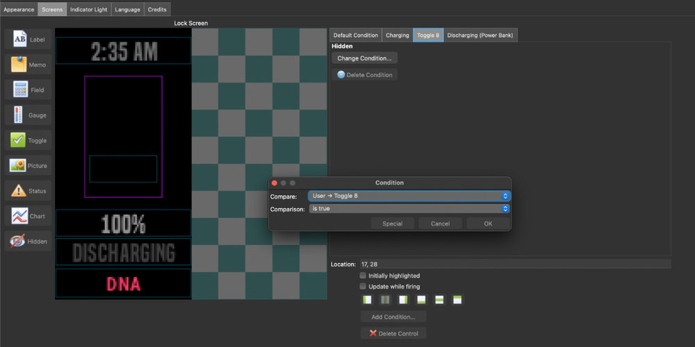

  6. Teaching myself to make custom themes so I downloaded a bunch of themes and set to work trying to pick them apart. I didn't really understand how the User Toggles work (aside from toggling something) but after a quick search I found someone recommended the Gauges theme Lock Screen by @SirTimmyTimbit as a good example of how to set and use a user toggle. So the central image on the Lock Screen is hidden if the 'condition' is set to User - Toggle 8 (is True)... (see image below) But how do I find the trigger/source that causes Toggle 8 to be True ? I looked through all the pages and all the elements on each page and couldn't find anything else relating to User - Toggle 8, it doesn't seems to have a trigger/source. I'm assuming this is how it works because... There's a 'Classic UI' option on this theme's Settings page. The Toggle element for that 'Classic UI' option has a 'Source' of User - Toggle 3. The theme's Main Screen has a couple of elements that change state (some become visible, others become hidden) depending on whether this Toggle 3 has been triggered by the option in the theme's Settings page. (see image below) Or am I completely misunderstanding how these toggles work? Any help would be much appreciated and apologies if I've posted this in the wrong place. Cheers
