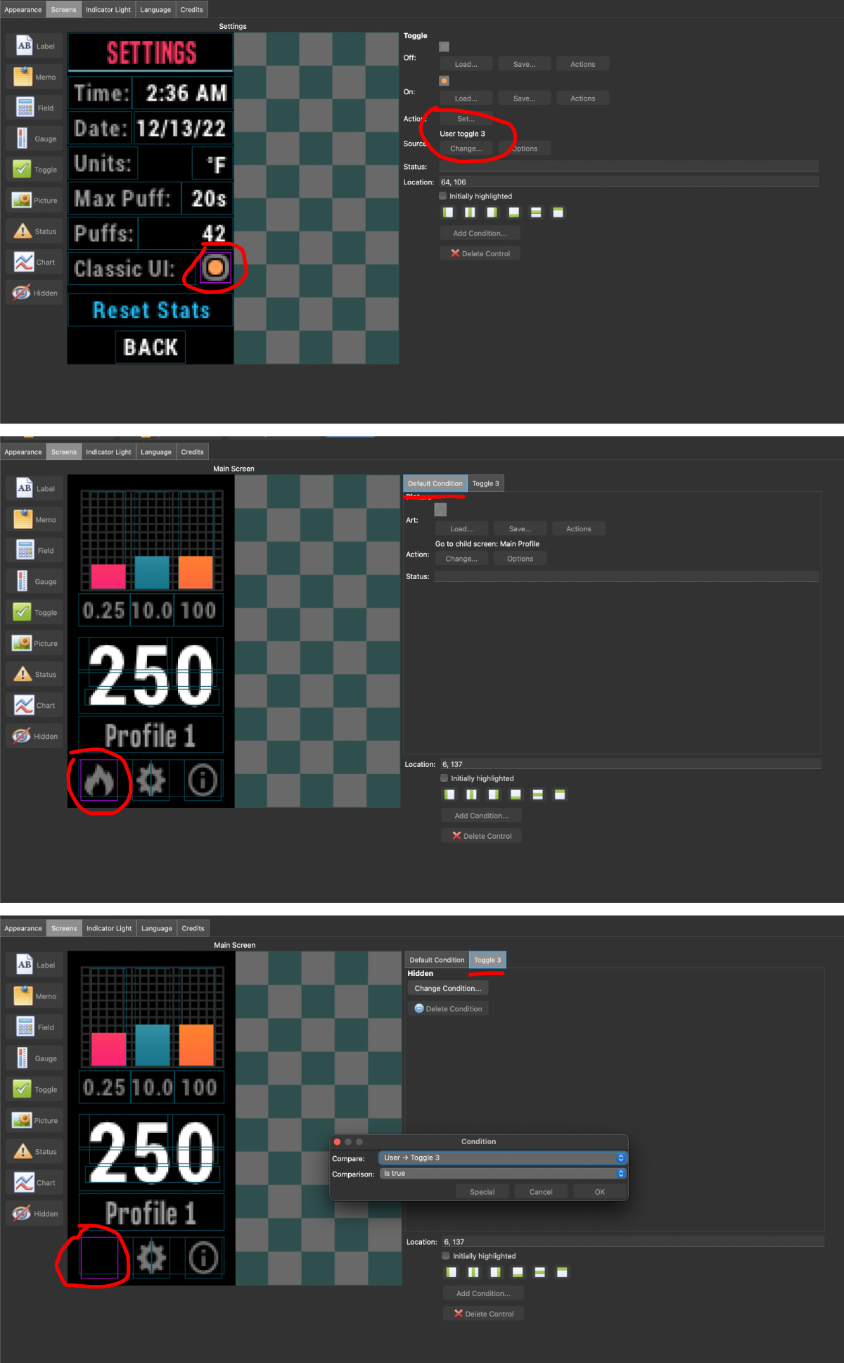

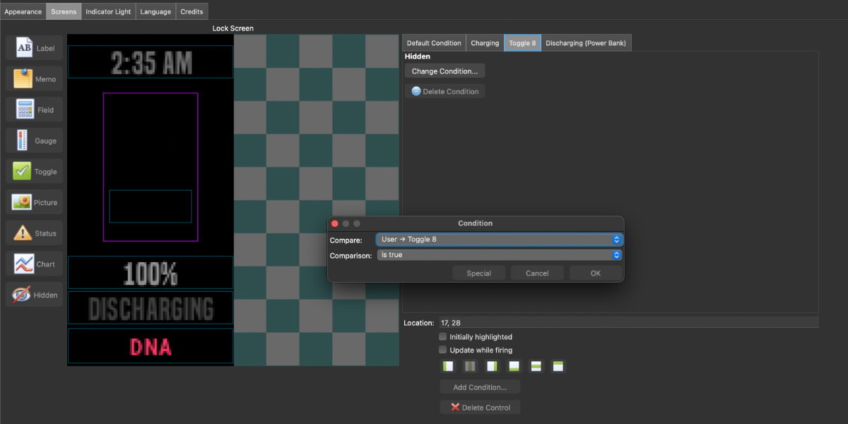

Teaching myself to make custom themes so I downloaded a bunch of themes and set to work trying to pick them apart. I didn't really understand how the User Toggles work (aside from toggling something) but after a quick search I found someone recommended the Gauges theme Lock Screen by @SirTimmyTimbit as a good example of how to set and use a user toggle. So the central image on the Lock Screen is hidden if the 'condition' is set to User - Toggle 8 (is True)... (see image below) But how do I find the trigger/source that causes Toggle 8 to be True ? I looked through all the pages and all the elements on each page and couldn't find anything else relating to User - Toggle 8, it doesn't seems to have a trigger/source. I'm assuming this is how it works because... There's a 'Classic UI' option on this theme's Settings page. The Toggle element for that 'Classic UI' option has a 'Source' of User - Toggle 3. The theme's Main Screen has a couple of elements that change state (some become visible, others become hidden) depending on whether this Toggle 3 has been triggered by the option in the theme's Settings page. (see image below) Or am I completely misunderstanding how these toggles work? Any help would be much appreciated and apologies if I've posted this in the wrong place. Cheers
