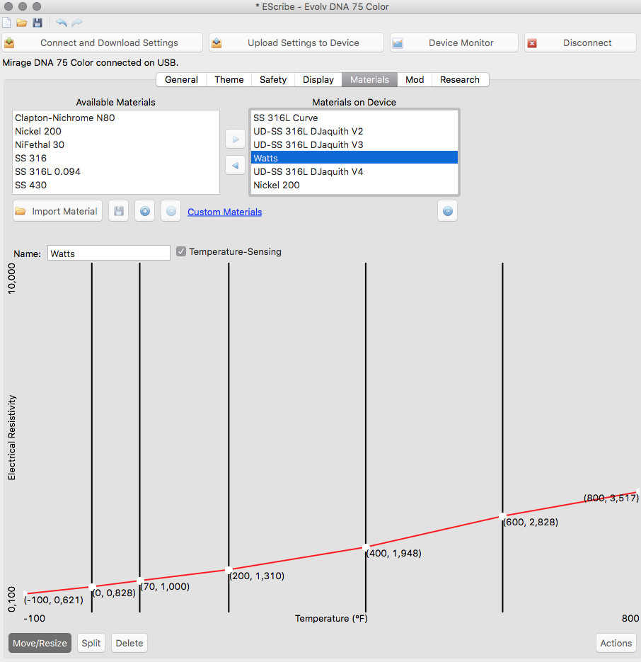

  6. Try to compare these pictures - depending on selected Temp-sensing check box You can see different possibility at Profile table - with or without Temperature box under Power settings box... Also compare curves for Nickel200 a Watts under Temp-sensing checkbox... there is no difference
  7. I tried the wattage material for Replay profile, it looks like Replay works but at higher power does not work TC, i got dryhits ... if i confirm Temp-sensitiv material u Wattage material table, it turns on curve for Nickel200, so for SS wires probably unusable...
