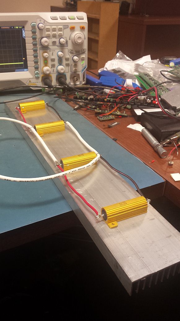

  15. 4 one ohm coils would work quite well. This is my battery analyzer test setup. It is somewhat... larger... than strictly speaking necessary (it will handle 200 watts continually) and it is permanently soldered to a test board (but I have thousands of those)

  22. Sure, I will throw up a picture of my setup. Mine is overkill, because it will sink 200w continuously, but you will get the idea. For battery analyzer it doesn't matter whether how good your setup is, as long as the connections are reliable and the resistors can take the heat. All it needs is somewhere for the energy to go.
