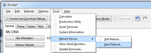

  9. First Eciggity is a very good company so worst case simply arrange an RMA if needed. First, let's try to fix it. Connect your Efusion to EScribe and try a Hard Reboot: Next look at the Device Monitor and see the charge on Cells 1,2 & 3. Full (max) is 4.2V per Cell and minimum (empty) is approximately 3.0~3.1V per Cell, and Unbalanced is > 0.2V~0.3V between highest and lowest: Also, I'd recommend downloading the latest version of EScribe and if required update the firmware. Latest version of EScribe (2015-10-21 EScribe 1.0.35.2) - /topic/66731-topic/

  13. I think I just replied to you, download your Battery Profile and look at the CSV file. Full 100% should be 4.2V and empty 0% around 3.1V. If you run the Device Monitor look and compare Cell 1, 2 and 3 they should be the same or within ~0.1-0.2V while charging. If it's much more than you have a LiPo that's out if balance. Here are some user tested numbers that I'd use over the Evolv's defaults. HCigar does not properly setup their Mods and uses IMO cheap inferior LiPo's. Settings: Wh = 11.09 Battery Profile (CSV) http://www.filedropper.com/hcigarvt200battery Cutoff (V) = 3.09

  16. Bad battery that's probably way out of balance, and apparently the board is okay. I did note some issues from others with some of the screws causing TC instability. The ground on the Balancer could be misreading the battery. You can try a Hard Reboot, check the board's screws for tightness and reseat both the Battery and Balancer connections. Ideally, if you have a LiPo Charger with Balancer only charging and or regular charging then charge the LiPo outside the Mod. If you have an Voltage Meter with DC 12V you can check the Taps to see Cell voltages. Here's a good video: https://www.youtube.com/watch?v=wIbHLacozFo

  23. That's why it seems more like a PC issue. You could try MSCONFIG and disable both Startup and non Microsoft items. In Escribe perform a Hard Reboot of your DNA Mod. I assume you're using the most current version of Escribe /topic/66731-topic/ and the firmware has been updated.
