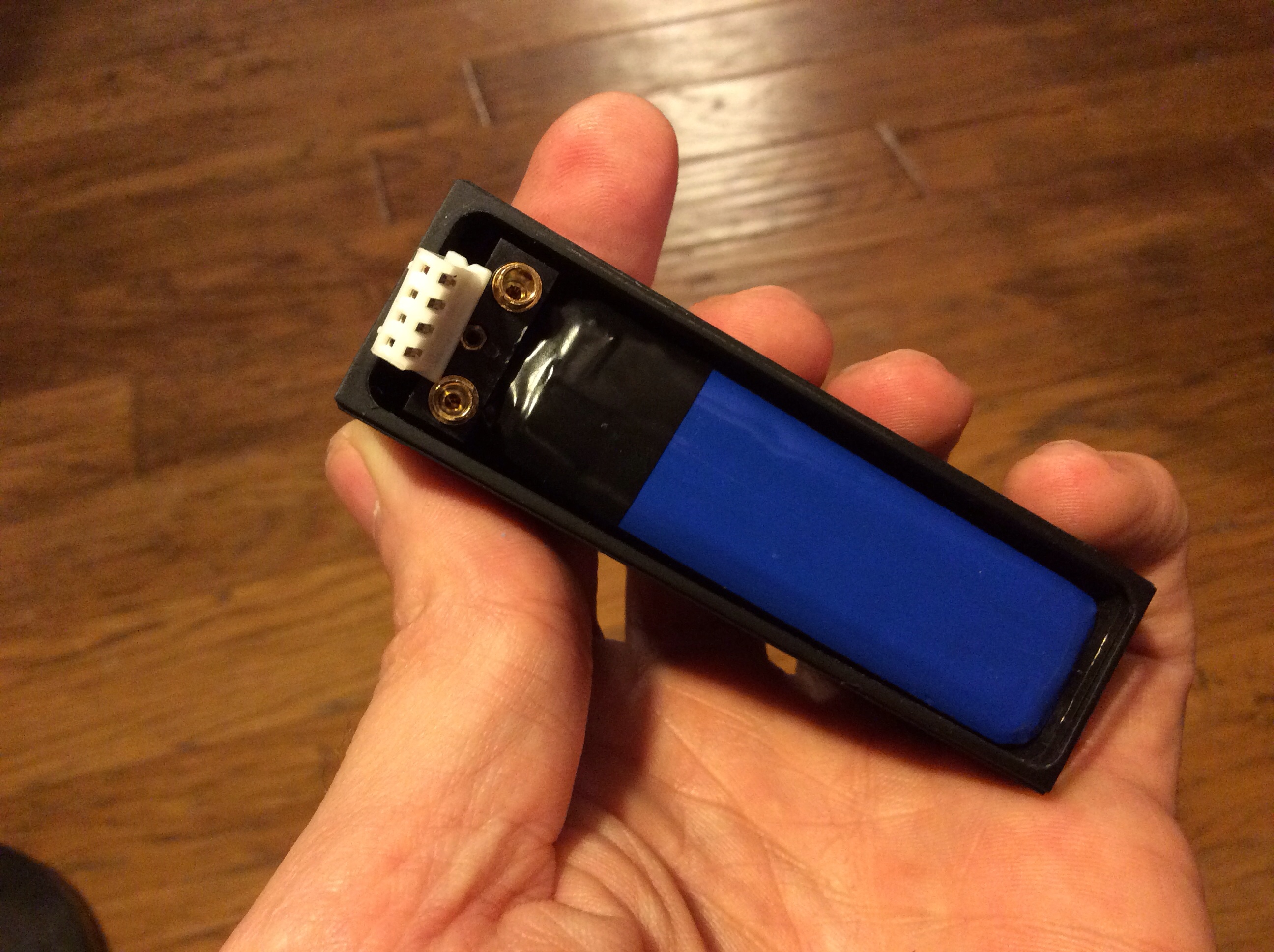

  1. I don't know. You said you have the DX and a replacement battery? Is it the one from Fasttwch? I how are the specs on it? I actually had to replace mine with a FullymX cuz the specs were way off and my battery was DOA. I don't want to spend a lot of money for a junk battery, but it would be nice to have a spare.

  5. I would like to wish EVOLV and all the members on this forum a Happy Thanksgiving!! I am grateful for all the knowledge that I have learned since joining this forum. Everybody is always so willing to pass their knowledge onto the next person, and so on...it really exemplifies the commraderie that not only goes on amongst owners of the DNA 200, but mainly the vaping community as a whole. Thanks for elevating my vaping experience!

  8. Hi there Digatel, I thought the hotcig battery WAS the fullymax that Evolv sell-it has the exact same dimensions as the fullymax 900MAH, plus the same constant and burst ratings. I agree hotcig is shady though. "Bennett" is currently speaking to me, and has said he will send me a new DX200 on Mondat due to everything I have had to go through via DHL, he asked for my adress and said he will give me a tracking number. But, I will find out on Monday/Tuesday if he follows through on this promise. [/QUOTE] ------------------------------------------------------------------------------ Hey Conan, I thought maybe it was too, considering the specs, but when I took it apart and seen the battery that is in there, it was evident it is not. Granted, it does have the same "specs" and dimensions, but as far as quality it is junk. My battery was DOA, like I said before, so I never was even able to charge them. Nonetheless, when I seen that review on YouTube, I was couldn't believe it. I don't know where the batteries are made, but they are not up to "specs". The dimensions are almost exact that of the Fullymax, which made replacing it very easy. This is the battery that come with the Hotcig and the replacement battery:
  9. Hotcig batteries are junk! I have a Hotcig and I just decided to replace the battery they gave me with a Fullymax from EVOLV. I'm glad I did too. I watched a review yesterday, where this guy did a in depth review of the battery that comes with the DX200 and the replacement batteries they're selling on Fasttech right now...the specs were astounding...in a bad way. Hotcig is really shady company and they continue these unethical practices, knowingly, at the cost of consumers like myself. They really need to be held accountable...anyone considering buying from Hotcig should watch this first! Here's the link to the review: http://youtu.be/SeOem8x26Gg
  10. Yes, 9.9 (9.99) is correct. I finally got my Hotcig working the other day and then realized my battery was shot as well, so I replaced it with a FullyMax 900mah from Evolv and it's working great now!
  11. Just swapped out the defective battery that comes with the Hotcig, with a FullyMax 900mah battery...so far it's working great!
