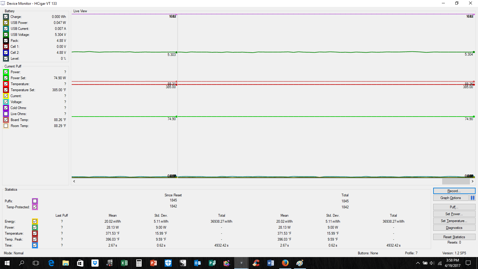

Yes, 5.11 volts, standing. Here's a screen shot with the mod firing. It drops to 4.96 volts, according to device monitor. BTW, at first, the battery charge was reading at 63%. But, it would not charge. After a hard reset, that disappeared. -

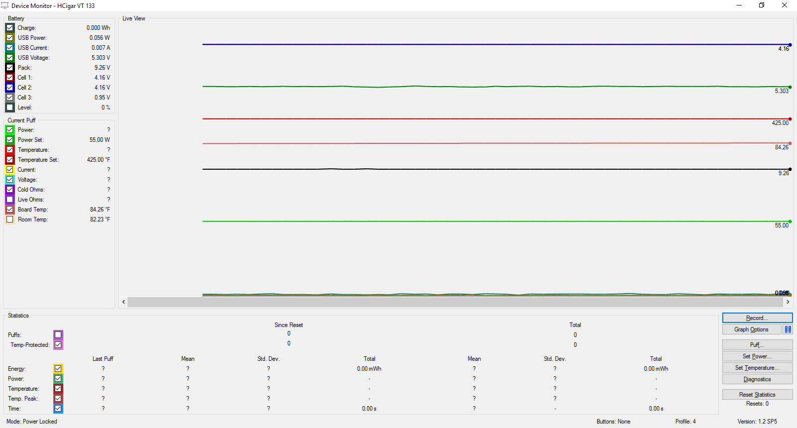

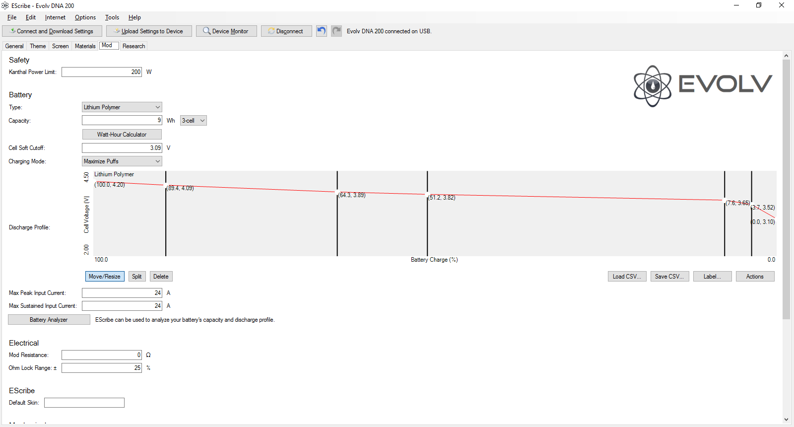

I installed it. As I suspected, it changed nothing. The 3rd cell should not be showing, at all. Yet, there it is. It has an abnormally high reading, for a phantom cell. What about the 0 charge/watt hours, and 0 battery level on two fully charged 30Q's? What does that tell you? Is it another bad board, or did the tech break the mod, itself?
I'm not sure what that has to do with the problem. Even if you don't uncheck the 3rd cell on device monitor, it simply shouldn't show up, with 1.2 sp5. Also, it reads higher than the phantom cell that showed on device monitor, before 1.2 sp5 was released. So, it isn't normal, even if it were in 3 cell mode. Yes, it is the stock dna settings. I never attempted to customize. It won't start up, at all. Tethered to the usb, I get a screen that shows 0 ohms, and 0 battery. Otherwise, it's Evolv's stock opening screen, until you release the fire button. Then, nothing. When you asked me to post the screen shots, did you have something in mind that you might be able to share with me? What does the fact it fails to read ohms on an installed coil, and the 0 watt hours/0% battery showing on fully charged Samsung 30Q's tell you about the problem? Is it a hardware issue, other than the chip? That's what it seems like, to me. I was told that they simply had to realign the chip. But, this one doesn't have my settings on it. It's stock settings. I checked the serial number. And it's new. So, is it a bad chip?
Nick didn't make the mistake that caused the problems that made it necessary to send it in twice. Nor did he cause whatever problems it now has. But, someone at evolv warranty service has dropped the ball, twice. And, this time, it seems that the mod, itself was damaged: ohms read 0, watt hours read 0, battery pack reads 9.16v, batteries each read 4.16v.
