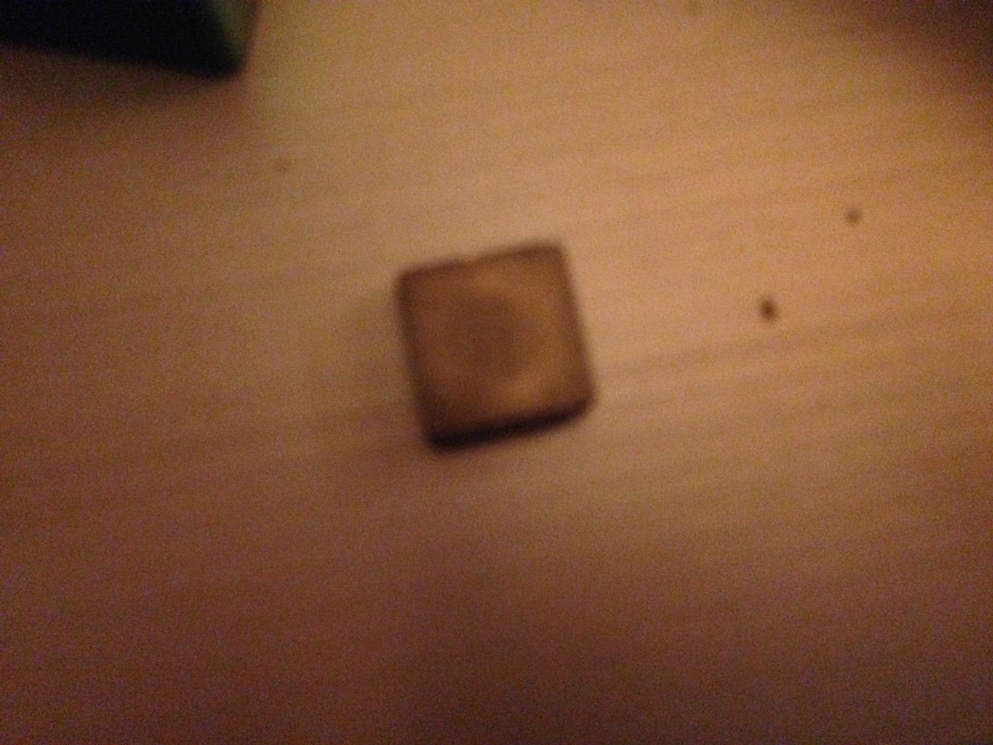

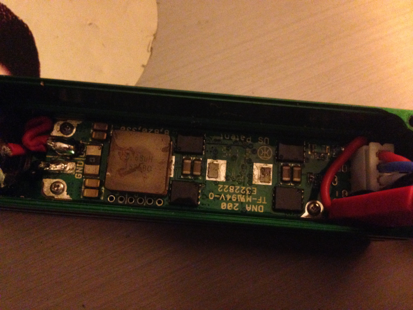

Jurdanas, Thanks for the info. It looks like it's on the battery side. That is functioning normally, as far as I can tell. Hooking it up to escribe to see if it's running hotter than normal. It isn't. 91-98F. It can get up to 150F, and still be in normal range. I don't understand circuits that well, unless they're made of caps and resistors. My guitar amps are all pre-Space Age technology. I'm an Art Historian, so this is a little out of my field, but I love my hobbies. And, I come from a family of scientists, and engineers. So, I'm a little better rounded than most people in the Humanities. This appears to be a miniaturized induction coil. Not familiar with them, in this form. But, it should work the same as larger scale coils. black lace, it has been running like this for maybe 2 months. I tend to vape at relatively low wattage. never over 80 watts. There is a groove where the inductor came off, and slots formed from the solder, i gather, on the inductor. There is so little space in the Hana, so the battery barely fits, and touches the board. Not sure this is good for either of them. -

Update: I just set it back in place, for the time being. The battery is right on the board on these things. I opened it back up, and it was still in the same place. I would prefer sending it to evolv for repair over Hana. Not sure what is up with them, anyways. They don't seem to be manufacturing new mods, at all. I wonder if anyone will offer a DNA 250 upgrade service? I might just nurse this one, until that option is available. I'm good at point to point wired tube (Valve, if you prefer) amp circuits, but I'm not equipped to work on small board circuits. So, I am nervous about trying to repair it. -

Hi, I opened my Hana V200 to compare it to one I had just purchased. When I did, I found this came off the board (see pics). The mod seems to be working fine in temp mode. Is this just a heat sink? I thought it was an important component. Should I repair it? Superglue? Or, is there an electrical conducting adhesive I should use? Thanks in advance for any information you can give me. -

Wow. You need to have heat sinks clipped to your board when you're soldering. I'd put them on the wires, too. I have repaired, and rebuilt tube guitar amps, and plan to build a DNA 60 mod. Maybe upgrading to DNA 250, and replacing the wiring, completely in a Hana Modz V200 (wiring needs to go, regardless). A little nervous about the smaller scale. What wattage, and tip size are recommended for soldering? Good luck with the resistor.
