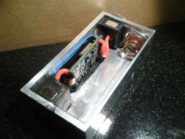

I couldn't find any "electronic grade" RTV is Sugru (Silicon putty) OK? I built this DNA40 350 days ago and it has heavy use with no problems, the Sugru is the black stuff in the photo. Edit: I found some Servisol Silicone Adhesive Sealant which seems to be OK, but would like to know about Sugru's suitability. -
