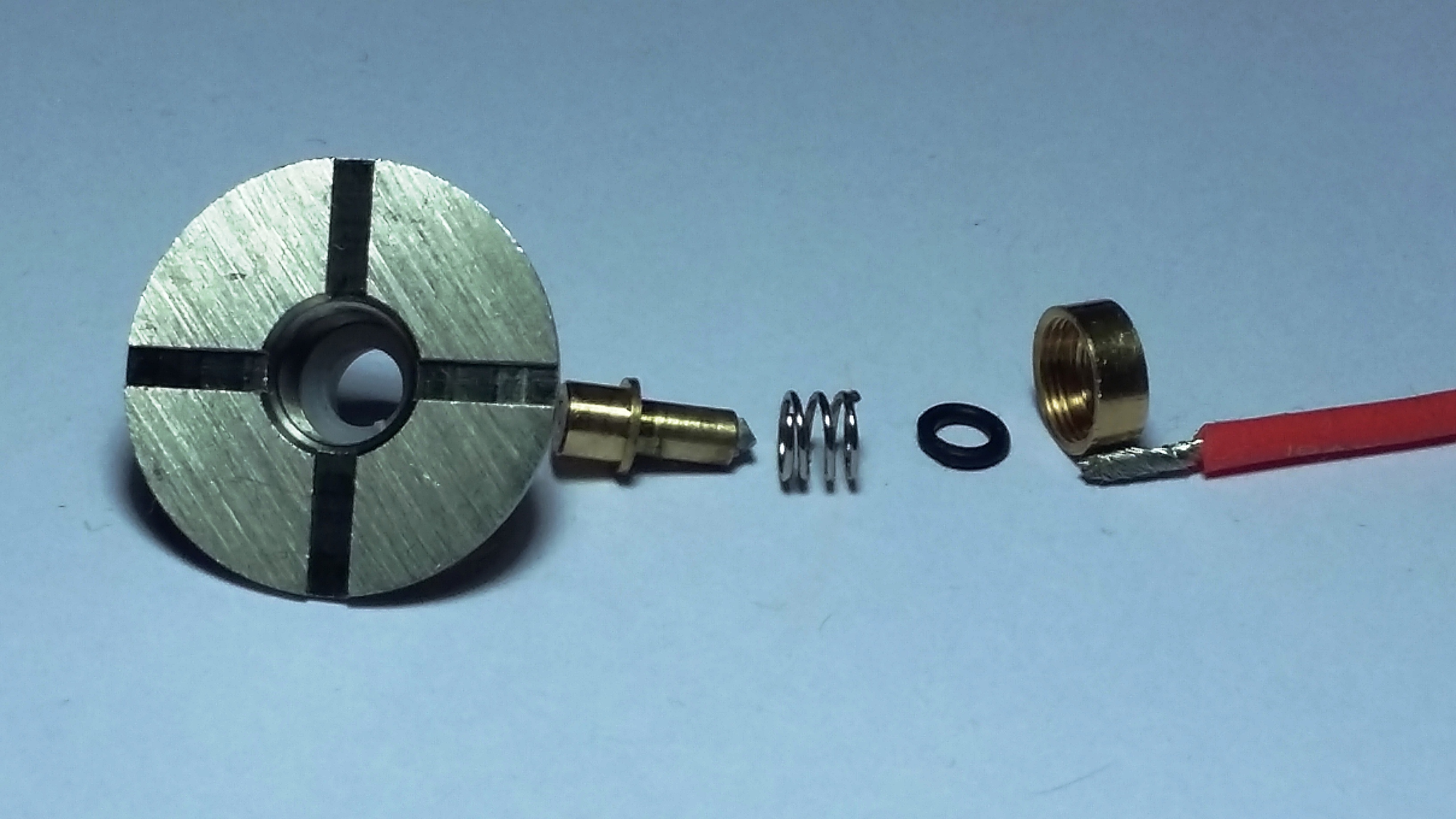

	sos, I didn't mean that one ,lol,, I mean is your mod(female) 510 spring loaded, not your atty (male), ,,,like, the spring in the mod is acting like a coil, because theres juice or debrie in there and its shorting and causing fauls readings, also a good solder connection needs to be nice and solid, plenty of contact, not all 510 springs are as robust as the one in the pic. also some mods get solderd to the screw on bottom cap, I think that could cause an issue , with a resistance reading. first pic is of the power out going to the centre pin, second pic is the power out going to the bottom cap, so possibly then the spring may get recognised as a coil, correct me if im wrong.
	Well if the op aint got it sorted by now, he'l have to get someone to drag the 510 spring out and find a heavier one..
