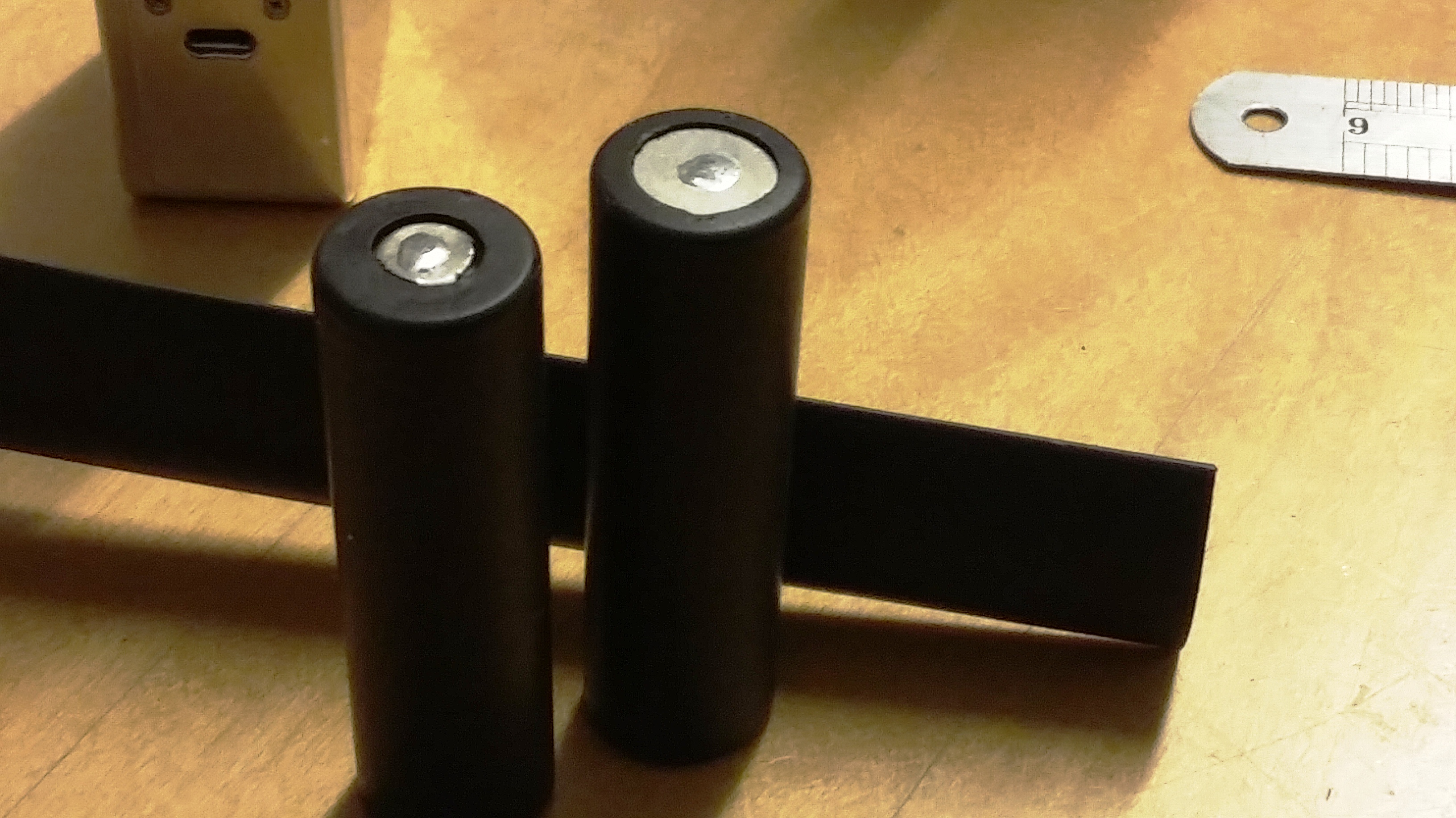

  12. no disrespect to Efest,,and god knows I've had some,,, But,,, the last ones I had,,, cheap,,, there are a lot of them about nowadays , to use in a mech mod,, I had to get the rust off the contacts and the wrap or skin was very thin and split, and just wasn't right compared to other ones I've had,, I resurrected some vtc4s from a twin parallel DNA 30 clone mod that had had several months heavy use and every night charging, I can tell you that those old batteries, just one on its own out performed the purple things, and they were supposed to be new... below is a shot of the two vtc4, with a blob of solder on each end to make a tight contact in a loose sled and re skinned with 20mm heat shrink, which is about .5mm thick, a lot thicker than standard for both the Sony and Efest
