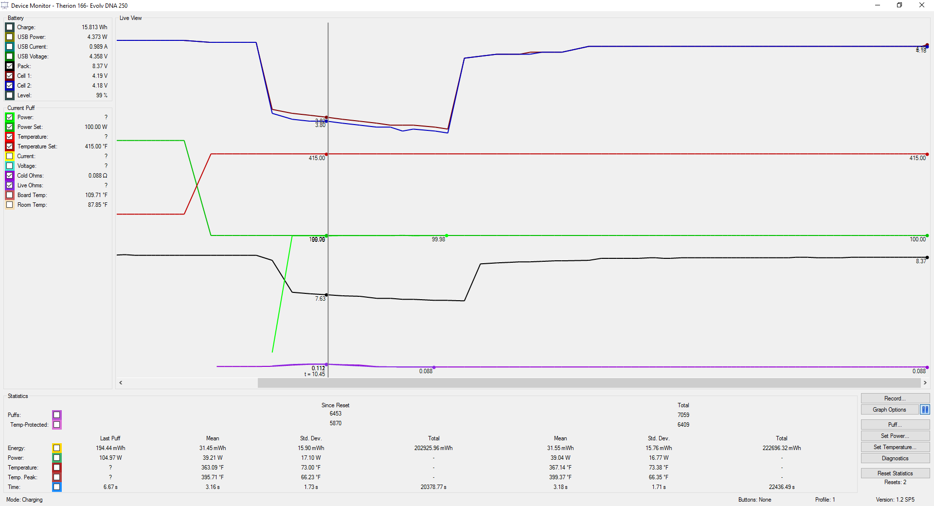

  10. On the left side of this screenshot is the previous 10 sec. puff using device monitor & on the right side is me pressing the fire button
  11. Here is new screenshot...10 sec. puff using the puff function in Device Monitor...not even touching the device & everything is looking normal again...haven't changed any settings.. .

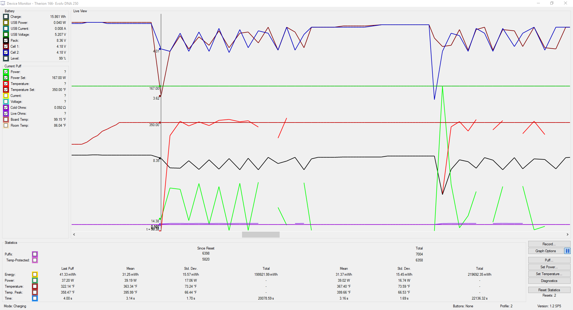

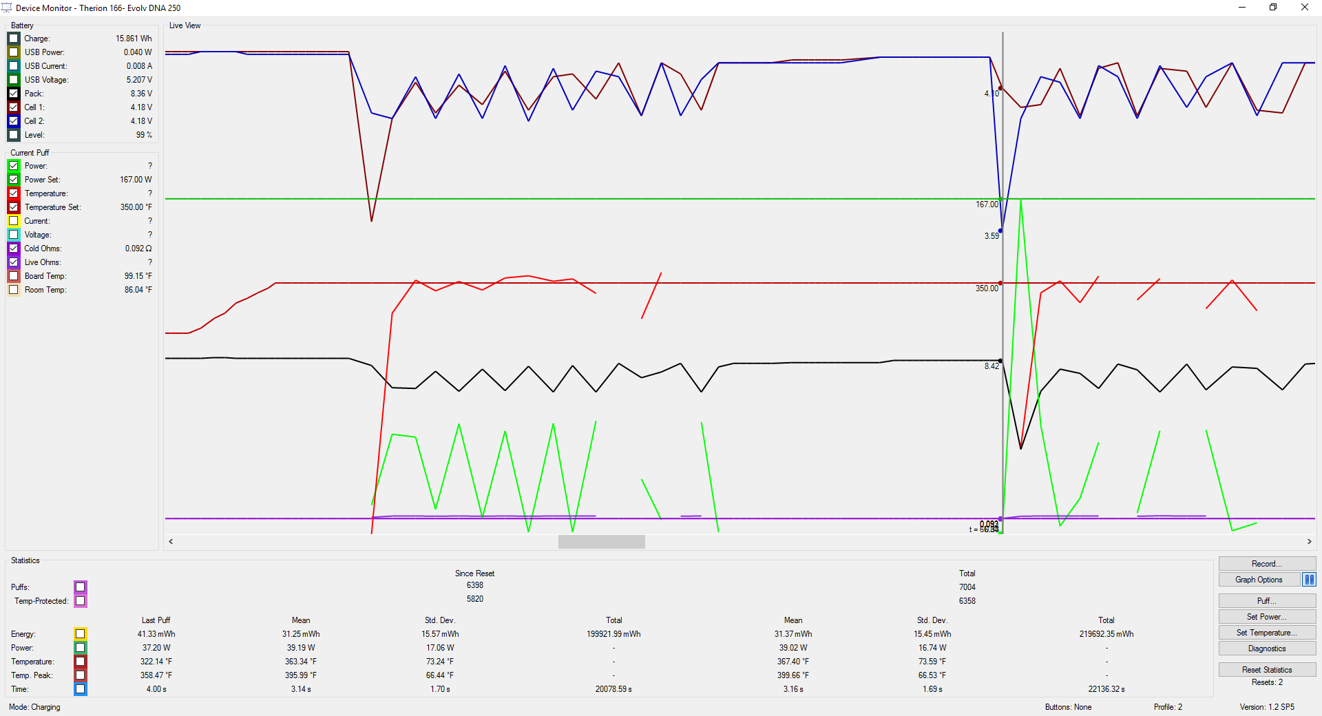

  12. ChunkyButt200...those 2 screenshots are of the sag when firing...2 different fires but they fit on the same screen so took 2 screenshots so that I could move the marker from one fire point to the other... Wayneo...haven't changed anything yet...but now the device is firing normally again...

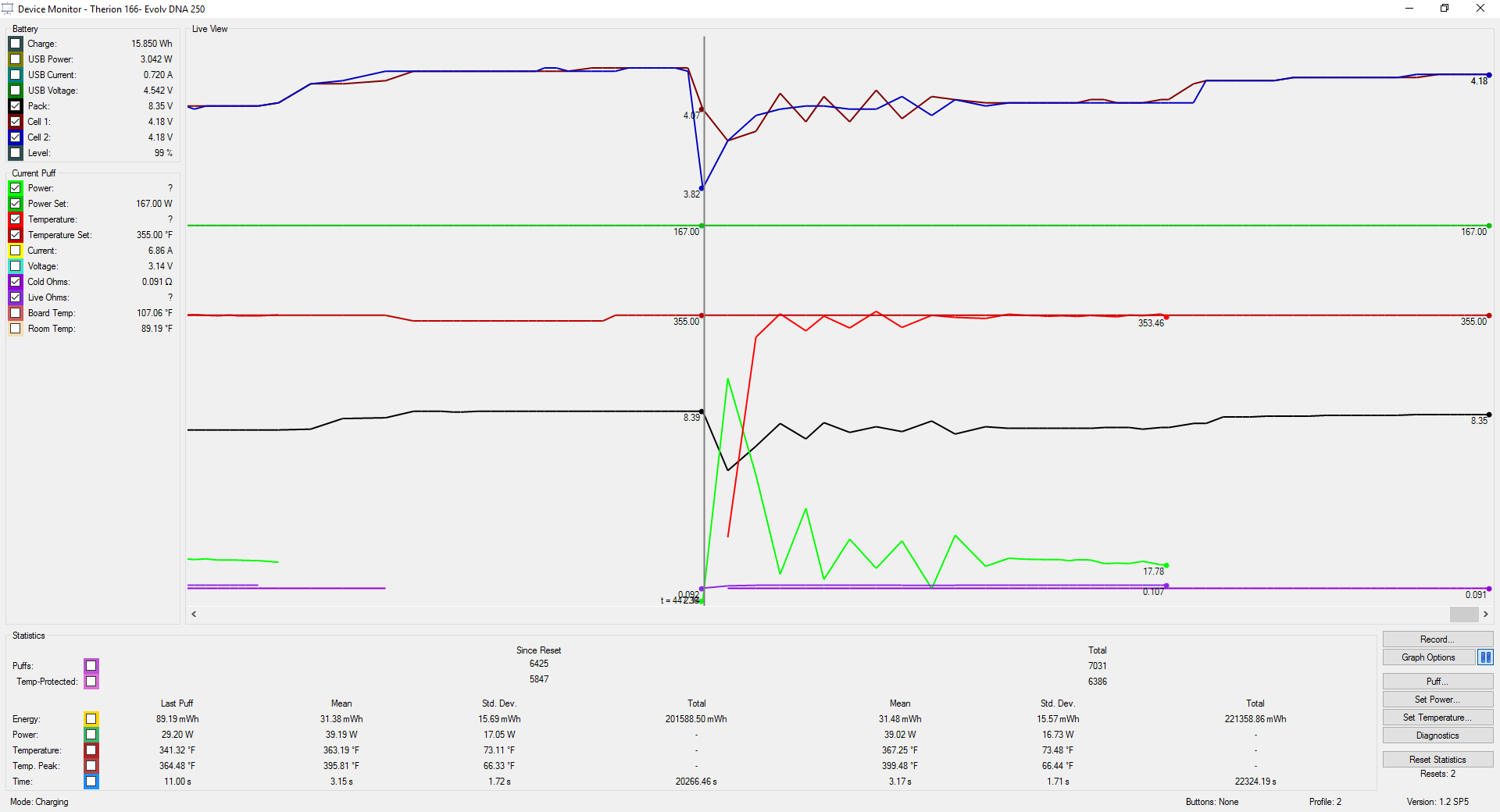

  14. Not sure about the Kanthal limit setting...never use power mode except to burn in coils...always use TC. Here are a couple of screen shots showing 2 different fire button presses but in the same frame...
  15. Cell cut off is set at 2.91...attached screen shot of mod settings. Changed out with fresh batteries...screen shot of device monitor after battery change out
