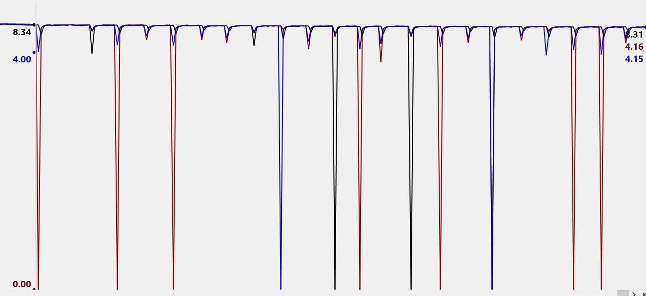

If you use escribe -> device monitor and click on cell 1, cell 2 and take a puff you'll see just how much sag there is. The board cutoff is 3.0v standing voltage (just sitting there) for each cell. That can drop below 3V during a puff down to the hard cutoff, which no one can change.

Ohhh, sometimes total voltage drops to 0, sometimes cell 1, sometimes cell 2 but only one at a time is ever at 0 but all of them can be non-0. First image is each an attempt to fire, the second image is one time it actually let me fire and I captured it.
